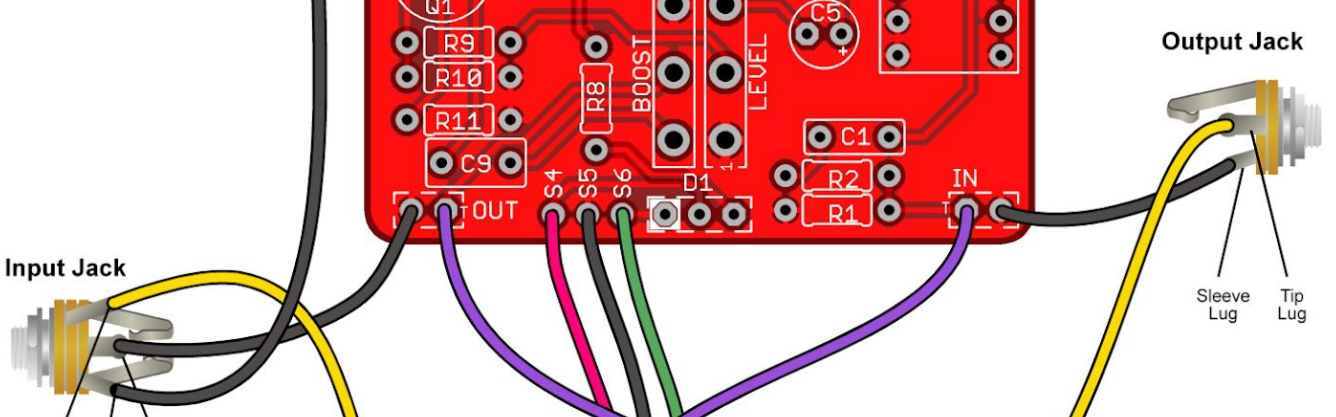

    Guitar FX Layouts have a pretty good build guide, as well as a guide to the offboard wiring (pots, jacks, footswitch etc).

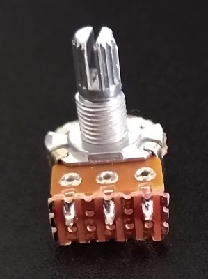

    They are handy for making adapters for PCB-mounted pots, allowing them to be used off the main board:
    Attachment 35941

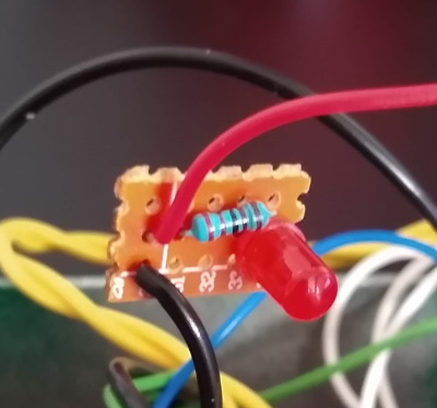

    Also handy for making little boards for the power indicator LED and current limiting resistor if you don't like wiring it point to point:
    Attachment 35942
