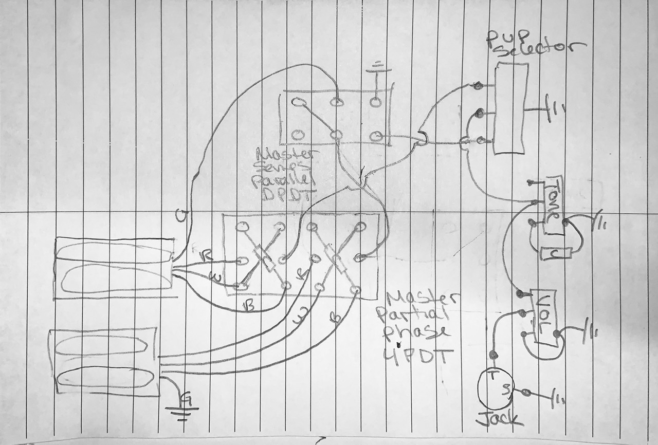

    Hi Everyone,
    I took a stab at my first wiring diagram. Sorry it’s messy. I took a diagram from Entwistle that shows partial phase of 1 humbucker on a DPDT switch. I combined 2 pups on a 4pdt switch, then figured a way to use DPDT for a master series/parallel switch.
    The idea is: in parallel mode, both pups in parallel (normal) the pup selector works as normal and you have choice of normal or partial phasing both pups. In series mode, both pups in series, choice of both partially phased or not, and the pup selector isn’t really used - assume I’d just be in the middle position since this has both pups active.
    Oh, wire colors are Entwistle, same as Seymour Duncan (Black +, Green -). Caps are .002uF on the phase switch, and .047uF on the tone pot. I don’t know which pup is bridge and neck, or if it matters . Any thoughts?
    Thank you!

    Nobody?? I’m about to start soldering but I’ll be starting from the input jack and working backwards

    It's not something I've ever done or looked into.
    I'm not sure that I'd ever be interested in straight humbuckers in series. The resulting huge inductance and DCR will give a very muddy result. So you'd need to thin them out first IMO, so the series + partial phase cancellation might give something useable. It's stuff that I wouldn't drill any holes for the switches for yet, I'd just wire it up and test it out. Maybe use some screw connectors so you can try out different capacitor values.

    I actually am thinking of going the other direction: the guitar is drilled for 4 pots. I will have to use shims or spacers or something for the switches. If it wasn’t such a thin veneer I’d plug the holes, sand them flush and re-drill but I don’t want to sand near the veneer.
    I know 4 push-pull knobs is an option but I don’t want 4 knobs - particularly multi volume and multi tone. I guess I could consider a tone trimming pot or two...

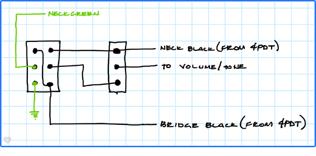

    I posted this same question on Seymour Duncan forum and got a suggestion to change the Master Series switch so that it disables the Pup Selector switch:
