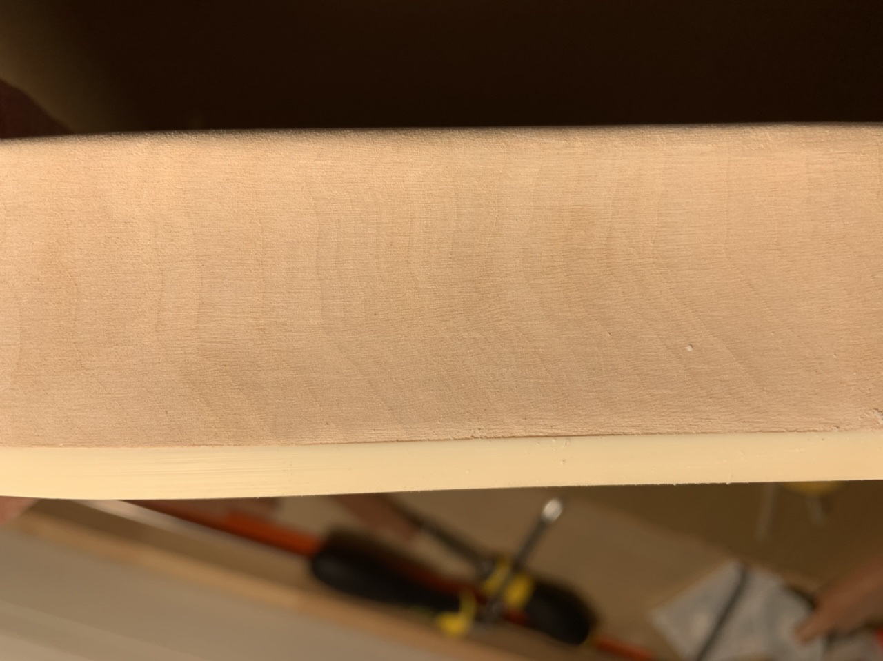

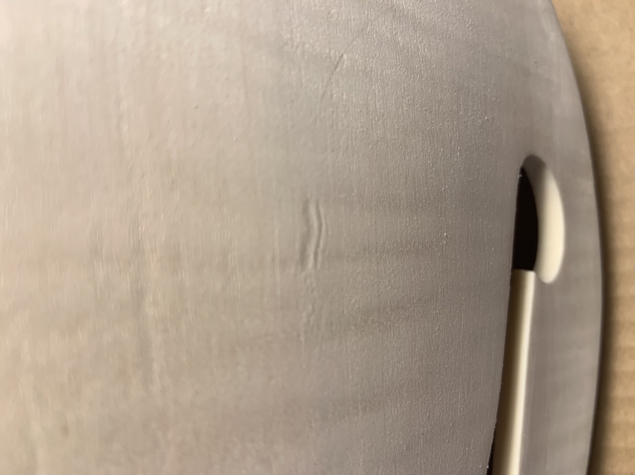

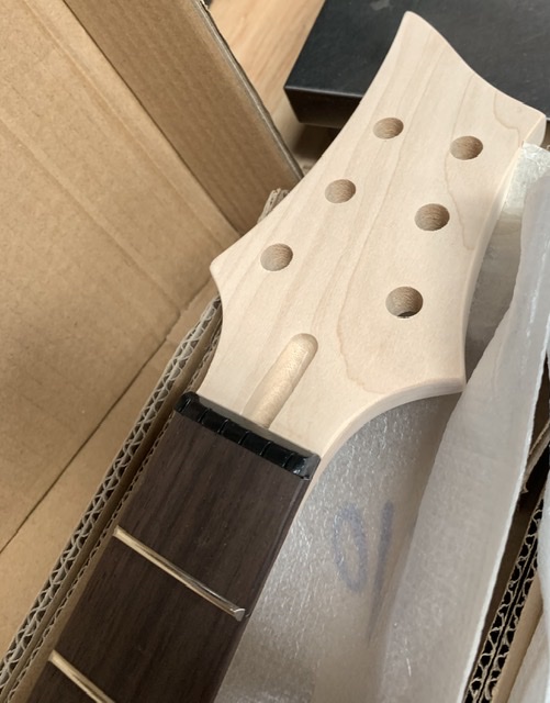

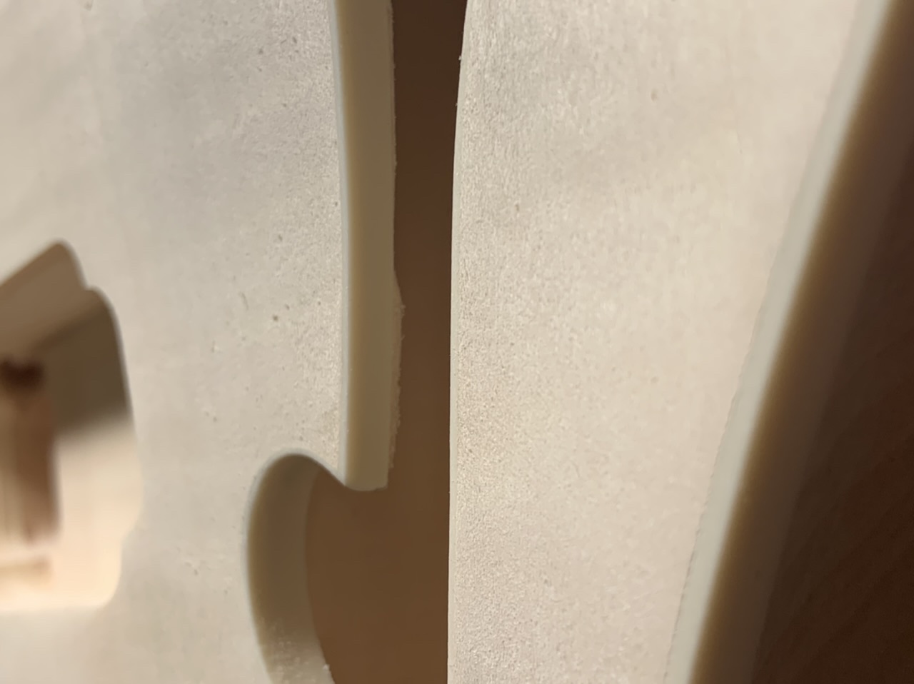

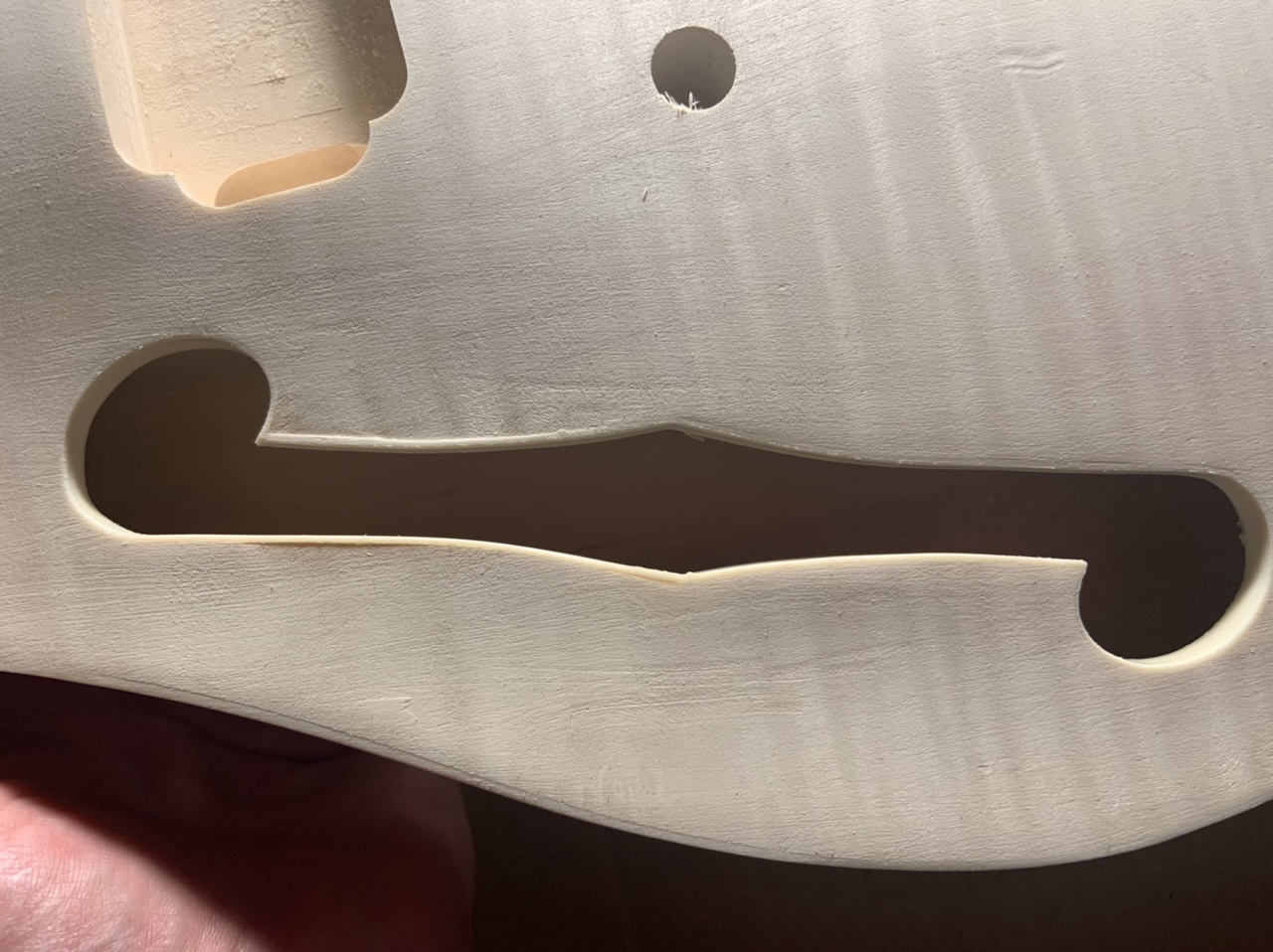

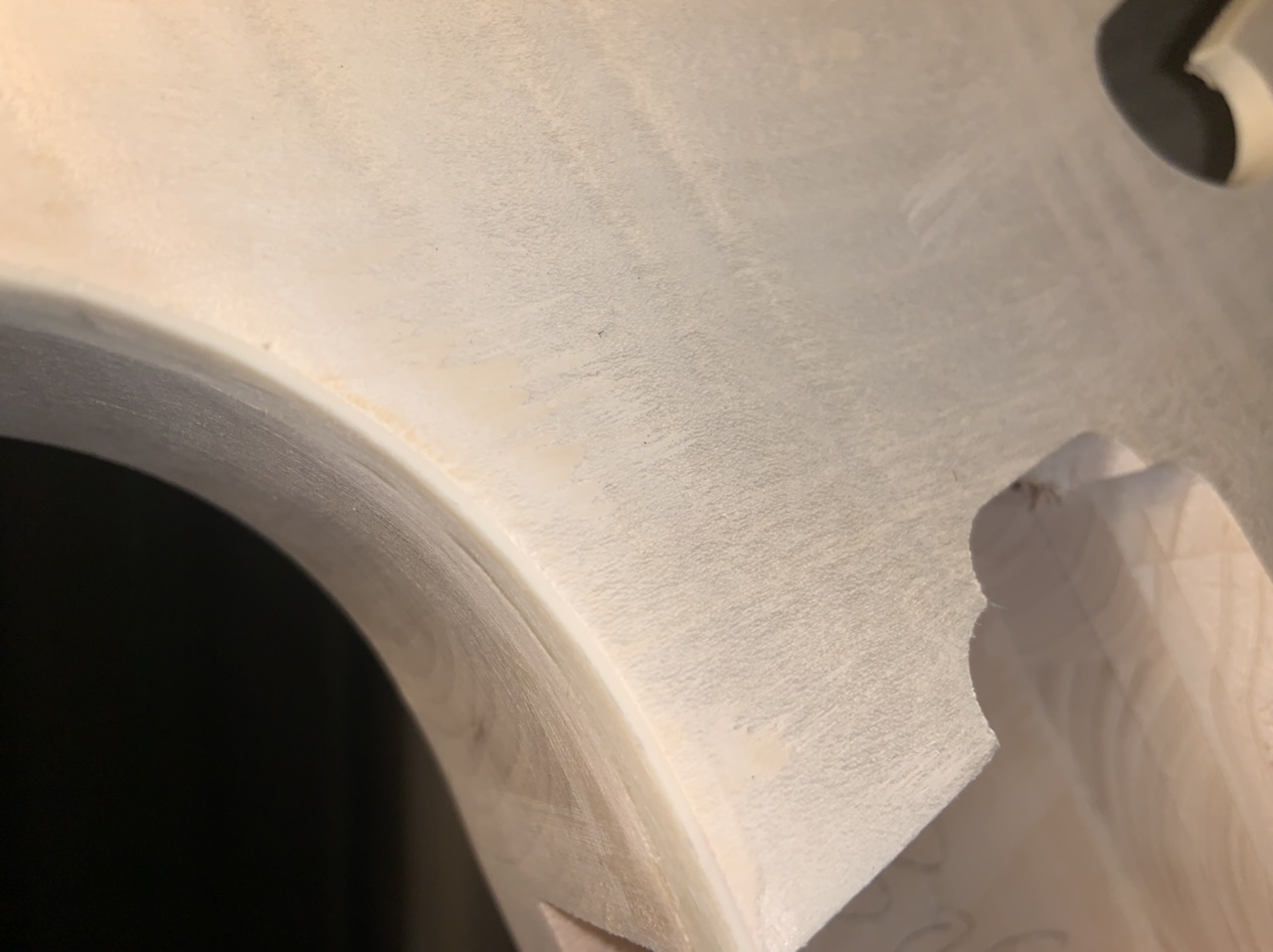

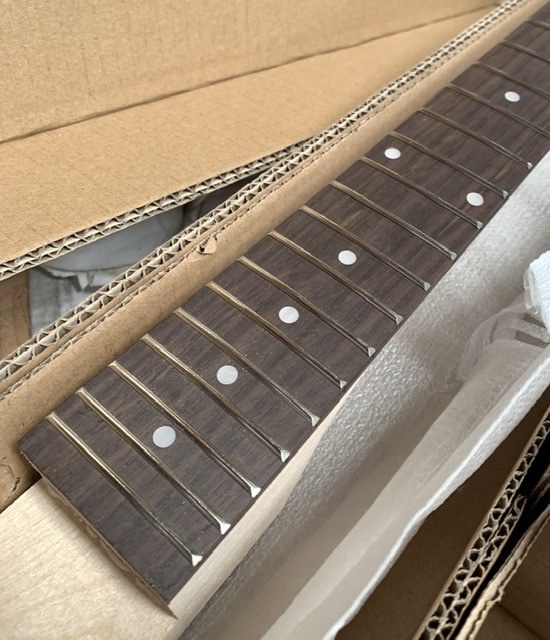

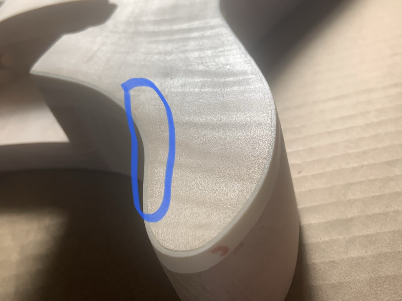

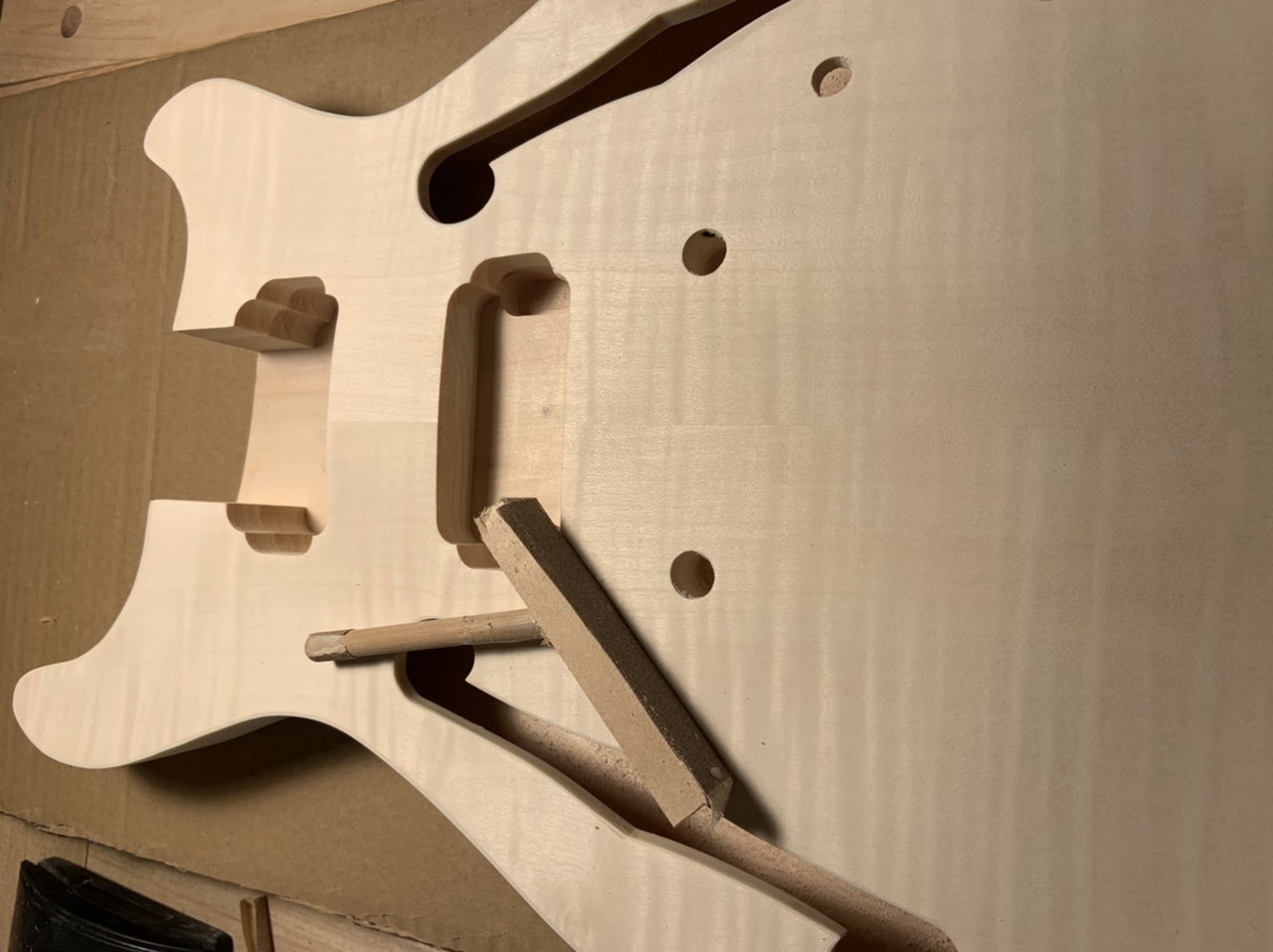

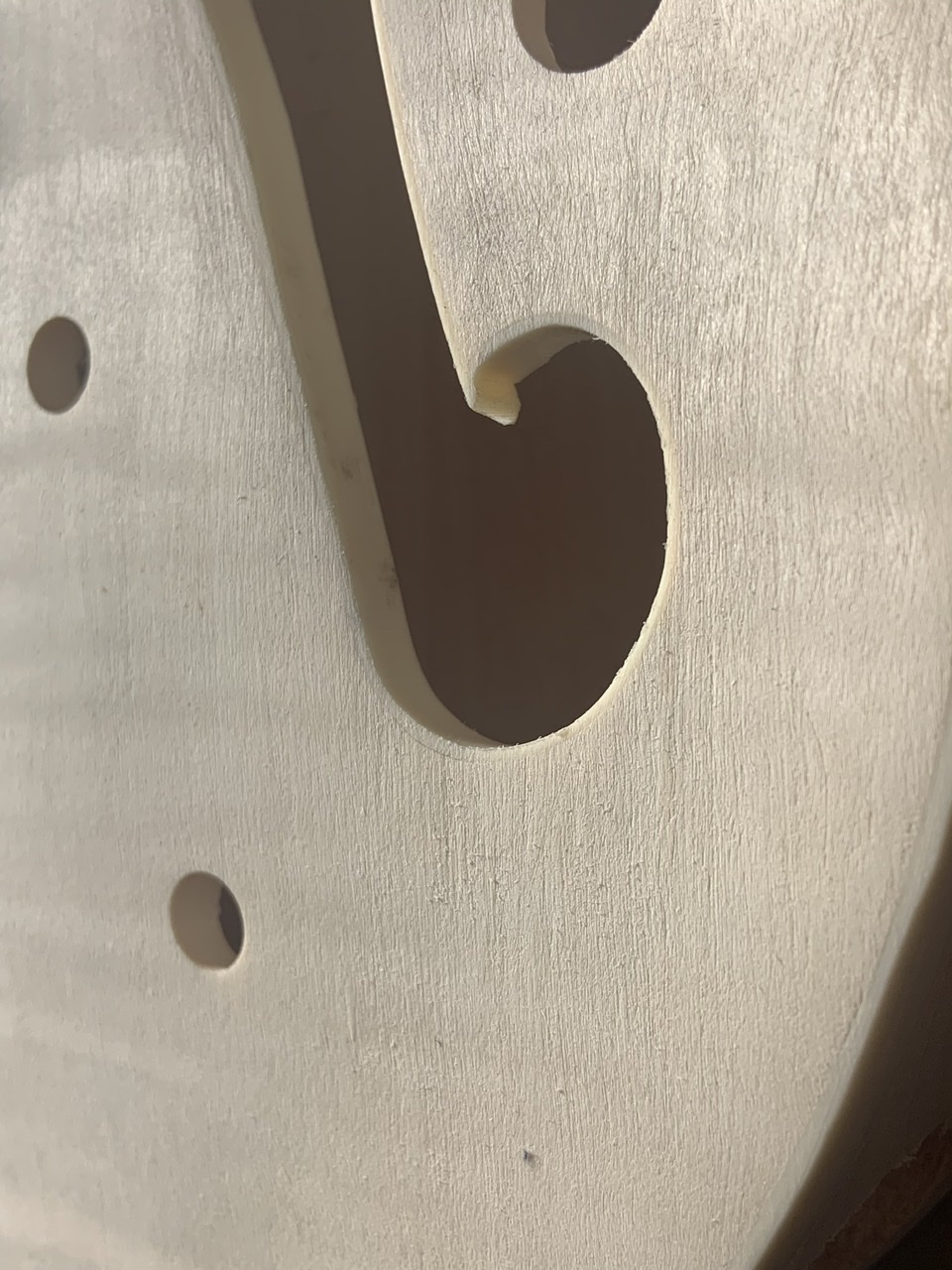

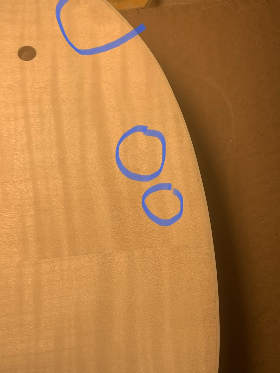

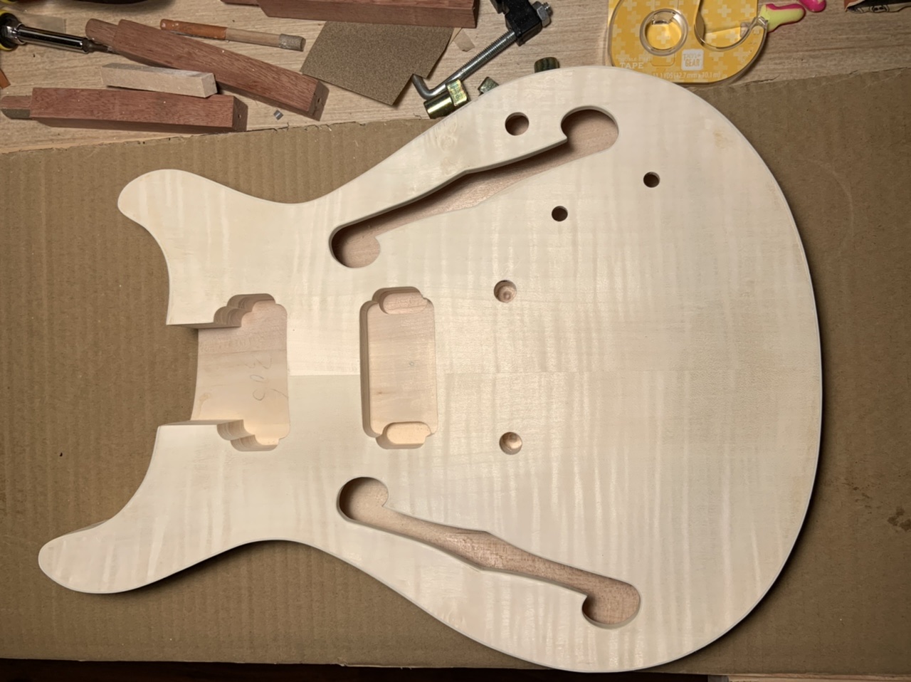

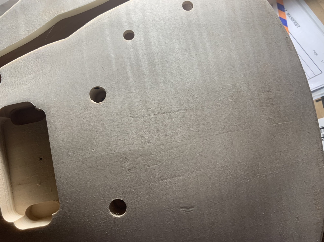

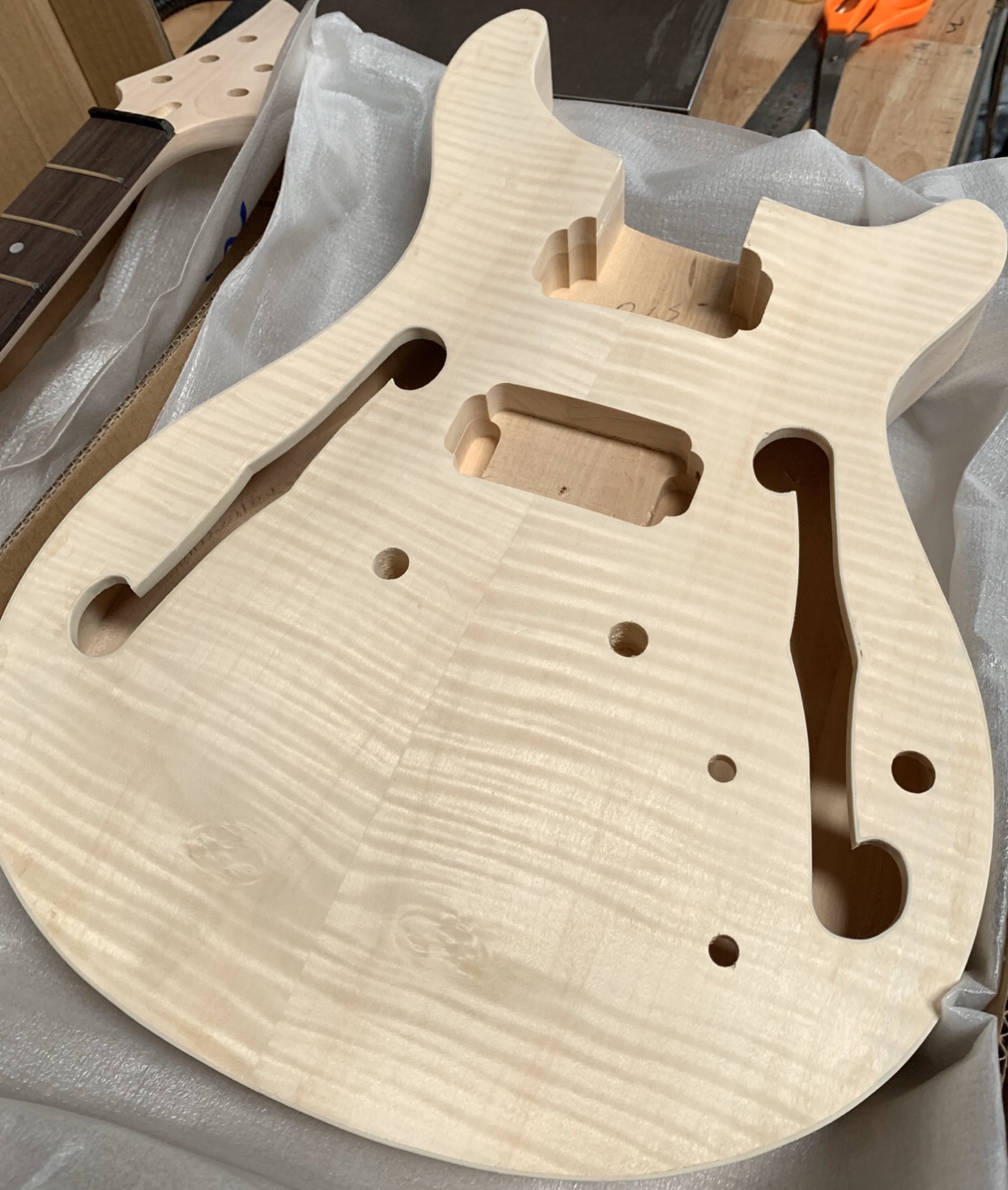

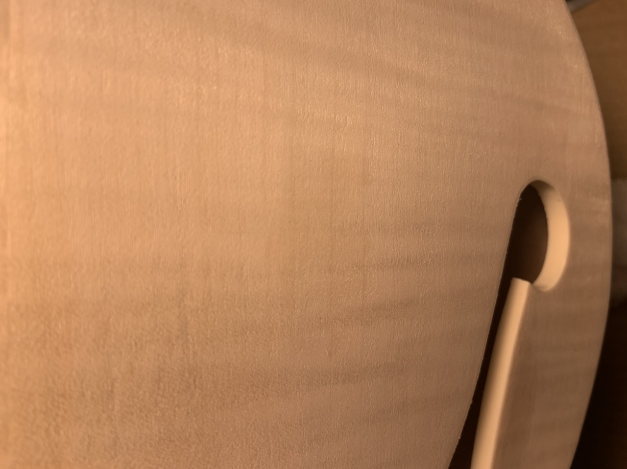

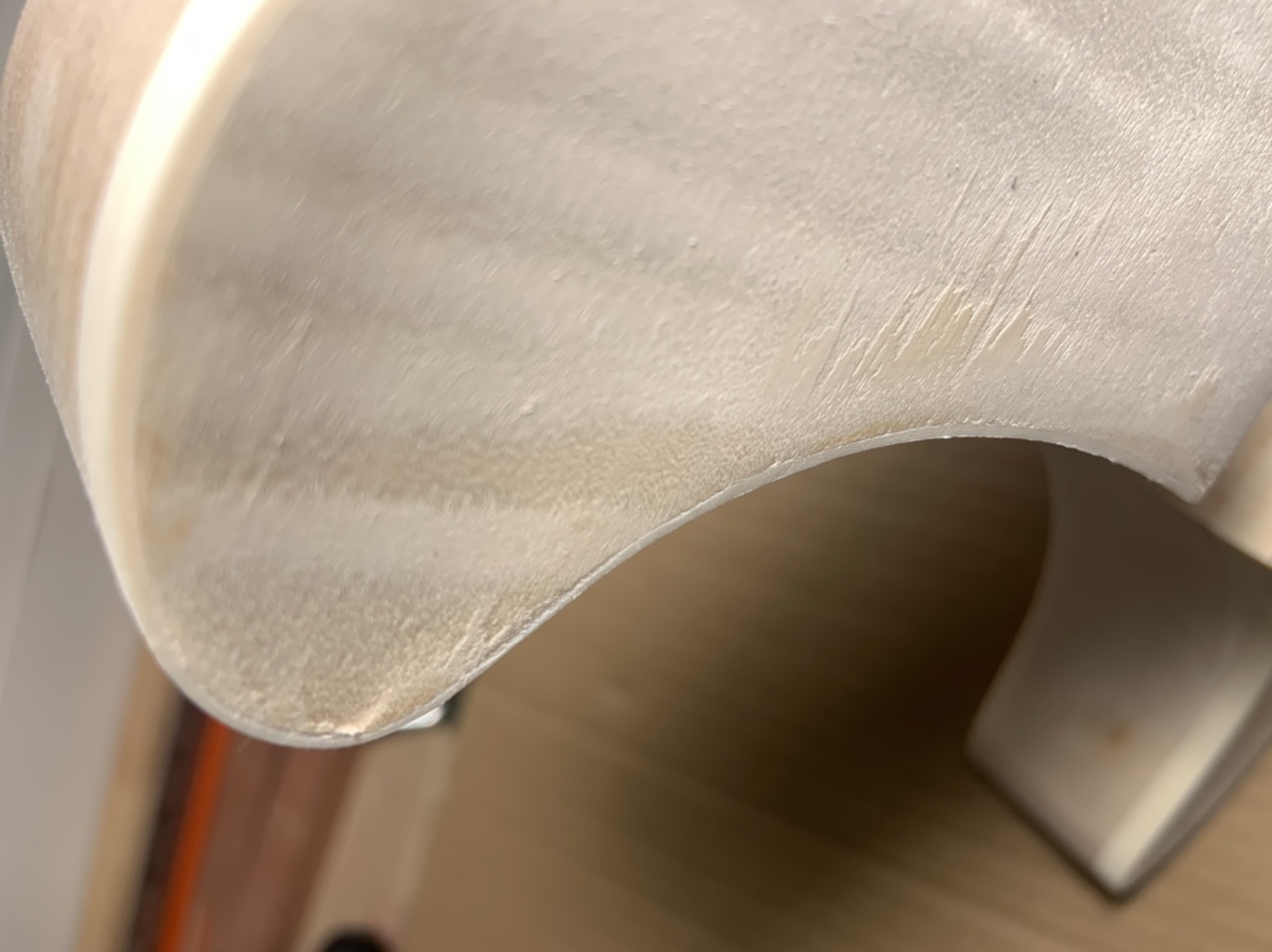

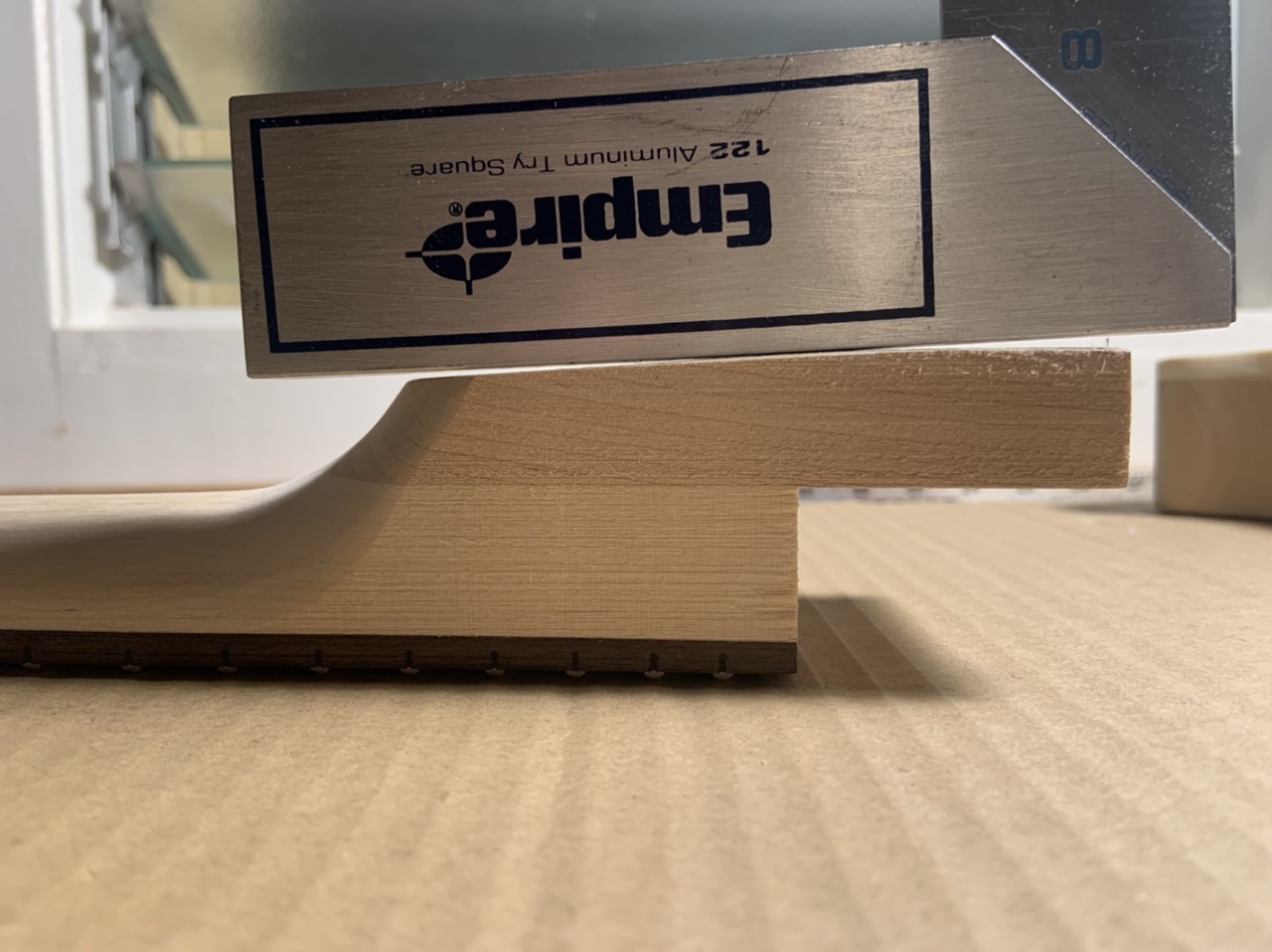

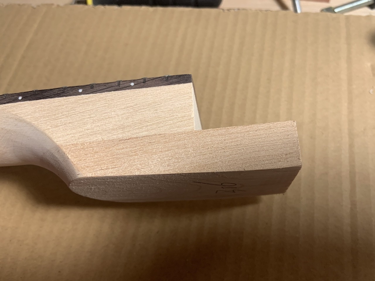

    I can’t believe I just got pics of my actual guitar!
    Edit: apparently there was some damage to the neck pocket, so the one sent is not the one I got pics of. I feel like I just found out someone switched my baby at the hospital, lol!

    Great looking kit. I'd just have a read through the other build diaries and ask specific questions as they arise.
    The two biggest challenges you will have are setting the neck and feeding the wiring into the body, but both are totally doable with some care and planning.
    The biggest word of warning on these would be that the veneer is very thin and shouldn't require anymore than a very, very light sand if any at all.
    What kind of finish are you thinking?

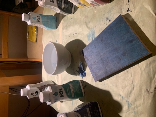

    Regarding finishing, I was going to wait until I saw the guitar, but now I have some pics I’m thinking maybe something like the pic below, maybe darker or solid on the back depending on the grain. But still I want to wait and see what blemishes need to be hidden before final decision.

    I watched a pretty cool video by PRS on finishing guitars. I”m sure it won’t be as easy as they make it look, but it gave me some good ideas for color and contrast (note they are using straight dye/concentrate):
    https://youtu.be/DzMF2SQxWPU
    I picked up a kit of Keda dyes. I’m a little weary since the price is so low, but I figure I can at least play with colors and layers on some scrap pieces of maple and see how it goes.
    https://www.kedadyeinc.com/our-dye-kits/
    I also watched a bunch of Lutherie videos on YouTube. I’m really excited for this - I think it’s just the kind of thing for me. I love fixing and building things, but particularly when there’s an art form involved. Trying to make imperfections disappear actually seems like a lot of fun!

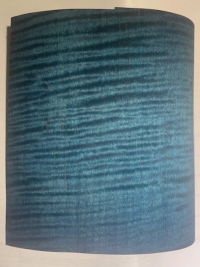

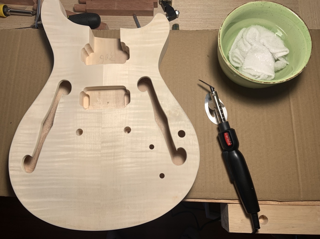

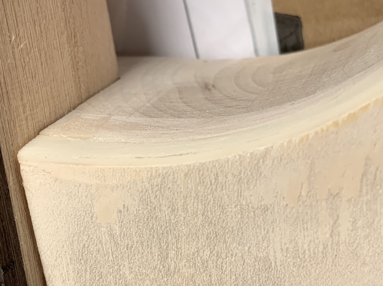

    I started playing around with stain. I homed in on a combination I liked, and when I got there I realized it’s really close to one of my favorite inspirations! I was actually even closer but decided to add a touch of yellow afterward for a little more greenish blue.

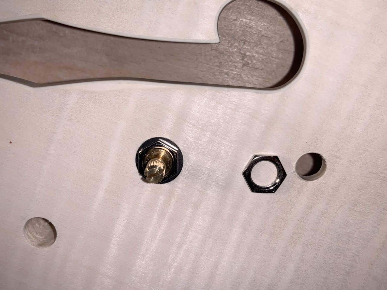

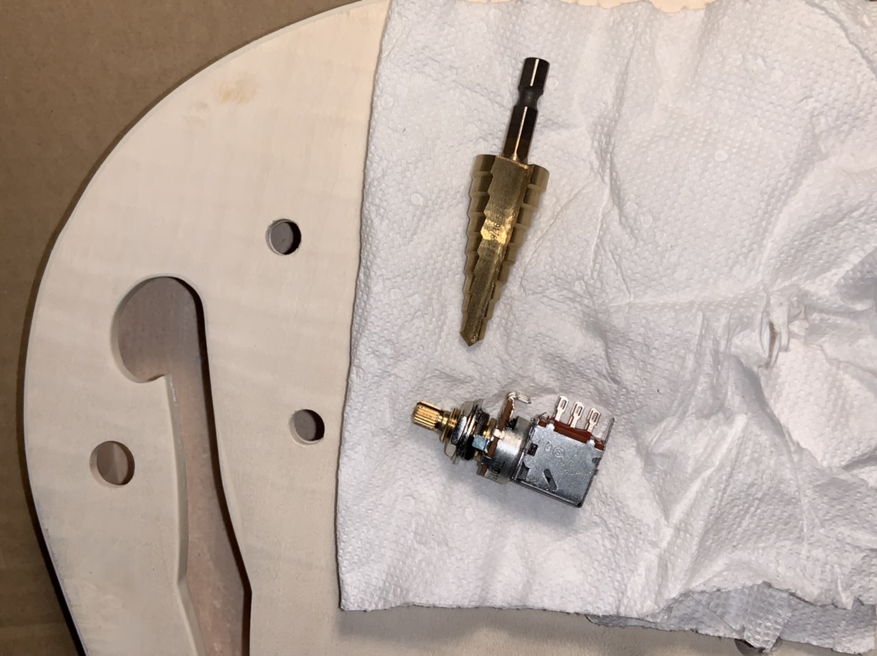

    I'd measure your body depth beneath the pot holes first before deciding on a definite wiring strategy. A typical push/pull pot with a decent length of mounting thread has 27mm deep body and 20mm of shaft. You'll need enough depth of body to slip the pots up inside the body and up through the holes. You will probably have enough depth for the two existing pot holes, but think about where you want the third to go.
    If you've got some digital calipers, then use the rod that sticks out the end of the calipers when you open them up to measure the depth available through the hole. But don't forget to take off the depth of the body (typically 5mm).
