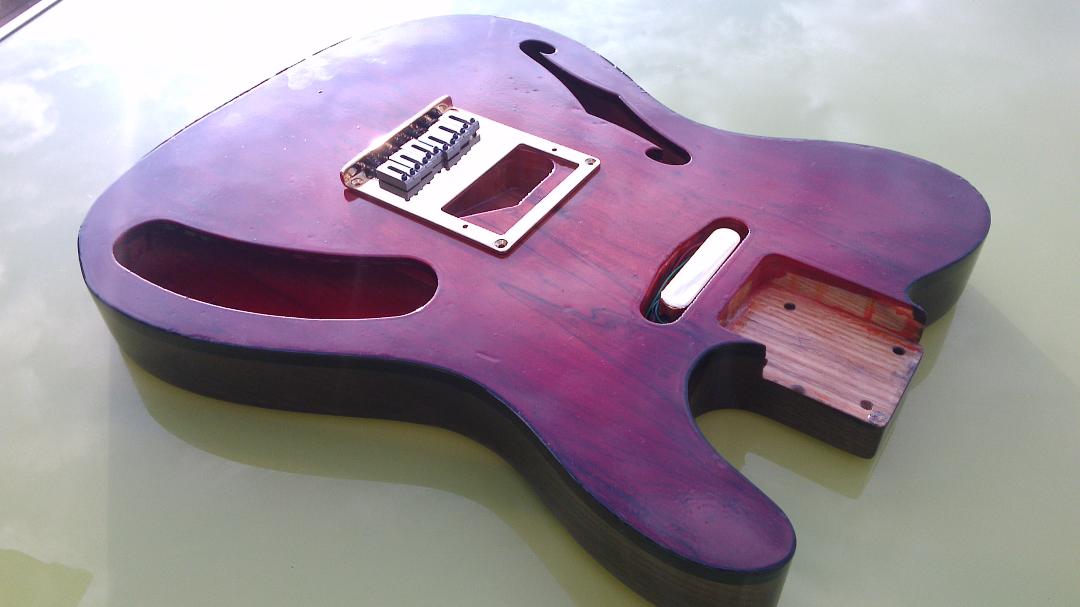

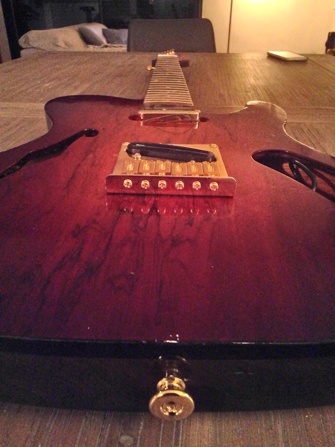

    i m just started my first kit
    lot of work bur realy enthusiast
    my firt work was sanding and epoxy coloured resin on the body and then candy varnish and sanding of cousre

    Hi gonz,
    Like the colour, what does the back look like ?
    Your guitar looks similar to the one that I am building (see my build log) so am interested in hearing
    how you approach your build.
    Which model do you have ?
    Regards, Fatboy.
    Nov 2019
    FRANCE
    18
    hi fatboy
    this is the ATL-1SB
    after grinding with a 240 and 380 sand paper a resin epoxy was aplyed in 2 coat espaced of 1 hours and then another sand paper 380 and coloured varnish and translucid varnish in the end different colour on each varnish coat
    important thing that the epoxy is a good coat sealing

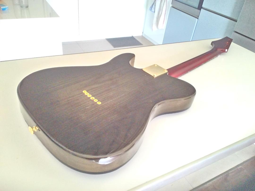

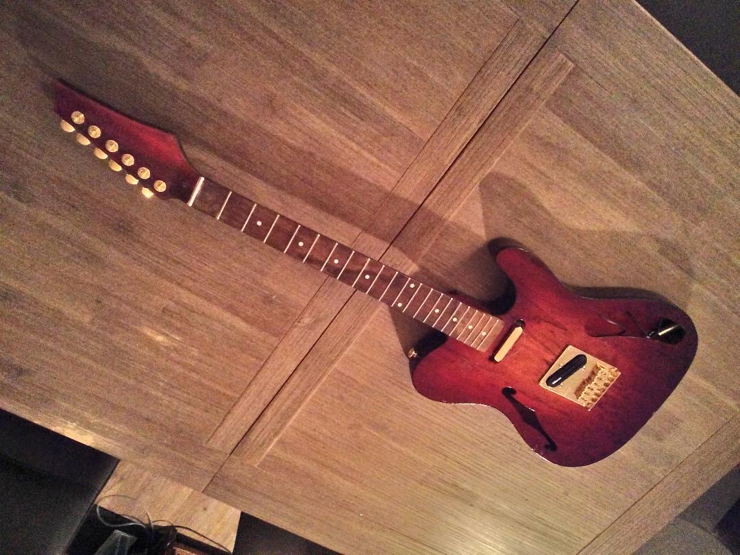

    neck and assembly before finish sanding Click image for larger version.
    Nov 2019
    FRANCE
    18

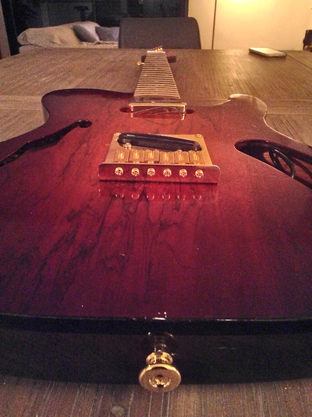

    mode candy varnish

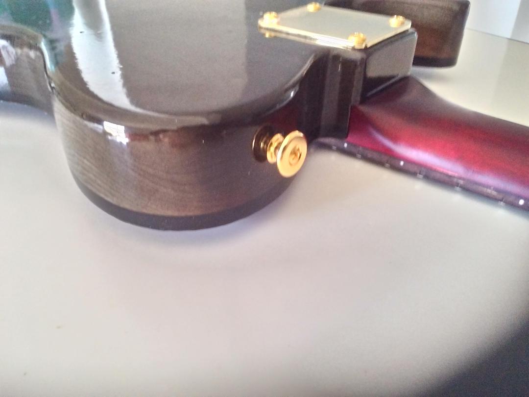

    the back Click image for larger version.
ID:	33347Click image for larger version.
ID:	33348Click image for larger version.
    Looking good so far. nice job with the string through!

    Awesome work Gonz! Did you use pigment in the resin, if yes, what type? Ps. How do you try to keep off the yellowing effect in the future?

    Hello Rolf my approach is to use epoxy resin at the first pore layer
    first coat epoxy resin UV traitment (surf clear or other without pigment
    second coat after one hours same resin with pigment (pigment for resin only)
    in 3 another layer after 1h without pigment and not a thin coat because you ll sand
    this 3 layer of resin give you a really nice deap effect and then after sanding with 320 paper and 380 you can apply the PU varnish also for an UV barrier

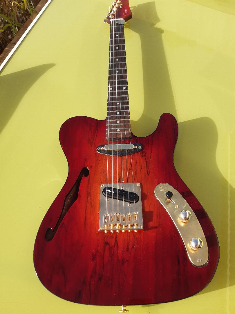

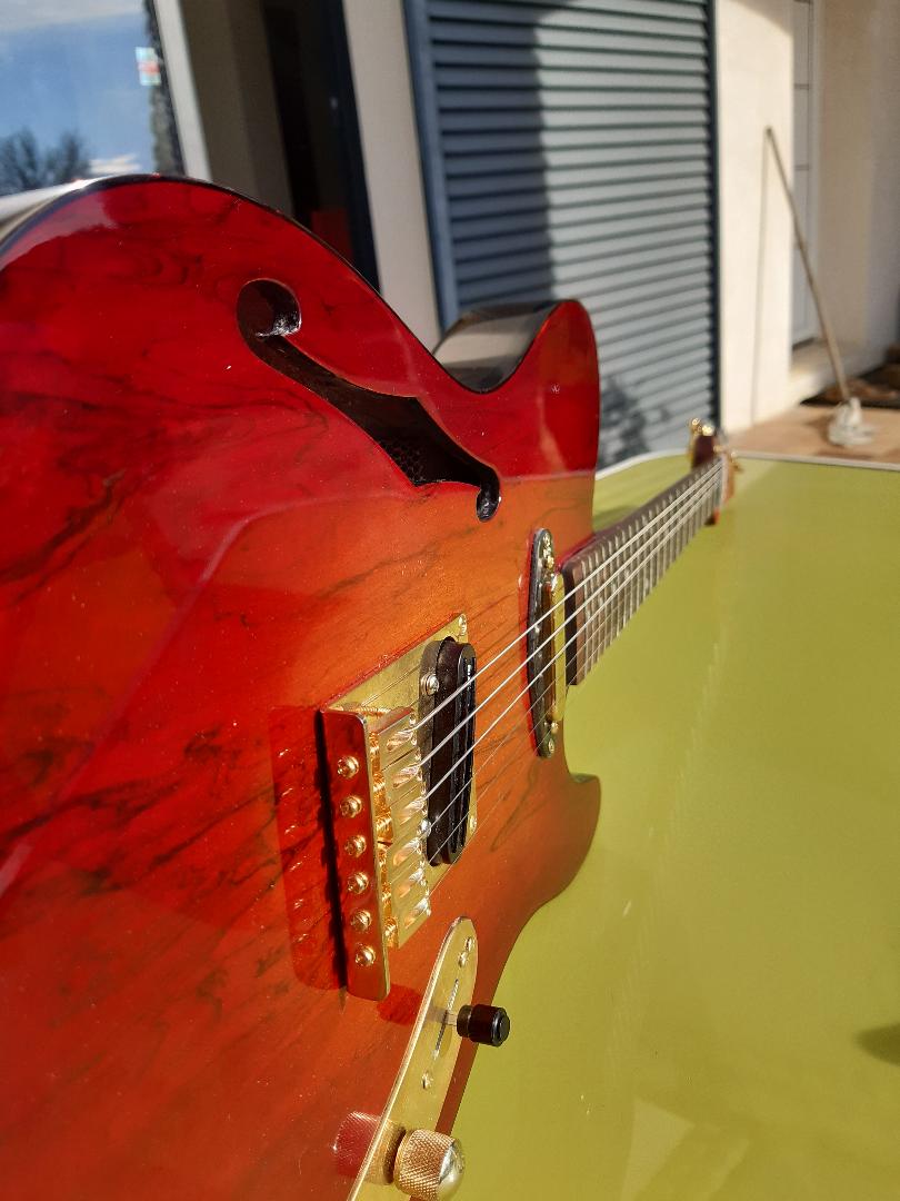

    almost ready to playClick image for larger version.
