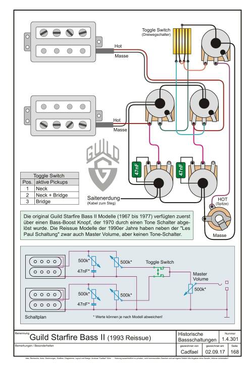

    This should work. Doesn't have the split for the humbucker but otherwise right.
    The split would be easy to add if you want it.Click image for larger version.

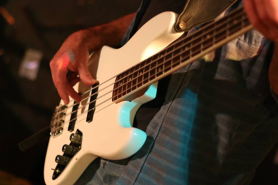

    I have my Go To Bass, a 1966 Jazz, with rewired pups by Lindy Fralin. Volume, Bass and a Tone knob. A Three Way Switch that I keep in middle position, either other option gets noisy. Very happy with the sound. The neck is to KILL for, worn beautifully. Mine has been altered from original as it has a pro-type preamp, no one knows it's origin, PASSIVE Pups, with a battery, but functions Great! I bought it in the Early 80's knowing it's alterations. Those changes leave Gruen Guitars here in Nashville assess it's value in regard as Subpar and cast it off. I get SO much volume, if I choose, SO much treble if I tune it in, it will cut your head off! I have to cut the treble back when using a pick, but will just jump with fingers! I get many compliments. LOVE this bass! But she is old, and I'd hate to have it nicked, as it has before. I got it back!!! But considering retirement for the Ol' Gal! This bass LOVES to be played!

    Fender3X,
    I like this schematic, I'd place the Master to the back/bottom of the pickguard, but very understandable. Thank you.
    I can use this!
    Do you think a Push/Pull Volume pot as a Coil Tap/ Master Volume be an option? In my configuration?

    2,745
    Quote Originally Posted by OctoberBassRCA-4 View Post
    Glad you found the wiring plan helpful ;-)
    You can put the push-pull switch on any of the pots but it will be easiest to put it on the bridge pup's volume pot because that's where the hot lead from the pup is going anyway. I would find it most intuitive.
    It's really simple to wire the push pull. Normally these switches have 6 lugs, 3 on each side. You will only use two lugs on one side (doesn't matter which side).
    Find the two leads from the pickup that are soldered together. Solder these to one of the top lugs (lug closest to the pot). Both leads get soldered to this lug--you don't need to unsolder them. Solder a ground wire to the middle lug on the same side. That's it!
    With the switch "down" the pup will function as a normal humbucker. With the switch "up" you will only be using the north coil.

    That Guild circuit looks useful. Unlike Jazz bass wiring it looks to me as if the volume controls affect both pickups with the switch in the middle. If that's the case I think I would be tempted to change that.
    A question I'd like to pose is whether the tone pots ought to have different value capacitors for the single coil and the humbucker. I'm pretty much ignorant on tone controls, I don't have an informed opinion.
