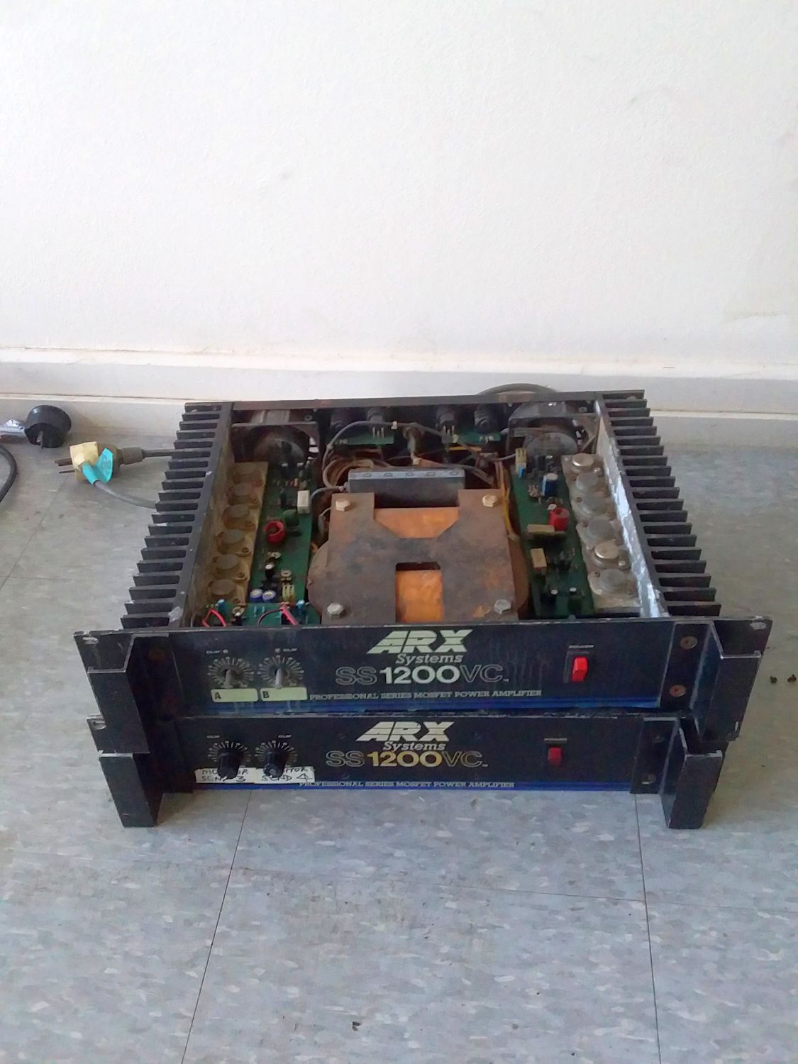

Name:	ARX ss1200VC_resized.jpg
    A pic of the two ARX amps..

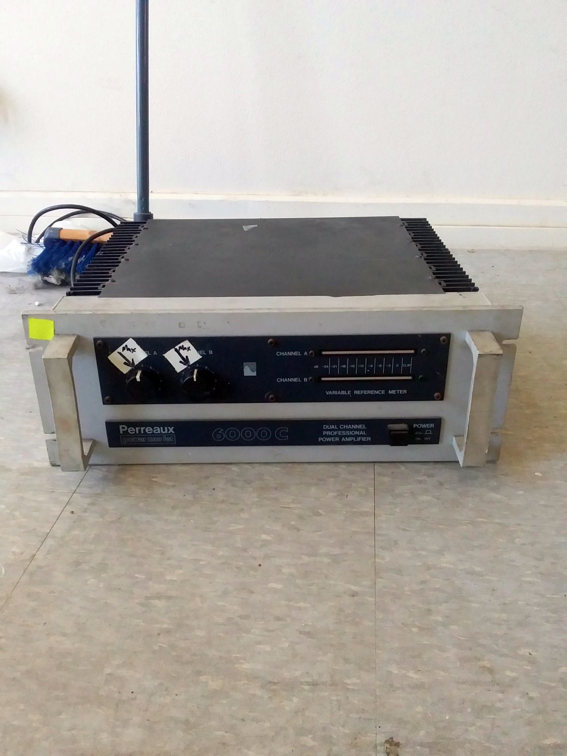

Name:	Perreaux 6000C_resized.jpg
    A pic of one of the Perreaux amps.

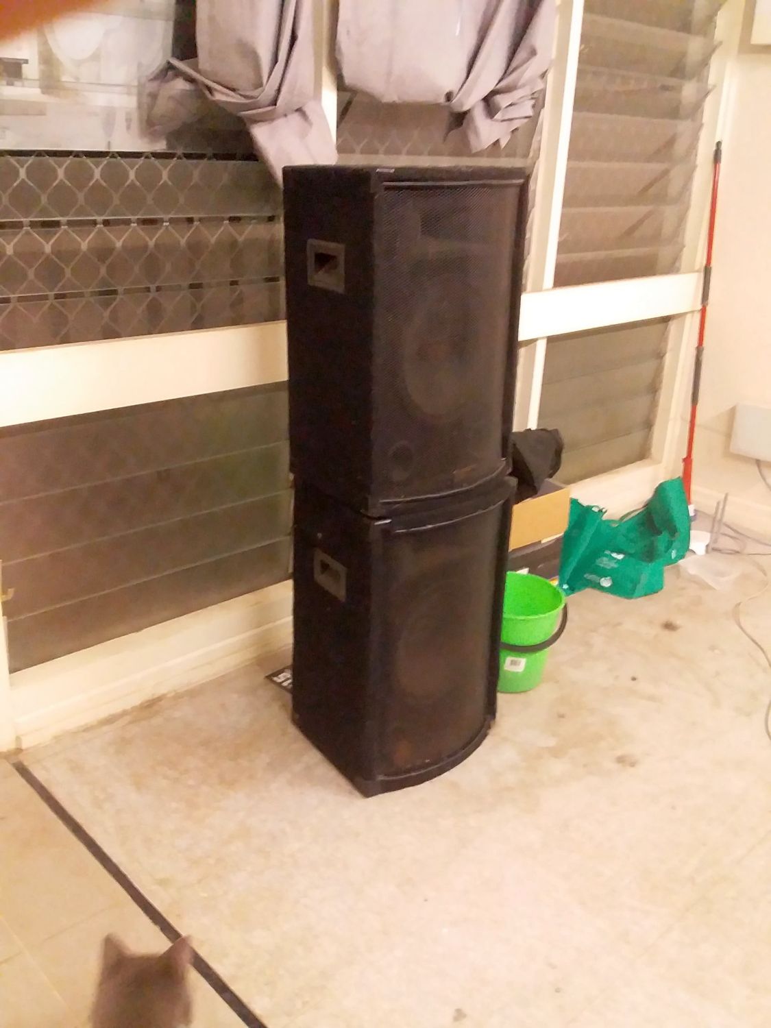

Name:	300 Watt PA Speakers_resized.jpg
    The two 8 Ohm 400 Watt Precision Audio PA speakers stacked one on top of the other.

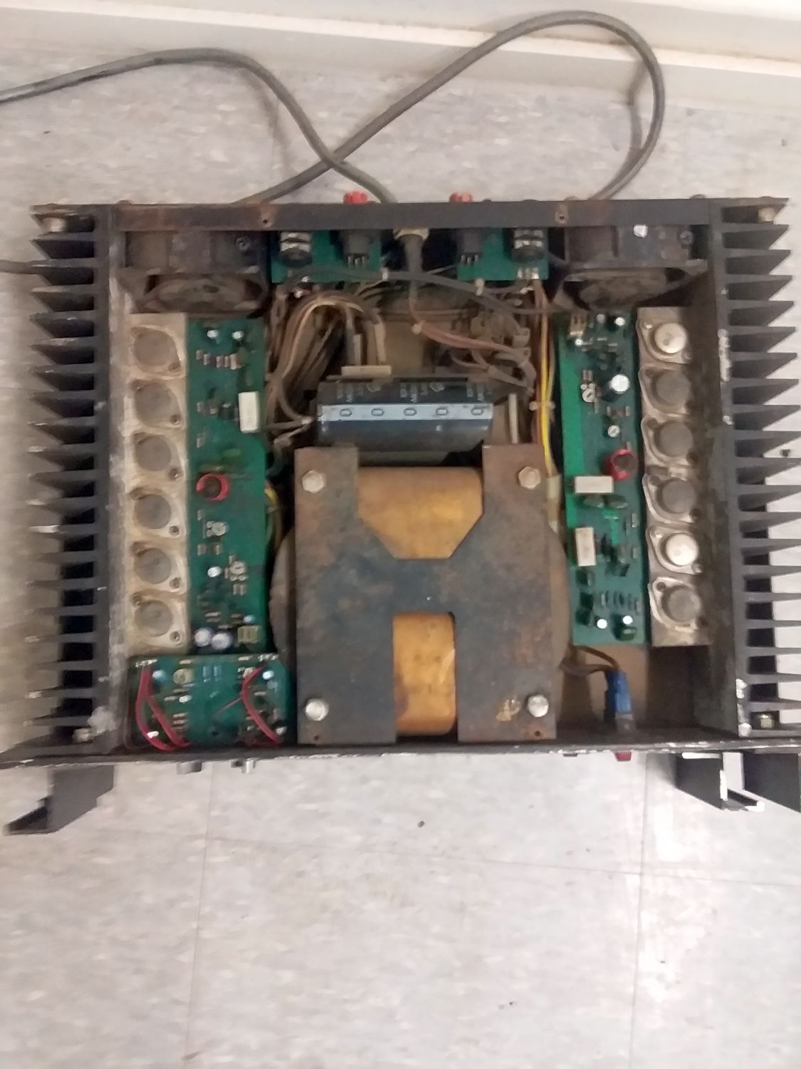

    Here's a pic of the insides of one of the ARX SS1200VC Power Mosfet amps:
Name:	ARX Internal_resized.jpg
    If you look at the lower left-hand corner of the ARX amp, you'll notice a small circuit board, this board has the two amp volume control pots soldered directly to it, I am very strongly suspecting that a broken circuit-board track on the underside of the board is responsible for the amp not working, it powers up but no sound comes out no matter where you set the volume controls.
    And yes, that huge hulking great piece of iron in the middle is the power transformer....no guesses as to why the amp is so heavy.

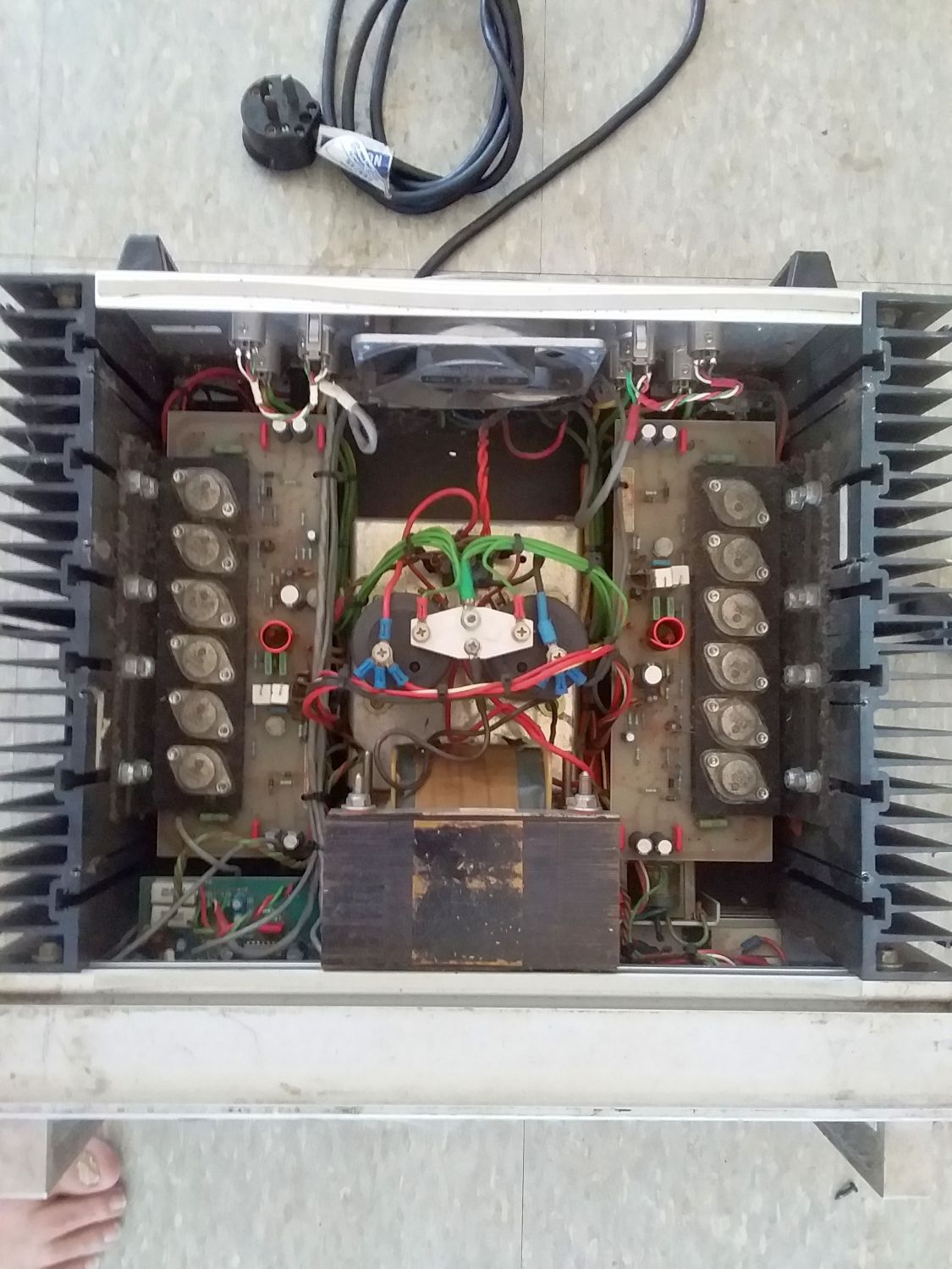

    And here's a pic of the insides of one of the Perreaux 6000C power Mosfet amps, spot the huge power transformer:
Name:	Perreaux Internal_resized.jpg
