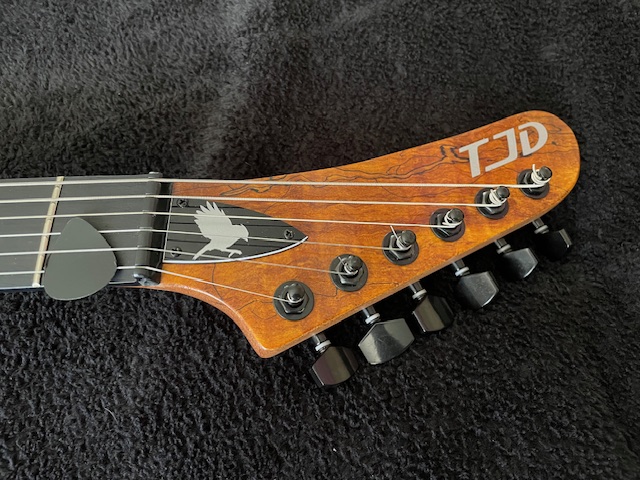

    Final pictures:
    The pickup is a Tonerider AC2B zebra.
ID:	45357   Click image for larger version.
ID:	45358   Click image for larger version.
ID:	45359   Click image for larger version.

    Wicked! Only the sound demo to follow 😉
  8. #87
    3,084
    Really impressive! Love the burst! Also cool to see the chickenheads. Hope it's as fun to play as it is to look at!

    Yes, chicken heads are really quite practical, especially in dark lighting.
  10. #89
    3,084
    My builds tend to look best in low lighting. Fits nicely with the OEM aesthetic, with just enough difference to be original ;-)
  11. #90
    2,025
    Thank you DarkMark and fender3x.
    Yes, the chicken heads work with the MBM. I like the fact that they signify a different sound function!
    It seems very nice to play. The action is quite low.
    I may struggle a bit without having the fretboard inlay markers! So, at a later date that may need to change.
    I have also added a set of Grover tuners.
