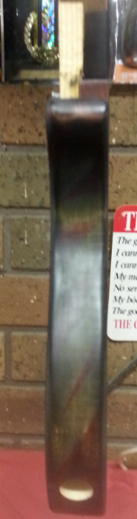

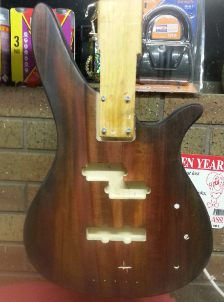

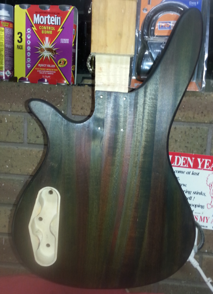

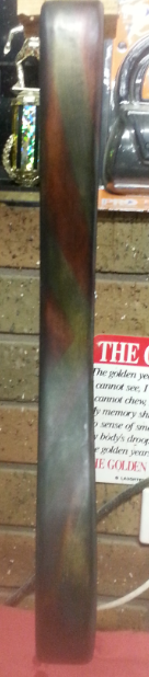

    Another update. Hopefully the camera is better this time but here goes:

    Hope that works.
    Alkay.

    Looks great! How'd you get the striping effect on the back? Was it a whole lot of meticulous staining along the grain lines? Whatever it was, it looks amazing.

    Hi G-Axe,
    Cheers for the feedback. I followed the natural grain using the blue masking tape and alternating the red and yellow colours. Once that was touch dry I then did the black burst effect with two mixtures of standard black stamp ink. One with less water added to darken the perimiter and the other mix had more water to slightly darken the inner part of the back. Can't really remember the ratio to be honest I just kept mixing and testing it on pine until I thought they both looked ok. I don't have a spray gun attachment on my airbrush yet like what Simon from the UK uses so I just made do with using a rolled up paper towel into a ball and a lint free white cloth to do all the wipe on staining. I hope that helps.

    It has a few issues but so far it's one of my better builds. I did want to do a dark brown as Simon suggested but I did a test run on some pine and I wasn't happy with the look of it. I also wanted to use up the left over colours I had so that's why I did that striping effect on the side of the body too(not sure if it's visible in the above photos).
    I did one coat of poly on the body last night and just about to do another. I'll post some photo's soon after a few more coats before I do any wet sanding.
