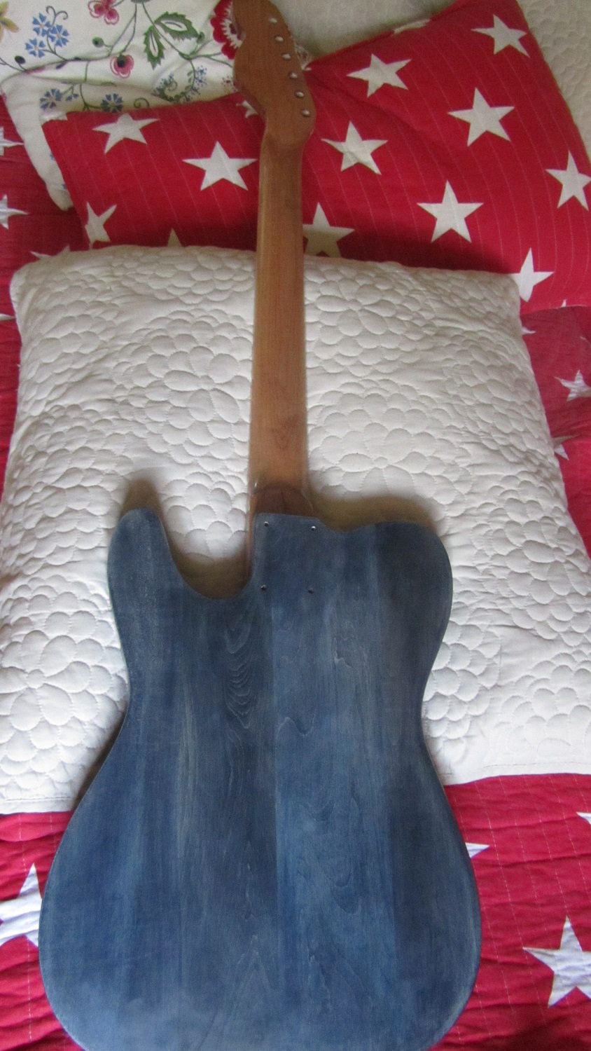

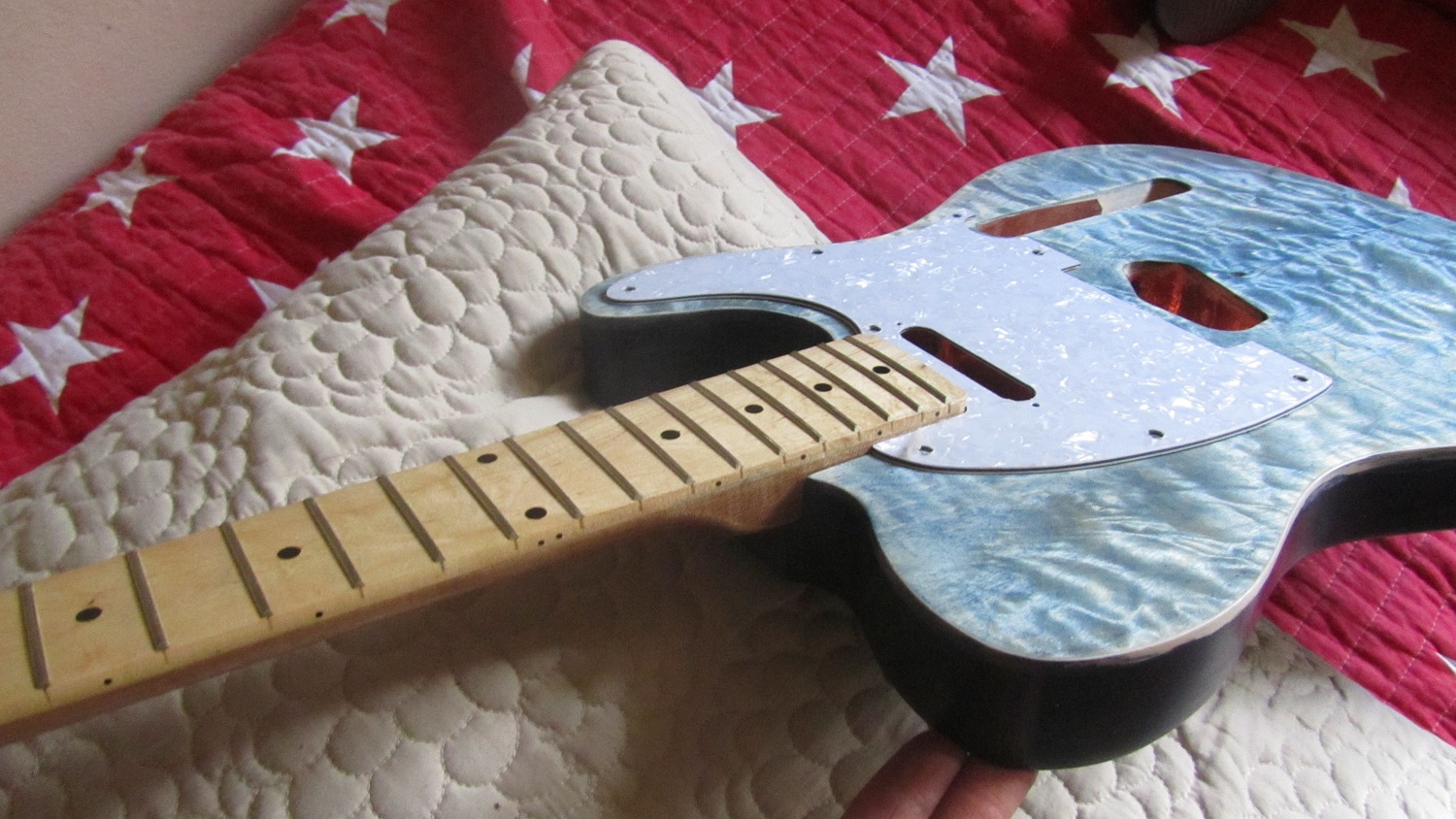

    Here is the Blue boot Polish second coat.....Will cut back with sanding after few more coats

    that comes up good!
    great colour from the polish!
    Similar colour tones from front to back....worked out good and cost next to nix I bet.
    coming along nicely HB, the colour is very similar to Dingotone Bondi Blue. Got to love blue quilted maple looks like you are looking into a swimming pool ! Have you already put the copper shielding in ? I usually do that last before the wiring.
    Be worth cleaning up the binding now as well.

    Hi guys, haven't posted in a while nothing to report as waiting on the Neck curing and the blue stain to dry out, I haven't done the shielding yet nor binding,reason is I am clumsy and I know as soon as I handle it I will smudge something so waiting till the finish no longer smells then know it will be dry,

    I was pretty skeptical when you said "blue boot polish" to stain the body, but that quilted top looks amazing!
