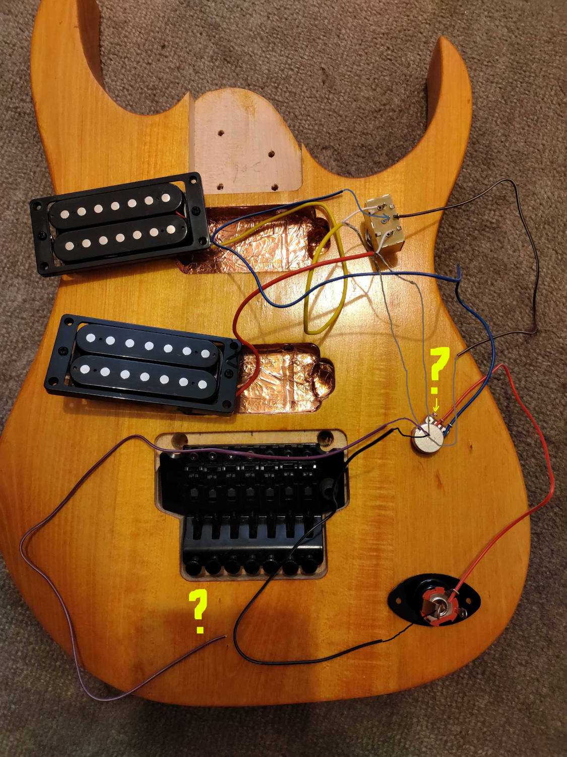

    Hi team! Could I please get a look over this wiring? I've tried to set up a mockup of how everything goes together outside first, according to https://www.pitbullguitars.com/wp-co...2H1v3_2014.pdf
    I think it's correct except for three things I'm not sure of:
    1. What happens to the leftmost tab of the volume pot (marked with the top question mark). The wiring diagram appears to indicate soldering, but to what?
    2. What exactly does grounding the purple wire to the bridge entail? (bottom question mark)
    3. Are all those five wires going to the same solder point on base of the volume pot?
    Thank you Click image for larger version.
  11. #70
    2,038
    Hi AlexL,
    1. The leftmost tab of the volume pot is to be grounded to the back of the pot. Some bend the tab, but I join them with a very short wire.
    2. The bridge wire needs to be grounded to the bridge - With a tremolo, I think they can be joined to the spring screws (But I have not completed a kit with this style tremolo!!) Hopefully some one else will add to this.
    3. Yes - but than can sometimes be difficult. Twist them together first and then solder to the pot.
    Plus, I cannot see the jack plug connections in the picture. The ground needs to go sleeve(?!) connection tab of the plug, and the hot goes to the tip connection tab.
    I hope this helps.
