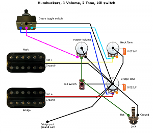

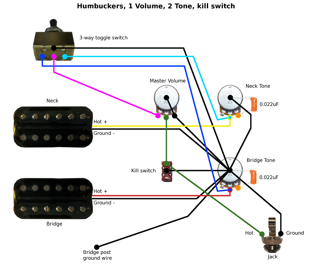

    Master volume, individual tones, plus kill switch?
    Looks awesome Kurt! Burst came out really well.
    Something like this...?
    You can use an On/Off, On/On or even On/Off/Momentary toggle (or push button) as the kill switch, depending on how you want to use it.

    @wierdy, that should work perfectly! Just on of those on/on dpdt mini toggles that I got should work fine right?
    For some things, some times, it's the same time all over the world, and I think we know what time that is...
    hey Kurt, might pay to post a pic of the bottom of the DPDT mini toggles and Weirdy will be able to tell you which lugs to solder to
