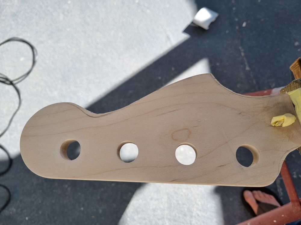

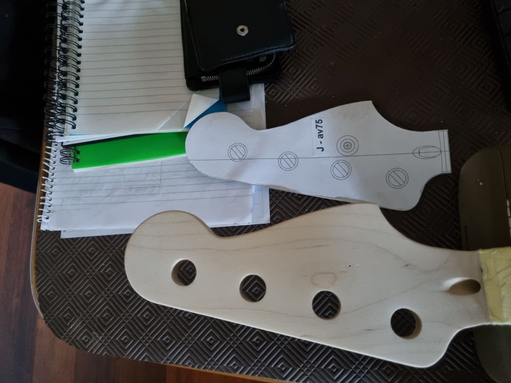

Name:	Bass neck shaping 1.jpg
ID:	44635Click image for larger version.
Name:	Bass neck shaping 2.jpg
ID:	44636 First of the shaping of the head stock, Im keeping at the J-AV75 shape as I like the thicker look as opposed to the original Jazz head stock shape Fender shape, I know its a copy, but that's what I want. Still a little tweaking to do a couple of high spots to sort out, all in good time.

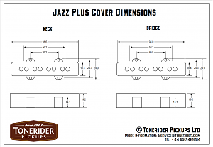

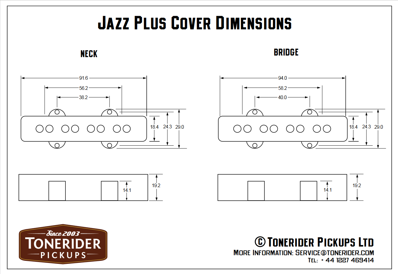

Name:	Screenshot 2023-07-28 at 19-34-54 jazz bass dimensions - jazz-bass-dimensions.pdf.png
  9. #69
    Here's a link to a build from 2020/21 where they had to enlarge the bridge pickup routs slightly (so I didn't imagine it!). They'd made their own 3D-printed pickguard so there was no need for modification on that. https://www.buildyourownguitar.com.a...l=1#post215924
  10. #70
    hmmm ok, well, that bit of information helps. I wasn't doubting you at all, just thought I would pull up some specs and compare, It does look to be the diameter of the set screw cover casting. Unless, as you said, the supply chain has changed, and I don't know how old that info on the specs is. At least now I know what to expect if I decide to change out the pups.
    Thanks Simon.
