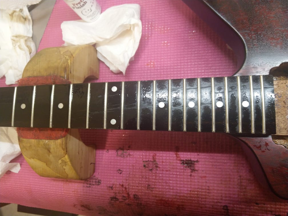

    Hi,

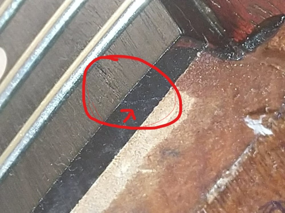

    Somewhere next week I'll move on to finish the guitar. However, today I took some time to clean the fretboard (didn't mask it, huge mistake)... But after some cleaning, I noticed some cracks on the fretboard....
    What should I do to fix this?
  5. #65
    Should be an ebony fretboard, so it's unusual to see any marks like that. Don't think its a crack, just part of the wood grain. With rosewood, you'd have a lot of those all over the board as it's just how the wood's textured. Ebony is a lot smoother, but I guess it's still possible to get a few marks in it depending on which part of the tree the wood's come from.
    So I don't think it needs fixing per se, but I would certainly lemon oil the fretboard to stop it drying out. Trying to fill the gap might end up with something that's more noticeable.
  6. #66

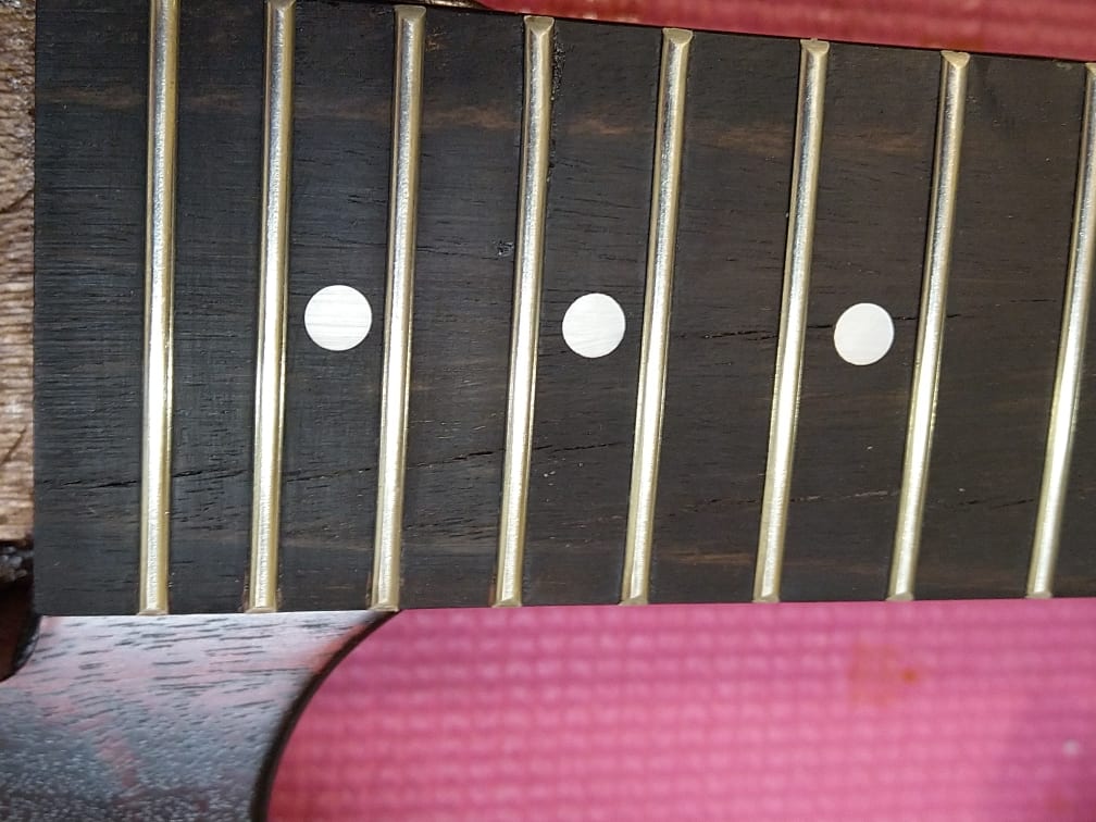

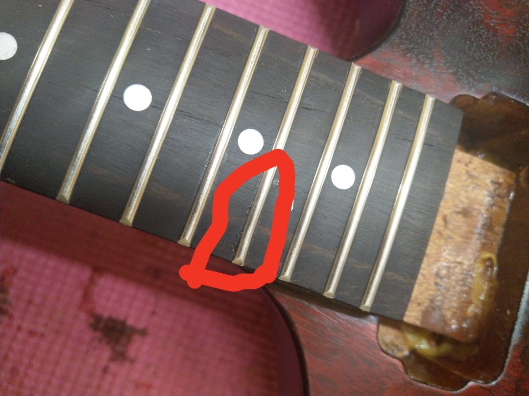

    And... more pictures.... Found also a damaged fret...
ID:	37279 Click image for larger version.
ID:	37280 Click image for larger version.
Name:	fret damage.jpg
  7. #67

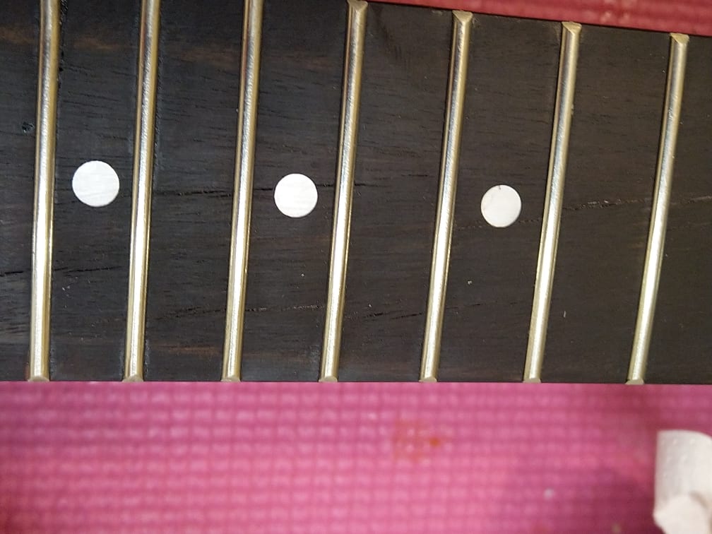

    And after oiling the fretboard as suggested, this looks more severe....
  8. #68
    Fill with CA glue and scrape level?
  9. #69

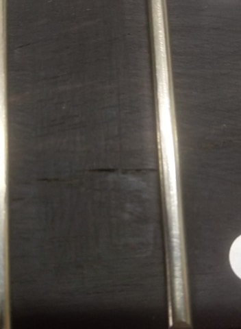

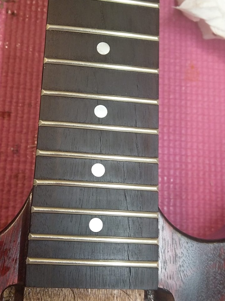

    After oil in the fretboard....
    Taking a better look....
    So... Am I doomed, or there's any way to repair this, or I don't have to worry? I only spotted this detail by using lots of zoom... looking normaly you don't notice...
  10. #70
    I really don't think you are doomed. They aren't going to use the best pieces of ebony on a kit board, and I'd imagine that's the result. Apparently ebony can be prone to small splits and cracks if it dries out too much, but I think what you have is just the result of a lower quality bit of wood (and maybe not the best variety of ebony).
    If you want a smoother surface, then I'd go with other's advice and use CA to fill the cracks (I'd use black CA as it's a dark but not solid black) and scrape flat. Leave it a couple of days after the oiling before doing that. And then I'd lemon oil on a regular basis, maybe every 6 months.
