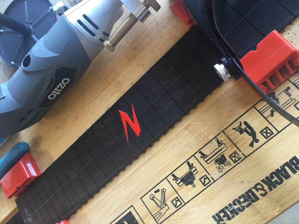

    Started routing the fretboard starting with the Z. once that was ok routed for the remainder of the inlay. Drilled some holes through to let light in, but may not be enough and may have to join some up to create larger openings. A bit concerned of taking too much out and the frretboard breaking out. Have the routing to the point where the pieces fit close to final position.
    Going to have to reevaluate what light source I am going to use. Had intended to use one or two diodes off the light strip imbedded in neck but may have to look at better diodes maybe.

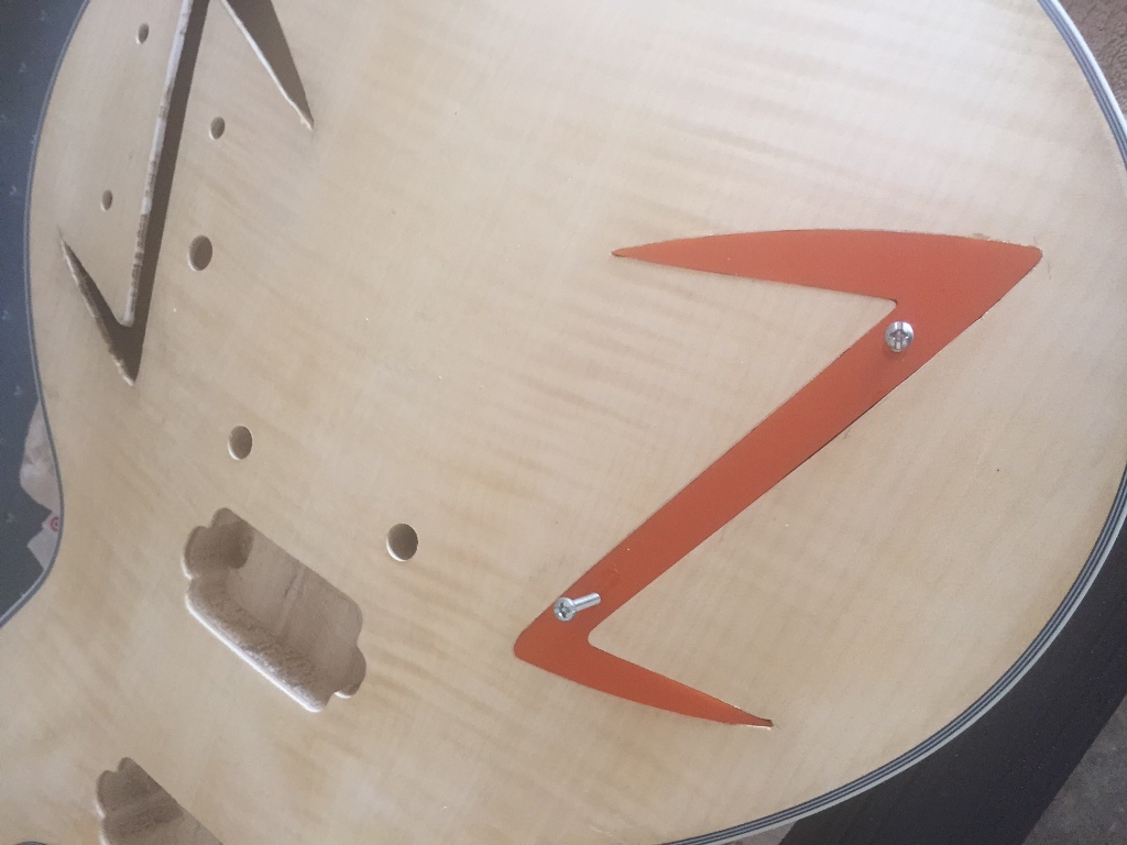

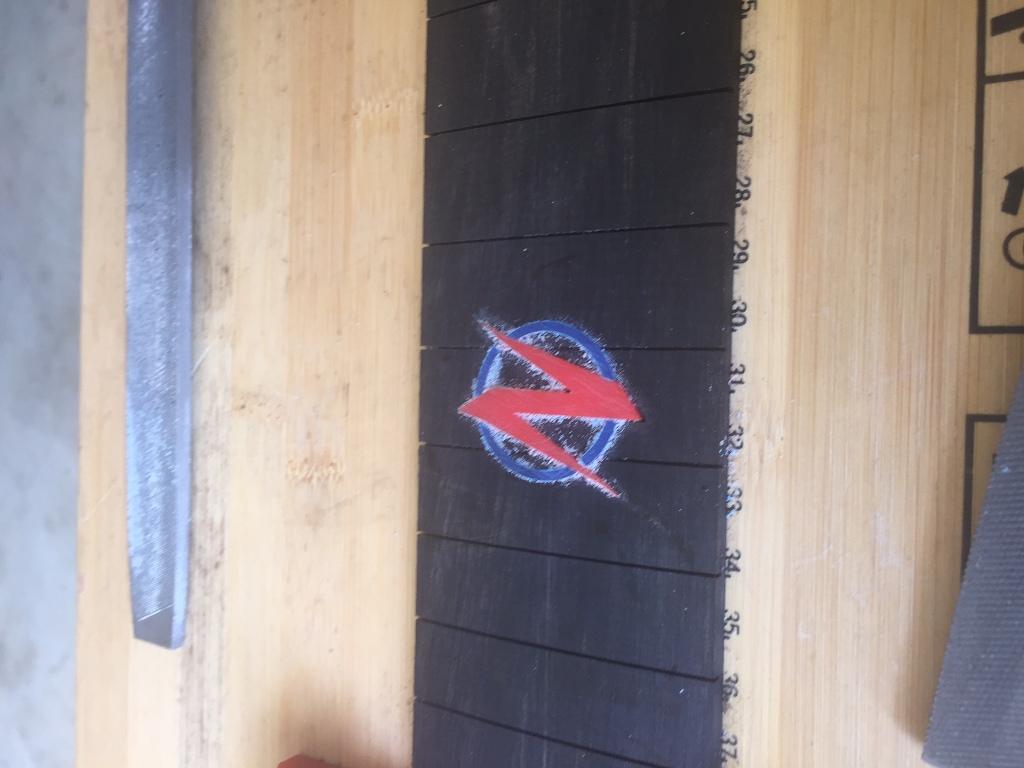

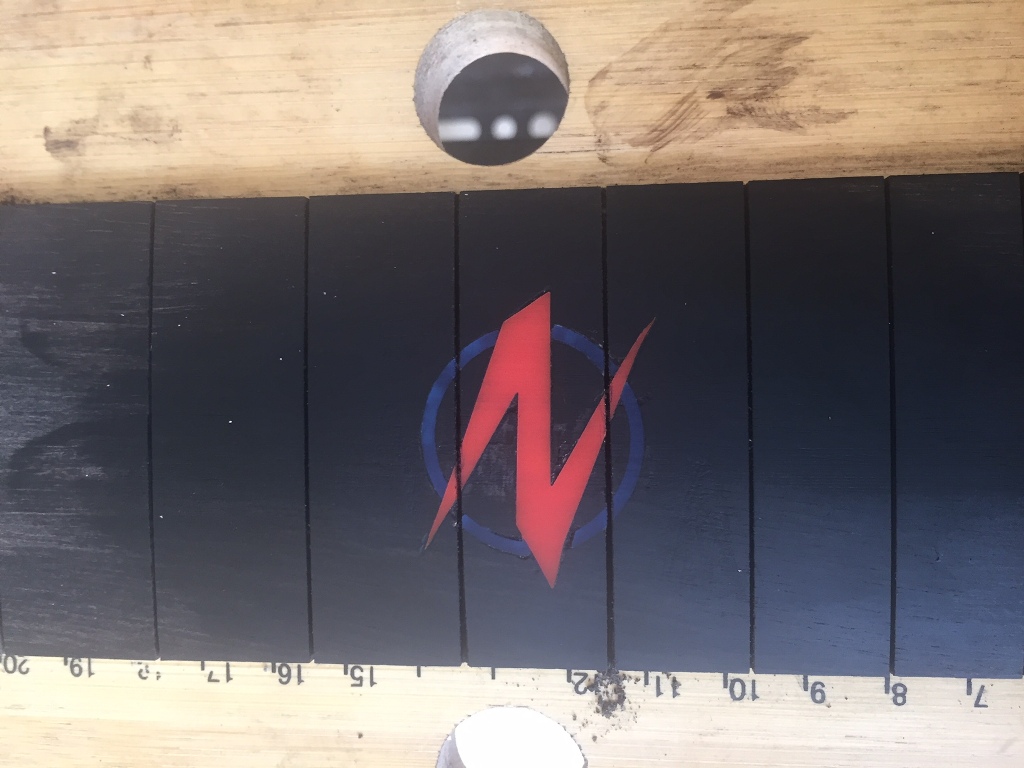

    Today got a chance to glue in the fretboard inlays and filed down before sanding to the fretboard radius. Still need to final sand after putting some filler in the gaps. Shaped the headstock and routed for a pau disc. (earth).
    Finished shaping the Z holes for the inserts and happy enough with the fit.
