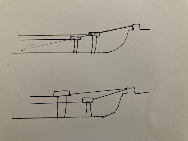

    A quick sketch (absolutely not to scale) shows why the furthest forward tree has the tallest post in order to get the string break angles similar
    Most string tree posts have less of a comparative height difference than your kit posts. Your small one is about 1/2 the height of the tall one, whereas the small one is typically around 2/3 the height, so you may want to space the posts slightly further apart than I've suggested. I'd start with locating the B/E string tree, and then experiment (with the D/G strings slackened off a bit) for the position of the other string tree so that the string angles to the nut are similar.
