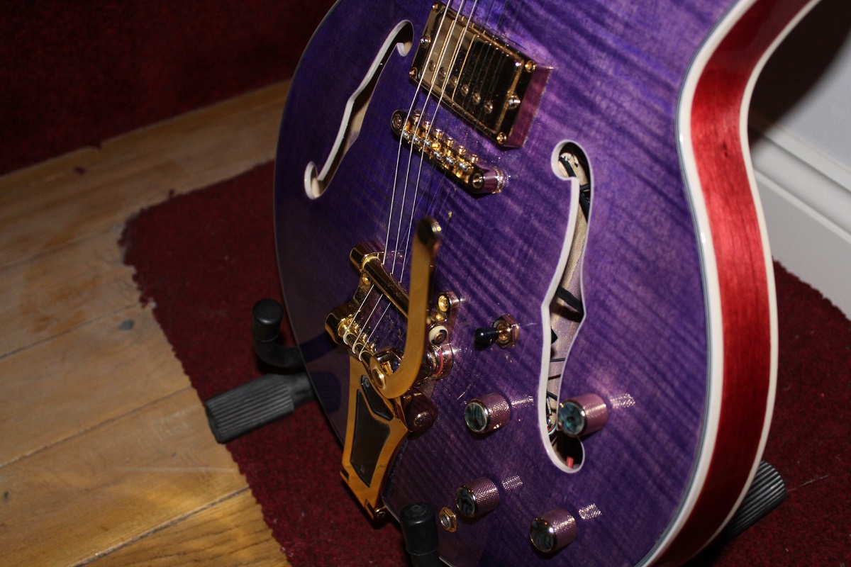

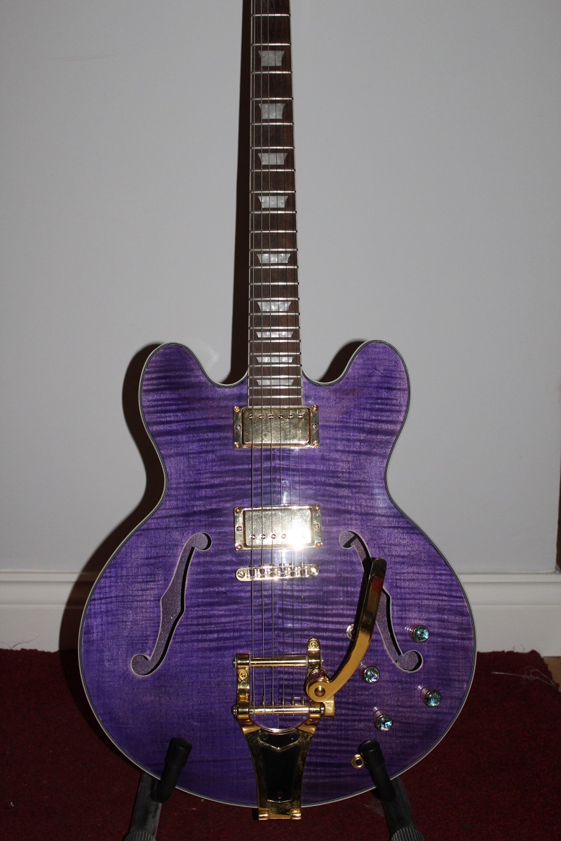

    I 'Think' I may have finished the clear-coating on this guitar.
    It looks good right now but I will wait until tomorrow and give it a wet sand (stuff I use is ready for wet sanding after about 12 hours - Omi-Cron).
    Truss rod cover made today. I will post pics tomorrow.
    Wiring harness is made. Pics are on my other thread. Thanks to you guys for steering me in the right direction for the wiring (humbuckers with parallel/series push pull switches).
    Cheers
    Ricky

    Lots of hard work there that's paid off. Well done!
    1,772
    Great work, love the wolf paintwork.
    PitBull Builds: FVB-4, LP-1SS, FBM-1, AG-2, TB-4, SSCM-1, TLA-1,TL-1TB, STA-1HT, DSCM-1 Truckster, ST-1, STA-1, MBM-1, MBM custom, GHR-1 (Resonator), FH-5V (Acoustic).
    Apr 2020
    Northumberland UK
    124
    Thanks Trevor and Simon. Much appreciated!
    It needs a polish and better photos to show the shine off a bit more but i just enjoy playing it too much!
    Cheers
    Ricky

    Nice job.

    Awesome details you put into it. Is the trussrod cover made from wood? It looks crazy good.
    Apr 2020
    Northumberland UK
    124
    Thanks Jim and Clueless.
    Yes, the trussrod cover is made from 7 laminations of veneer glued together then cut to shape and carefully sanded down to allow the various wood colours to show. Doesn't take long really but looks cool.
