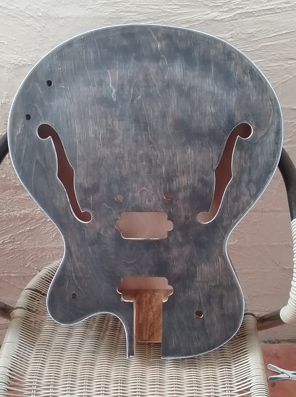

    A longer Wait
    Waited another 2 days (10 in total) since the 3rd intensifying, intensely dissatisfying, unintentionally disrupting coat. But it was still sticky. Had a gutfull, so I told mah'self ...
    Cain't Wait No Mo'
    ... and thus I hit the top's surface with some aerosol canned eucalyptus oil and a rag. Actually, first I tried using the steel wool. Not effective. It's like peeling those crummy rubberised coatings off headphones and guitar tuners etc. I left the eucalyptus oil on for barely several seconds, and only in relatively small patches. It cleaned the intensifier off nicely, fairly easily. The oil itself is relatively volatile and was being sprayed on lightly and not left to penetrate, I suspect (and hope) that it didn't harm the glues binding the ply layers.
    Goodbye, stuffarama-inducing 3rd intensifier coat, and welcome back blu ... !!! Bondi Blue must've given up on ever being seen again ... and that's how it will remain.

    In my internally quelled sub-rage-level discontent I started cleaning up the intensifier from the binding. I actually liked the blue-smoke of a filthy old diesel engine look for my binding. However, it was "inconsistently applied". Namely, accidentally and sloppily. I could've gotten away with it if too -- "if it weren't for those meddling kids" (Scooby-Doo)" -- and if I'd deliberately smeared what came into contact with it immediately.
    Tried a blade edge. Surprised it worked to the extent it did. Couldn't be bothered (personality flaw) doing much and didn't have a decent blade for the purpose, so I tucked into it (against wise men's advice) with steel wool and 360 grit. I'm content with the imperfect result -- more on that later.

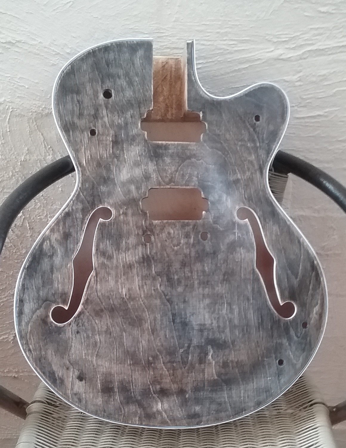

    The eucalyptus oil clean-up left the body feeling nice and dry! Oh, happy day. I felt it time to smear a clear without any fear.
    First Finish
    So I applied a thin coat of finishing oil to the body and neck. I am happy with how that turned out. Also. I am a little . I believe I should've bypassed the intensifer altogether and gone straight to the finishing oil. I would have my little "Blue Heeler" (or faded denim jeans) and -- theoretically -- complete the job sooner with much less hassle, frustration, and self-doubt. The finishing oil is a satisfactory intensifier for the Bondi Blue stain kit ... but the kit's intensifier product itself is not suitable (imo) at all.
    "Do you have any wise words for other kit builders?", you could mockingly inquire. No. good sirs and madams! I've broken so many rules of thumb, guides, suggestions, good advice, experiential snippets and gentle prods that I consider myself unwise as well as unworthy! I might try to write a "summary of sillinesses", though I've seen elsewhere on this site a good list of "do's and don'ts".
    Here are a few of the first finish coats;

    NOTE: Crikey, that top looks ... rustic. Didn't expect to age it 50 years. Further comments in the next thrill-less instalment;

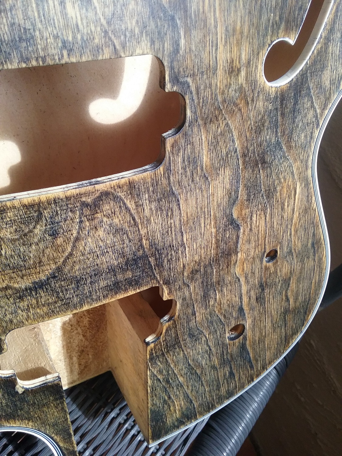

    "Blue Heeler" Bondi Blue GR-SF1: Pt9 More Coats
    Back at it after 4 weeks inactivity since my previous posts (#51 and #52)!
    I tried another finishing oil coat the day after the posts. Good weather. Left it in the warm sun a couple of hours to assist drying during the humid Brisbane weather ... and it sweated oil out into tiny, shiny pools forming a spattering effect when viewing reflected light. Grief.
    So today I searched for furniture waxes as an alternative polish/sealant/protectant. The ingredients are the same as the dreadlock wax our niece gave us. No, we never wore dreadlocks, but I wanted something to keep my hair in place. This stuff was too thick for my hair though. However, it made a decent wood polish!
    First, I tried to lightly rub off the sweated DT oil with some eucalyptus oil. Didn't really work. It's "there for good" now. Never mind. I truly don't care. Then I applied the wax. How did it turn out?
    Well, in truth it didn't drastically affect the look of the timber at all. Barely noticeable. Still, there is a small extra depth and slight sheen when viewed from more acute angles. The DT oil covered the aspect of the original "sealing" well enough, I suppose. I gave the wax a little buff.
    My thoughts? I think I'll be content with a beeswax finish ... but I guess guitar usage over time and under various weather conditions will bear out whether or not that holds true. Here's some piccies. Not much change to notice, except warmest lighting made the colour more true on camera.
    Ah, warm colour at last!

    Sides too look warmer
