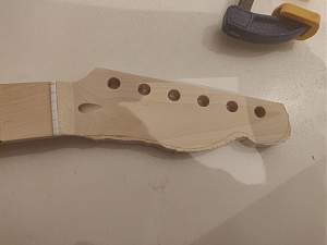

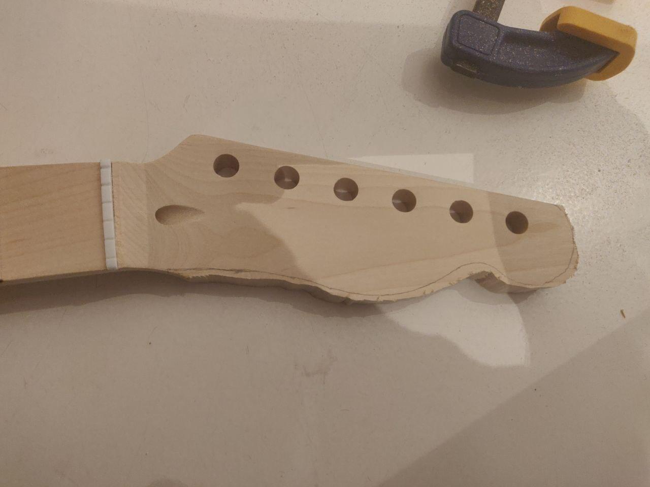

    Here's the result after cutting off the bulk of the excess with the coping saw. As you can see, this isn't something I'm even remotely competent at...

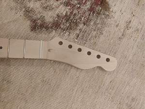

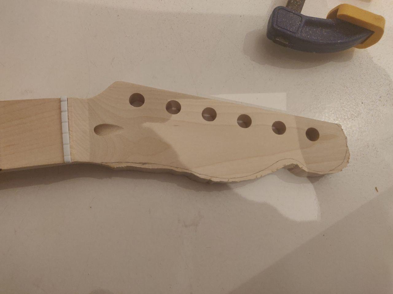

    However, half an hour with some 90-grit sandpaper and things are looking a little better:

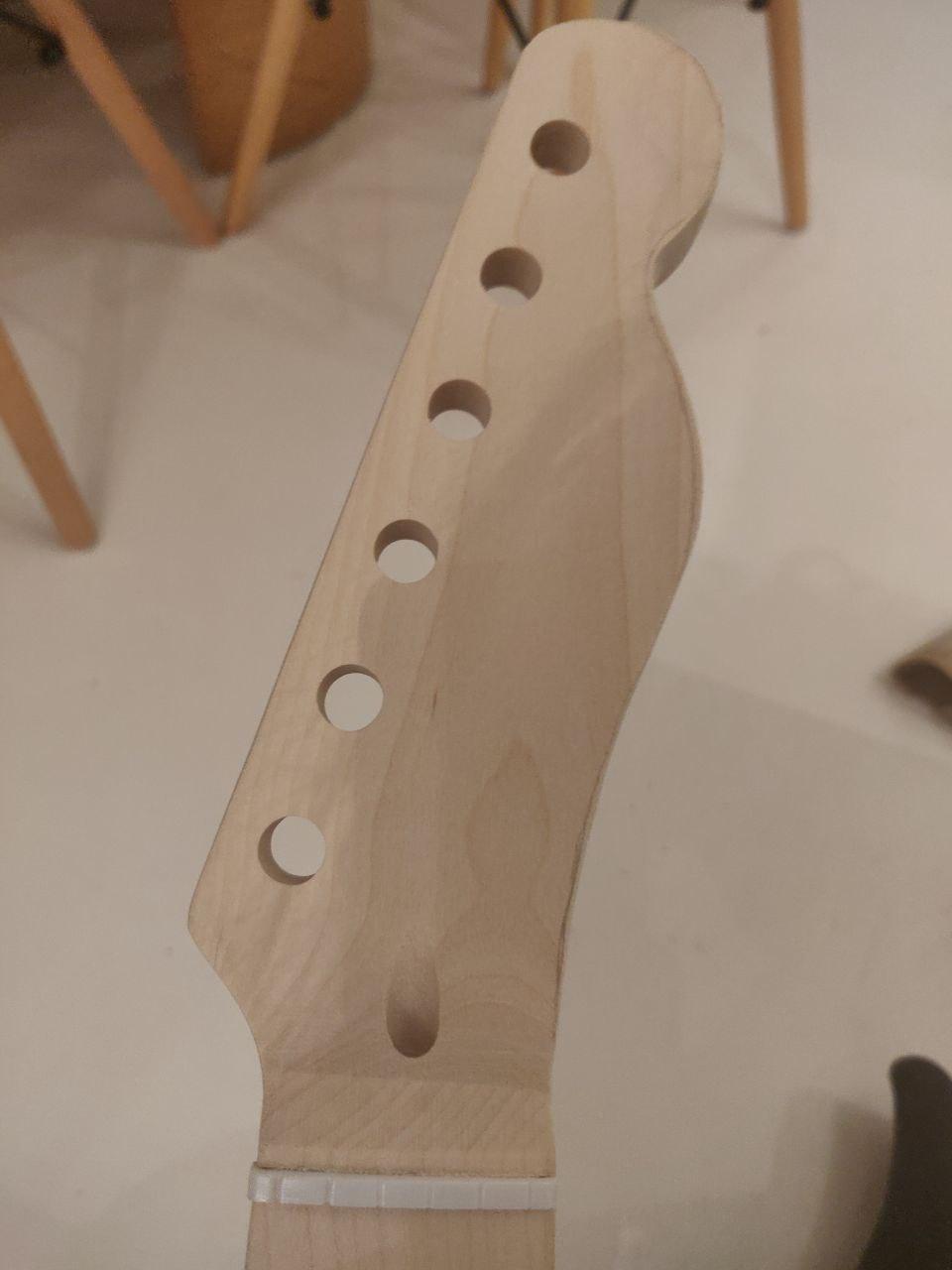

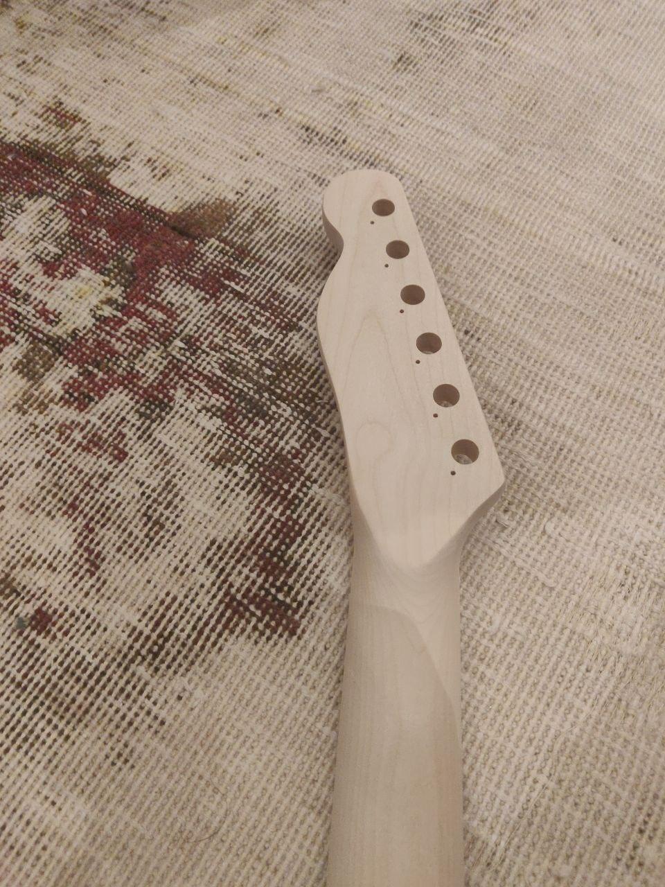

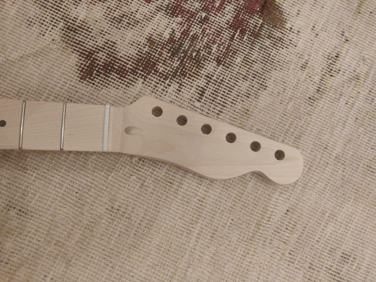

    And another half an hour with 150-grit, using both a deodorant can and my e-cigarette as sanding blocks for the concave curves, and the result is something I feel quite proud of!

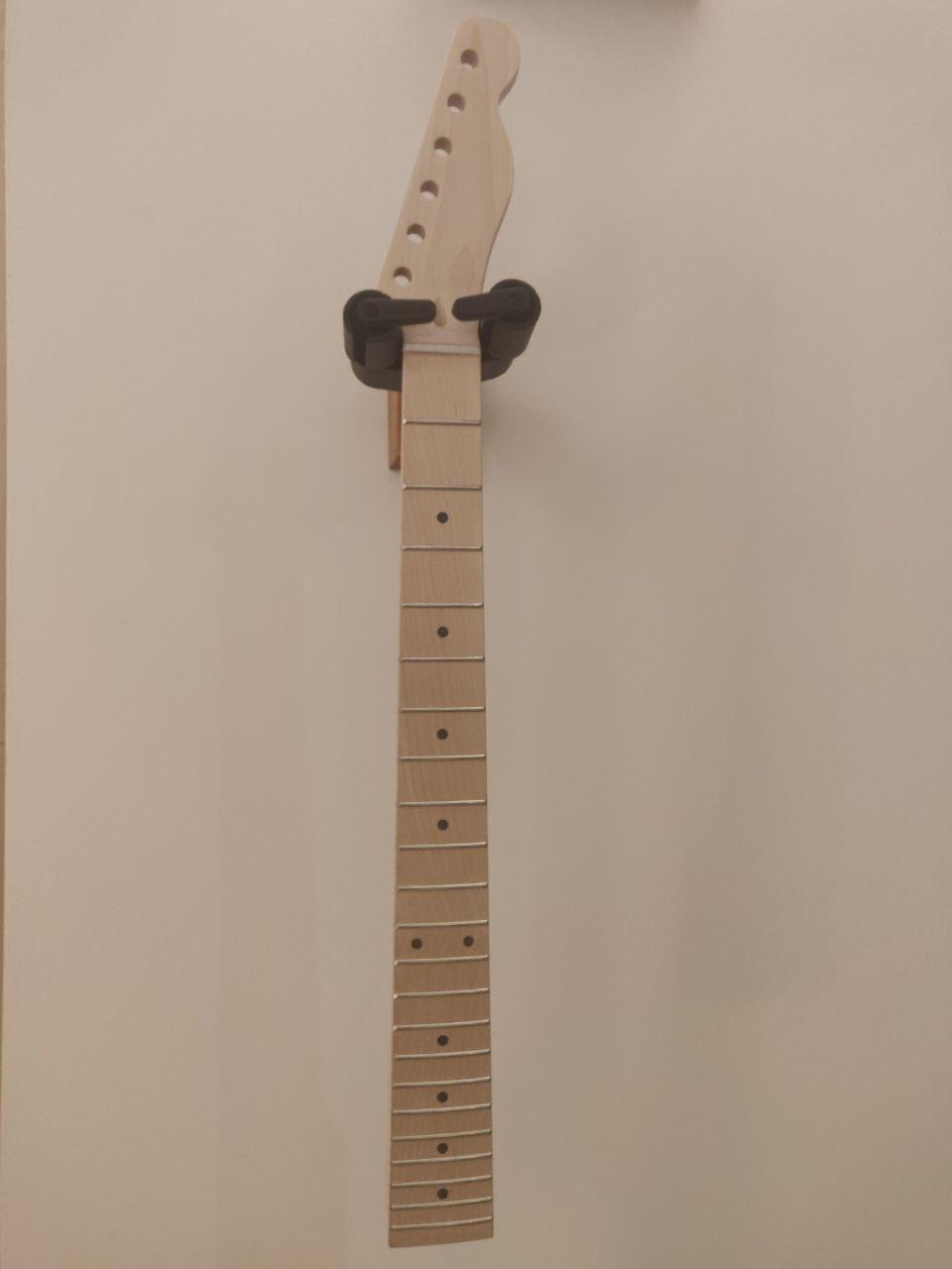

    Finally, a sanity check -- does the wall mount hold it?
    Yup

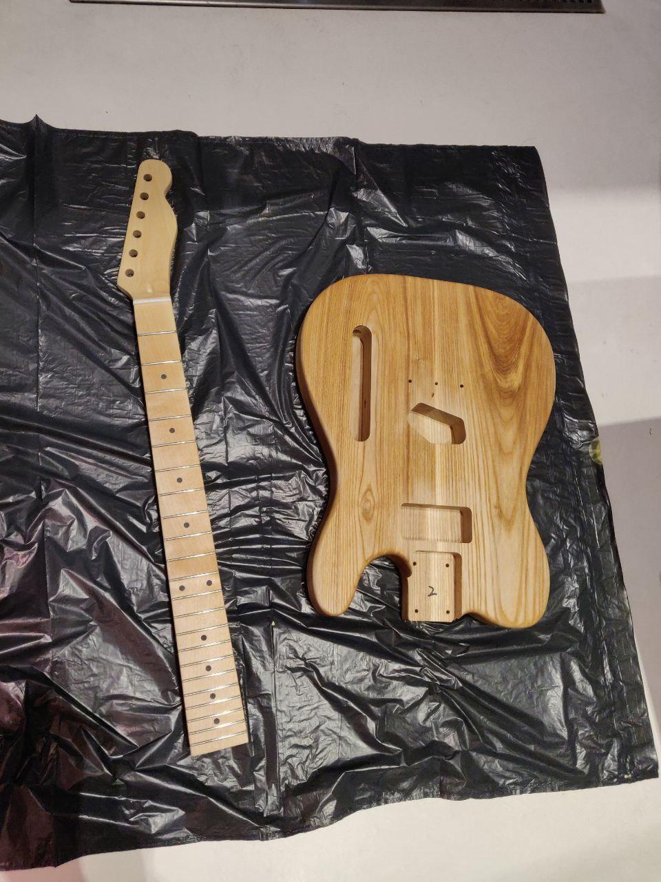

    A quick wipe down with white spirit to see if there are any glue spots and to check how the grain will look when oiled -- not clear from the photo but there are a couple of light glue marks near the control plate. Need to get something to remove that.

    Excellent work.
    Cutting maple with a coping saw is quite difficult.
    (I gave up and just straight-cut the excess with a normal hand saw).
    You are lucky though, in that those tuning holes are lined up quite well.
    cheers, Mark.

    Nice work on the headstock BTW. You'll soon be making your own necks from scratch!

    That's a lovely grain pattern in the ash.
    Some contrasting grain filler will really bring it to life.
