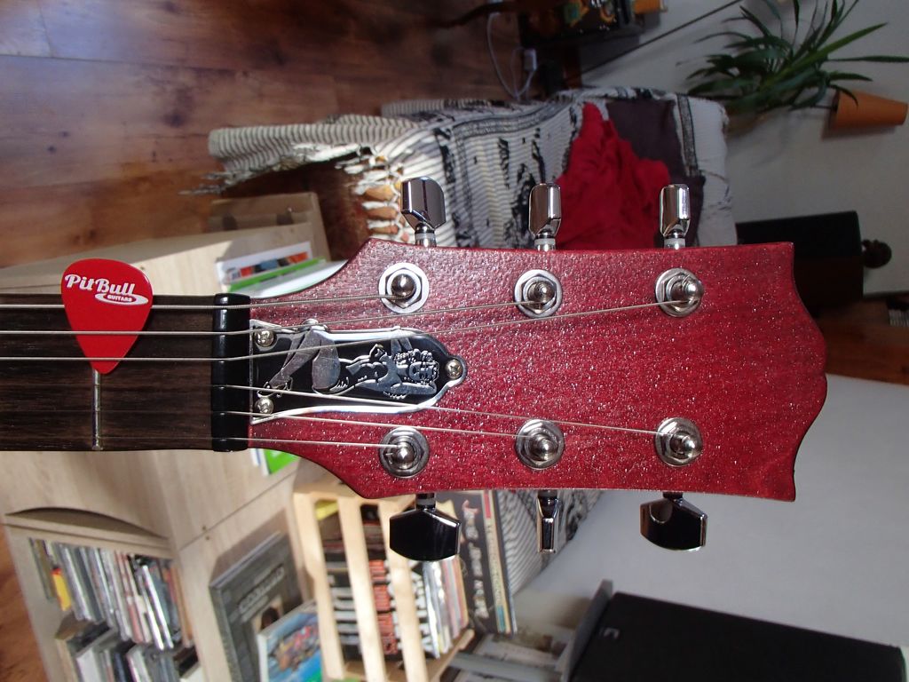

    My plans on this guitar are to use a cherry red dye, put some transparent Acrylic Laquer with silver glitter, and apply some tung oil for the finish.

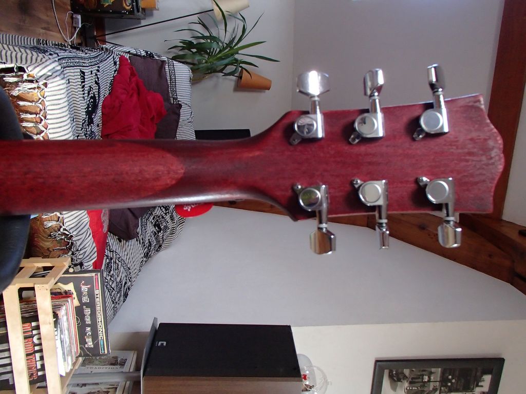

    I first did a mock build; The first thing I noticed when I opened the box, was a minor scratch on the Headstock, still big enough for me.
    The rest of the build was pretty much OK, just the holes to fix the neck that aren't really square, and I had to take off a bolt to fix the switch.

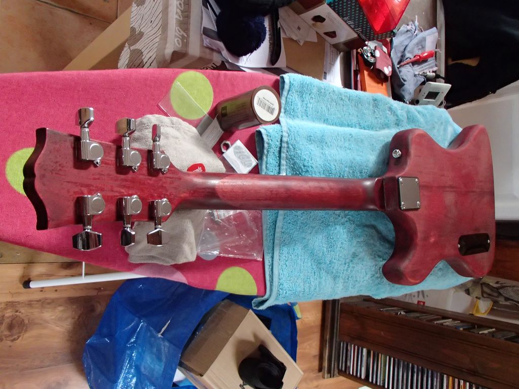

    The next day I started to sand the guitar, and it turns out that I almost fix the scratch on the headstock. you can still see it a little, but not feel it when your touching. That makes me pretty confident.
    Couple days after, I started with the dye. I mixed it with warm water and apply on both sides, starting with the front, let dry for about 1 hour, and did the back the same way.
    Next day, I sand using 400 sanding paper, apply another dye layer on the front, and let dry an entire day.
    Today I did the second dye layer on the back, and I can't wait for tomorrow to see if I need to sand a little , or some more, and apply the red dye one more time.

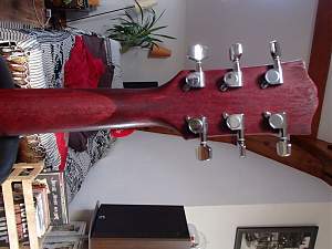

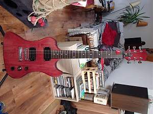

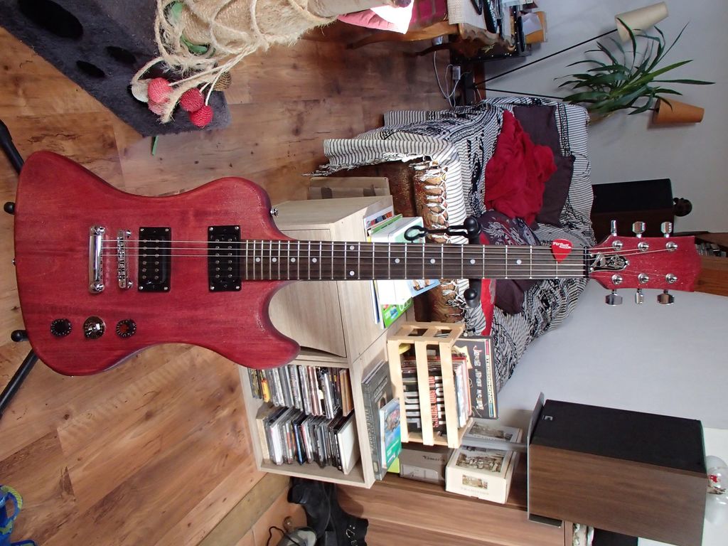

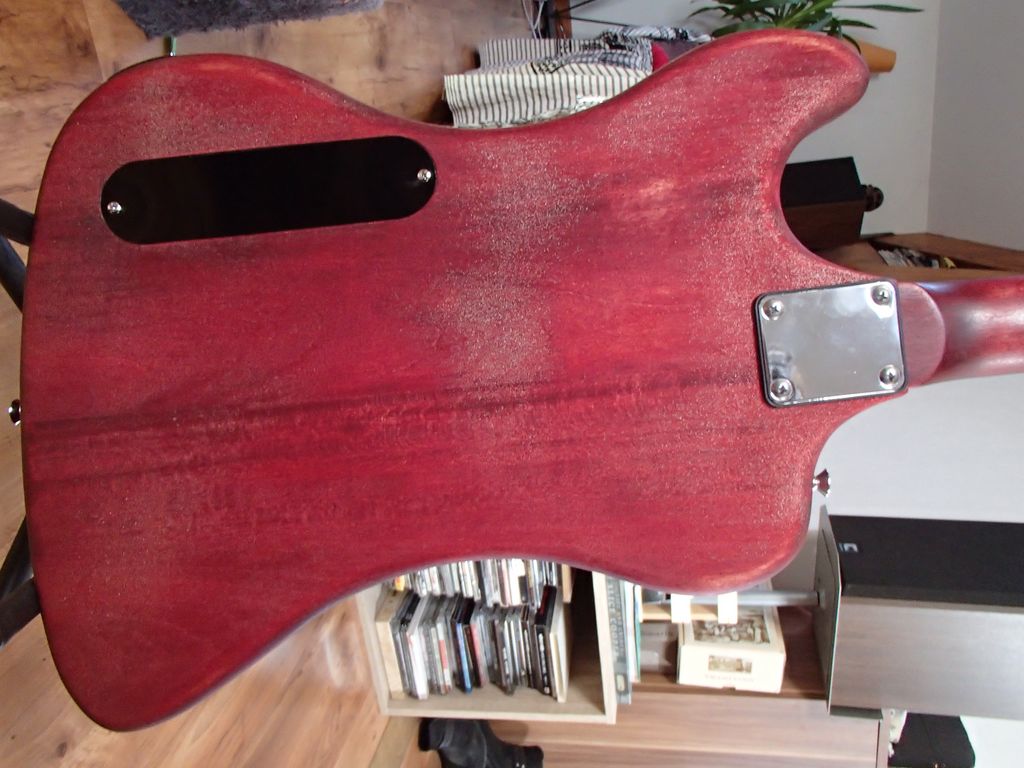

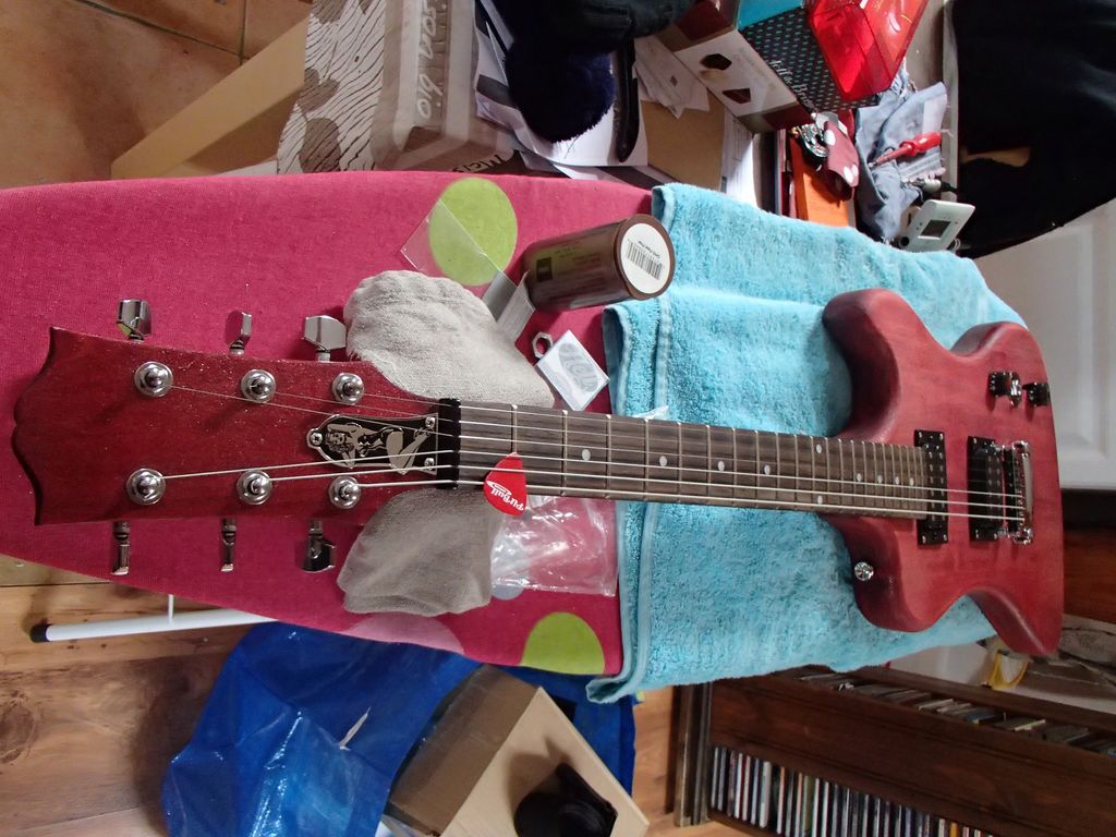

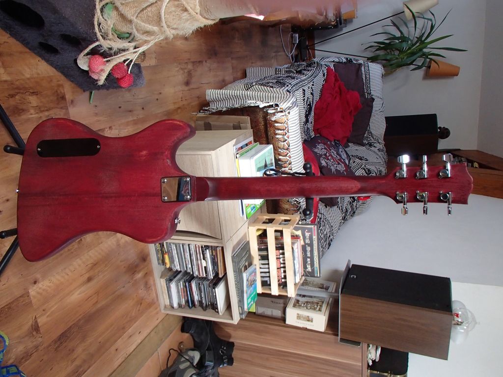

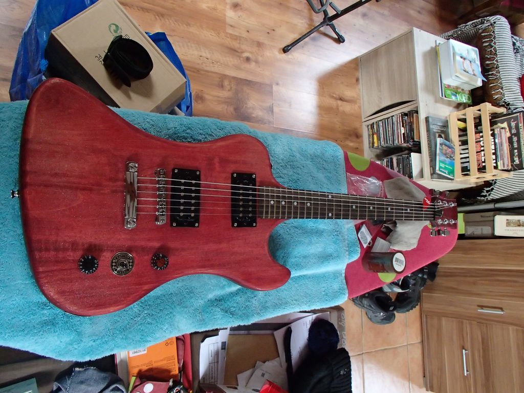

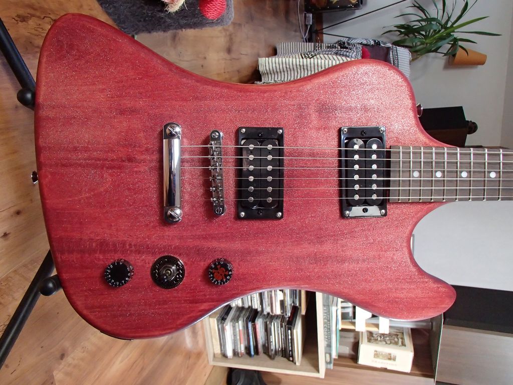

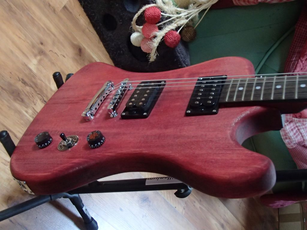

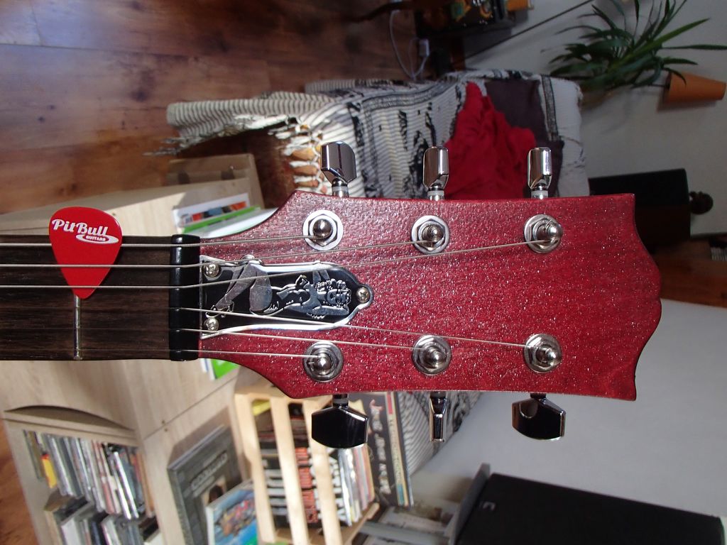

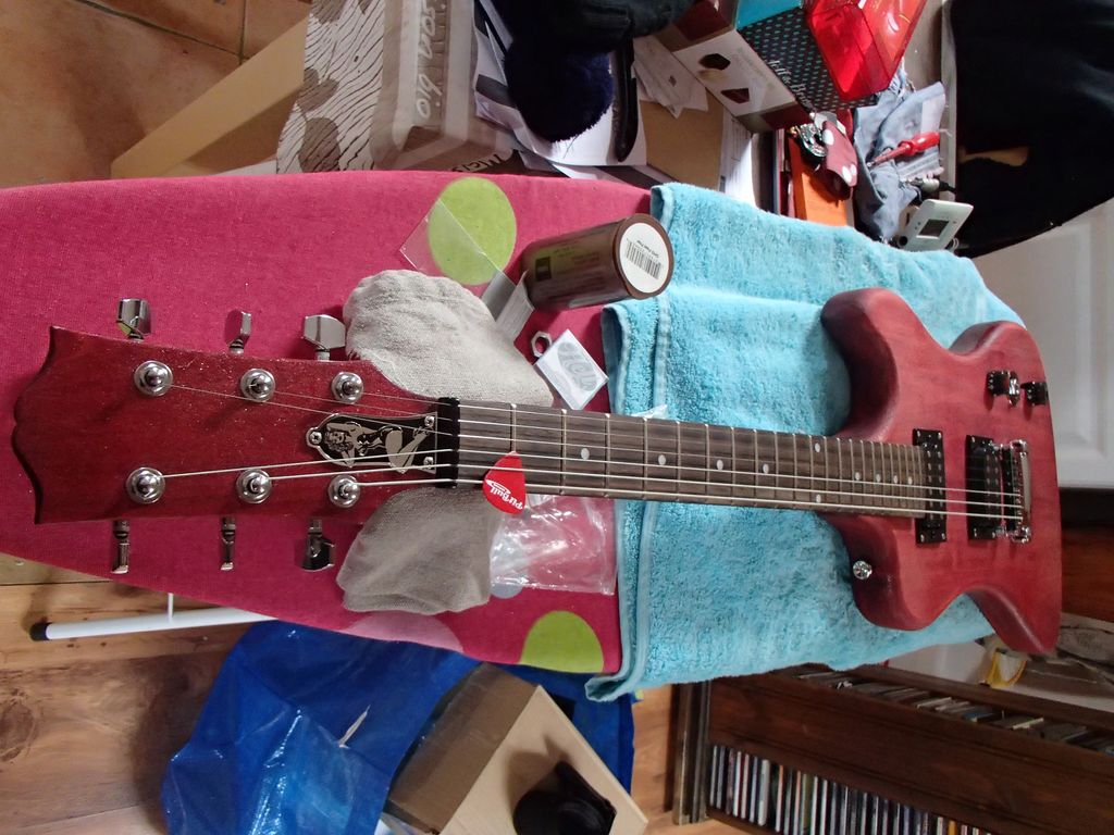

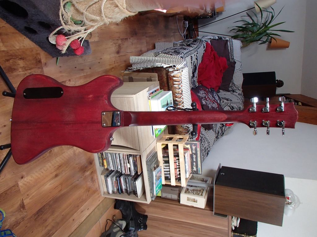

    Picture of the mock build :
ID:	22107   Click image for larger version.
ID:	22108   Click image for larger version.
