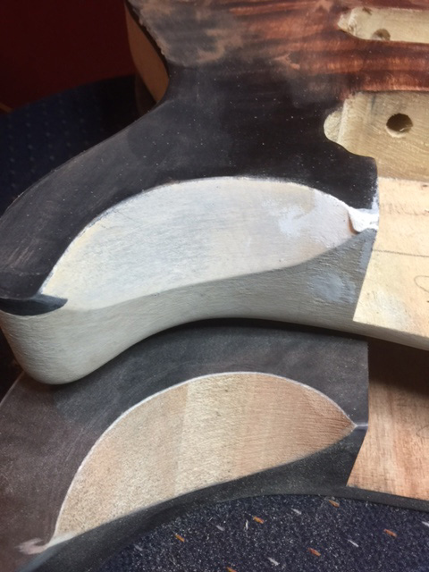

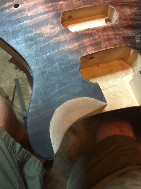

    I took the rasp to build #1 and liked the result, so I enhanced the cutaway on build #2.

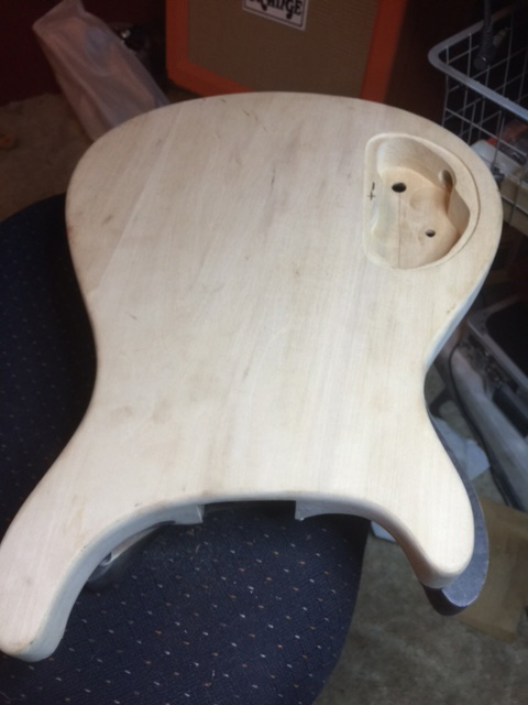

    Now... the body on the PRS-1TS is basswood, which is quite brown with distinct 'flecks' in the grain. THIS kit is also advertised to be a basswood body, but the two woods are quite different. Much whiter, finer grain, no 'flecks'.
    PRS-1TS with basswood on bottom, PRS-1Q mystery wood on top.
    I was going to just stain the back black, like build #1, but this is nice looking wood, so I'm thinking I might attempt to match the burst on the top.
    So... is it basswood? Or have I scored?

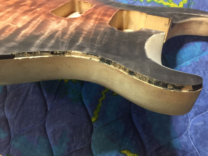

    I started removing the black binding too.
    I'm no expert, but basswood can be quite intriguing. Whilst typically being considered quite bland as far as woods go, it can quite often present with some interesting colouration and grain. So my guess would be that it is still basswood, but I'd be happy for one of the resident experts to weigh in and correct me.
    Someone said it was easy...
    1/6th of the way around after an hour.

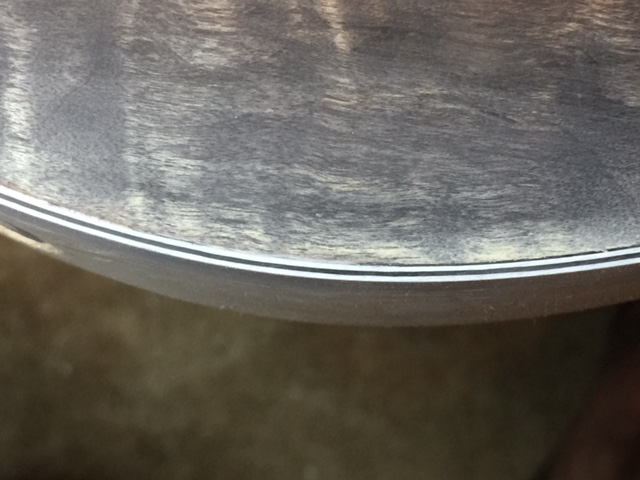

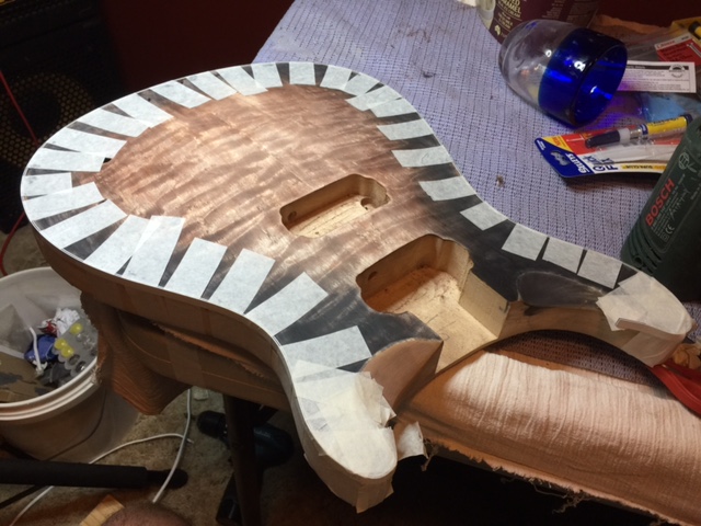

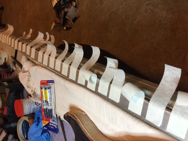

    Well, I made one of 'those' and got the rest of the binding off effortlessly.
    Preparing to glue the new binding...
    ...and, DONE!
    Pretty pleased with the result!

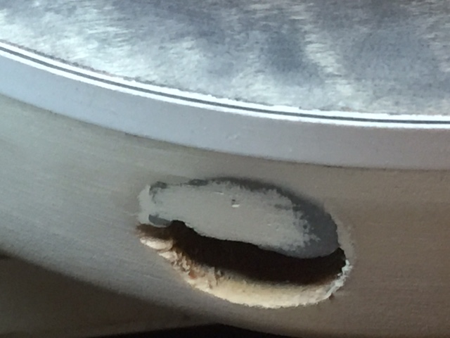

    One thing I had to do in preparation was to partially block off the output jack hole so the router bit guide bearing wouldn't fall into it. I can just knock it out now it's done its job.
