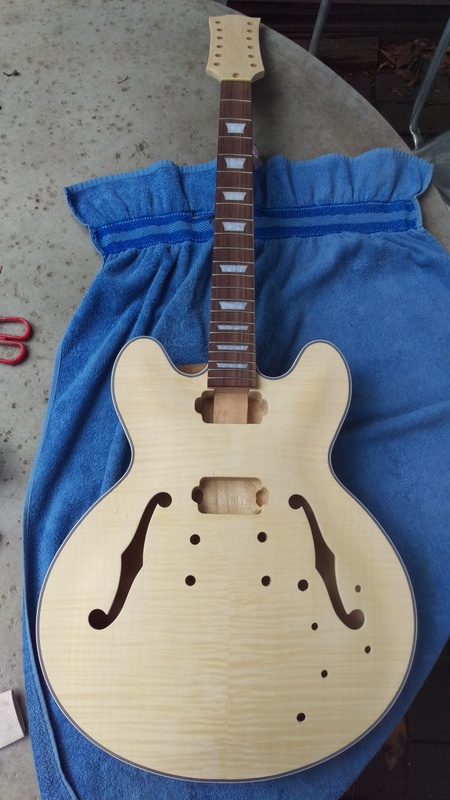

    So I jumped on the DIY closing down sale too and got a 12 string 335 style kit.
    I also got a set of Wilkinson humbuckers from them as they were pretty cheap (no idea if it was really worth it...) and 2x sets of Wilkinsons tuners (same as the pickups I guess...).
    For finish I'm planning to go with a clear natural and I wanted to try Aussie Oil, so I got a bottle too.
    Pretty happy with the kit and the flamed maple top it all seems to get together pretty good:
