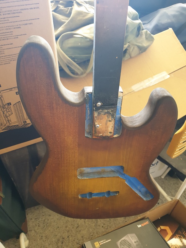

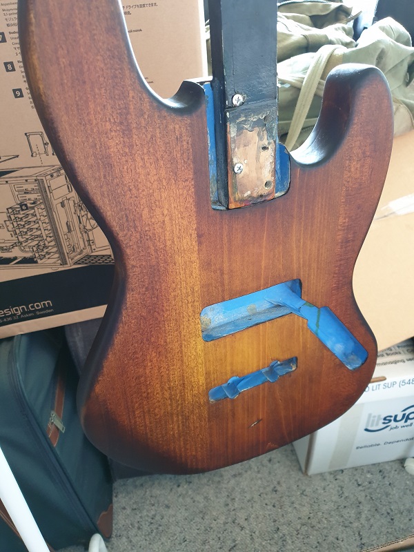

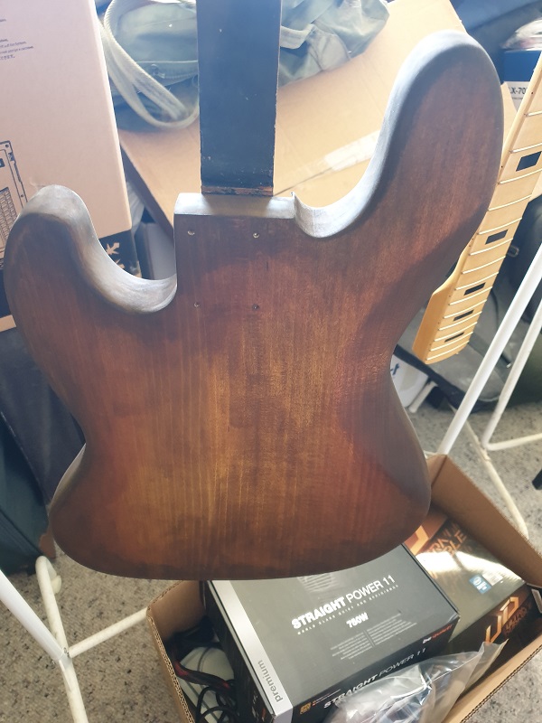

    The body has been sanded to 400 grit...as per Big D and the instructions that came with the dye. It was hard getting the dye to seep into the wood...but much easier to work it around and not get borders/tide marks etc.
    Three colours here.....straight yellow....yellow/cedar/green black...cedar/red.
    This was first application yesterday....and dried to this morning. I noted a couple of defined edges and got at the body just now with 600 grit.
    The 600 grit has now been stained again....not fair to photo it wet. It is now hanging. I think it looks very dark to me...but Big D seemed to want that on his video. Let us see what Tru Oil will do when it arrives.

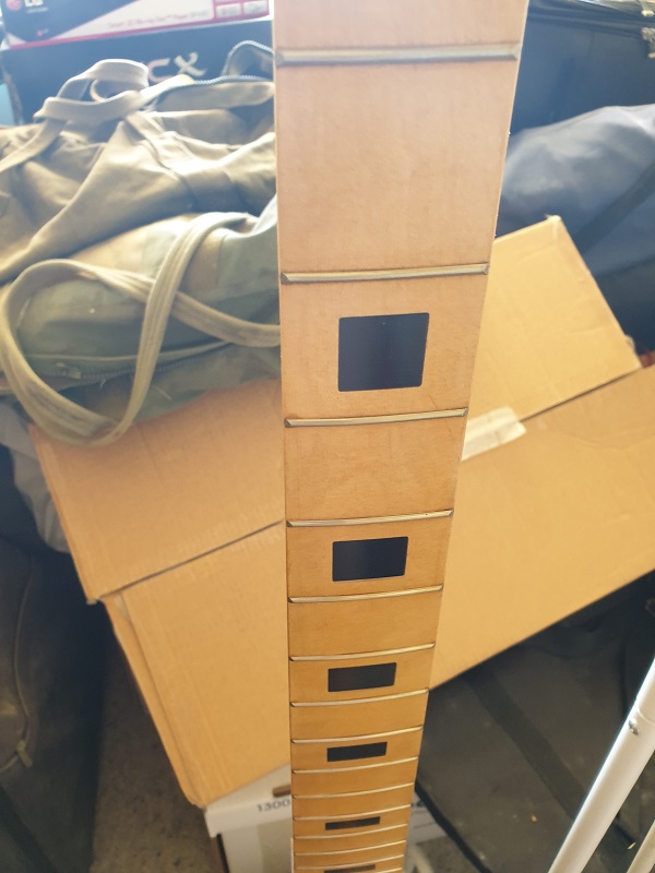

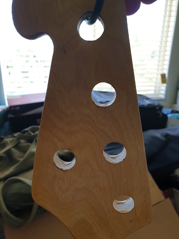

    The neck is looking nice with three coats of clumpy Tru-Oil. On Monday it can be satin poly sprayed....sanded at 600 grit....decals applied....then spray sand spray sand to about 2000.
    Big D was adamant about getting the red and brown to stand out....I think I have done that. Let us see what the sand and better staining has done now. mmmmmm.

    After my recent revelation with Tru Oil dragging colour around I now have a deep golden brown body as shiny and as smooth as glass. No burst.
    The neck is nearly done....little error with a four a side tuner going on the single tuner side...oops. Plugged, stained oiled and sprayed...nearly ready again.

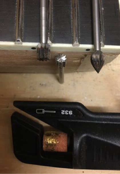

    I’ve got a little pink rock thing that is supposed to be a tool sharpening attachment when a separate....I’ll just photo it to explain. The wood carving attachments are what you are after. From what you are describing it doesn’t sound like you have one. My personal favourite is a cylindrical shaped one. I also have some cone shaped carvers. Back in jiffy with photo.
  8. #48
    Mentor DarkMark's Avatar
    Sep 2017
    1,578
    The cylinder ones (2 of the same type shown in photo) at the 19 fret would do the job. Perhaps a journey to the big green shed is required. Simon’s drill suggestion is good. Welcome back.
