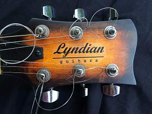

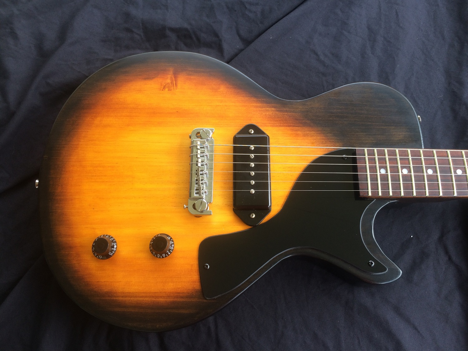

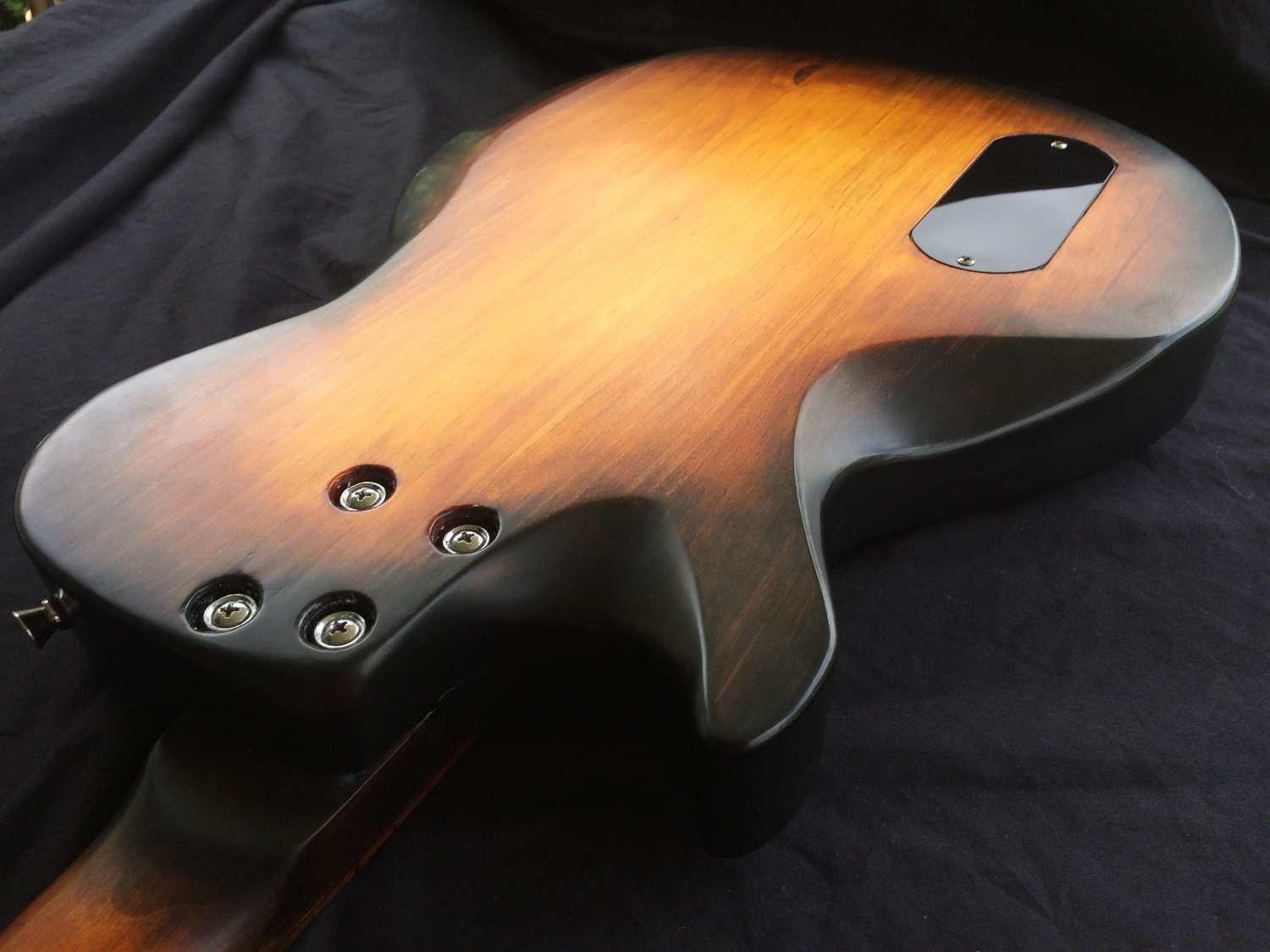

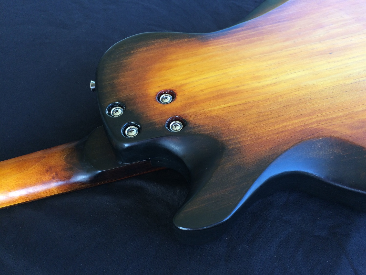

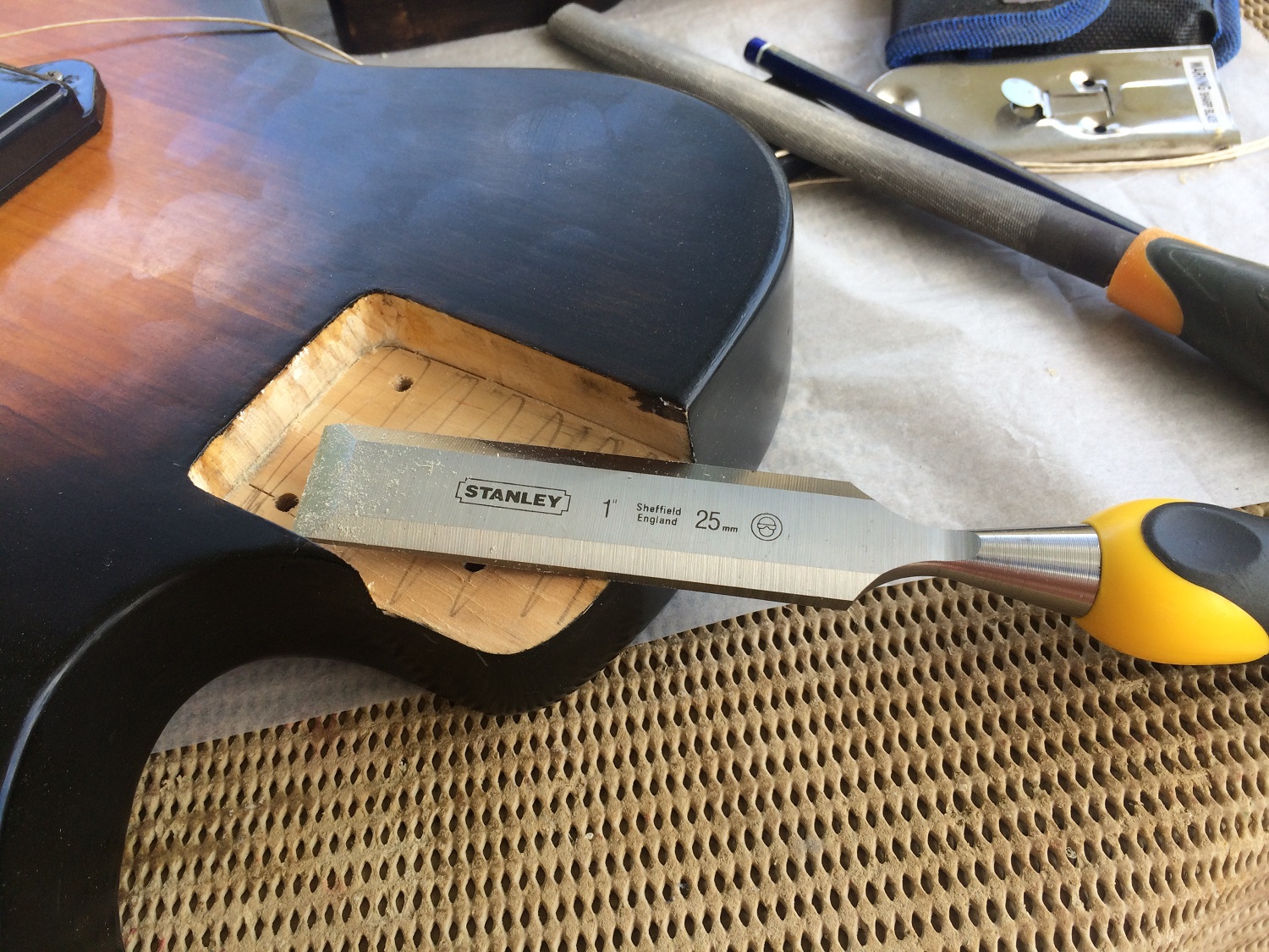

    Well its finally time to start putting her together.
    Last job was to shape the break angle. I initially made a shim of about 5 degrees and glued it in place. It was initially too steep so I got about to shave a degree or two off that.
    Unfortunately, like nearly everything else with this guitar I got it wrong. Not sure what the angle ended up, but it is now too shallow and even with the bridge all the way down the action is a little too high. I’ll use it for a while like it is but I will need to take the neck off again and adjust the angle so that I have the action I was after.
    Apart from that (and the first body that split in two and the bridge posts being in the wrong place….sheesh) I am really happy how she turned out.

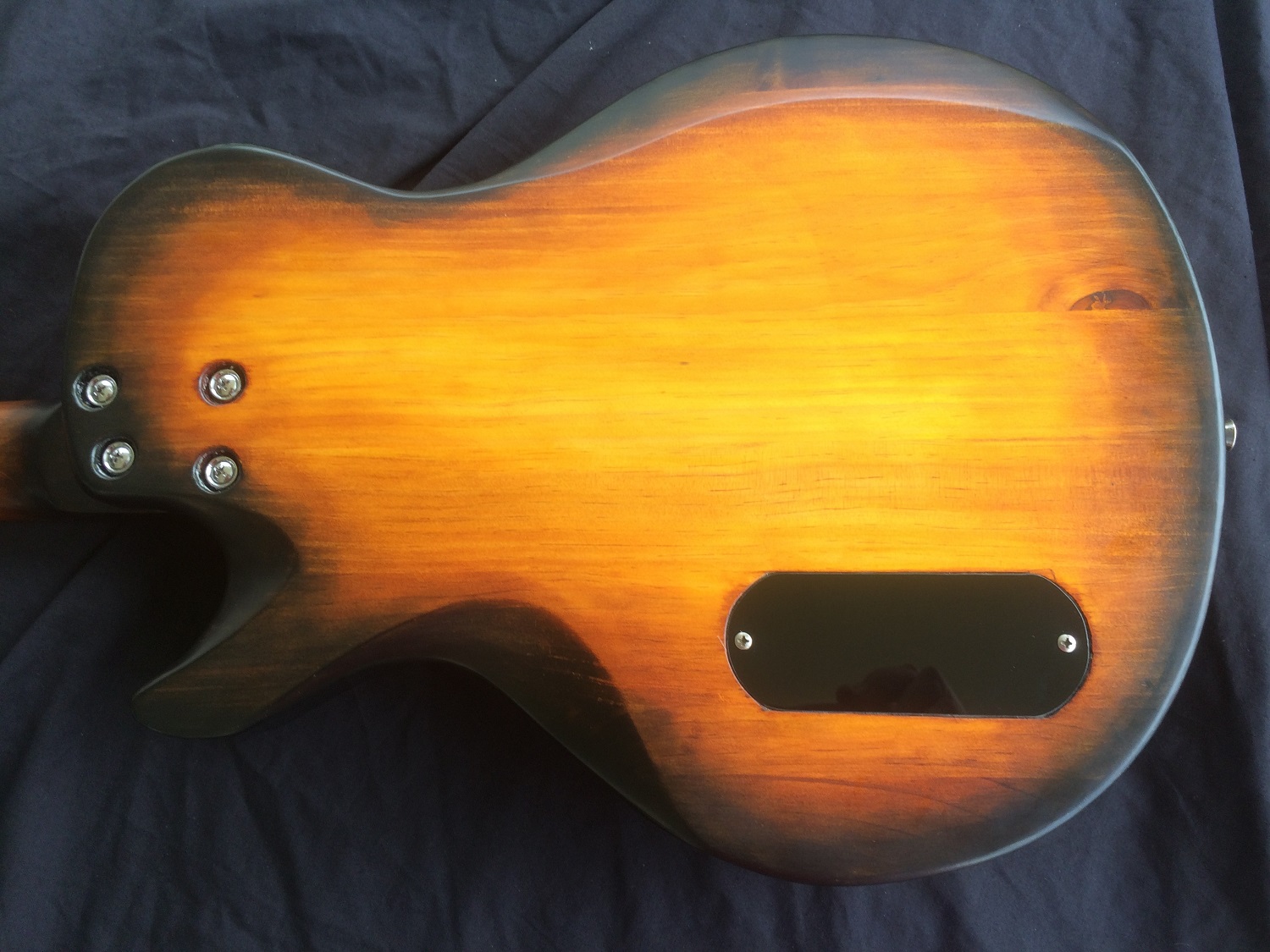

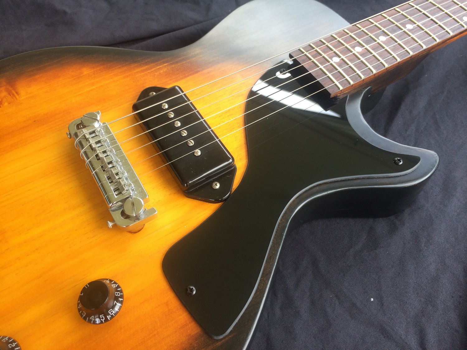

    I was aiming for an original ‘57 vibe. And I think that the Satin finish hits the mark. I know, I know, no Gibson would be seen dead with a bolt on neck, but other than spending about $20K for an original, its the closest I’m ever going to get to owning one of my all time favourite guitars.

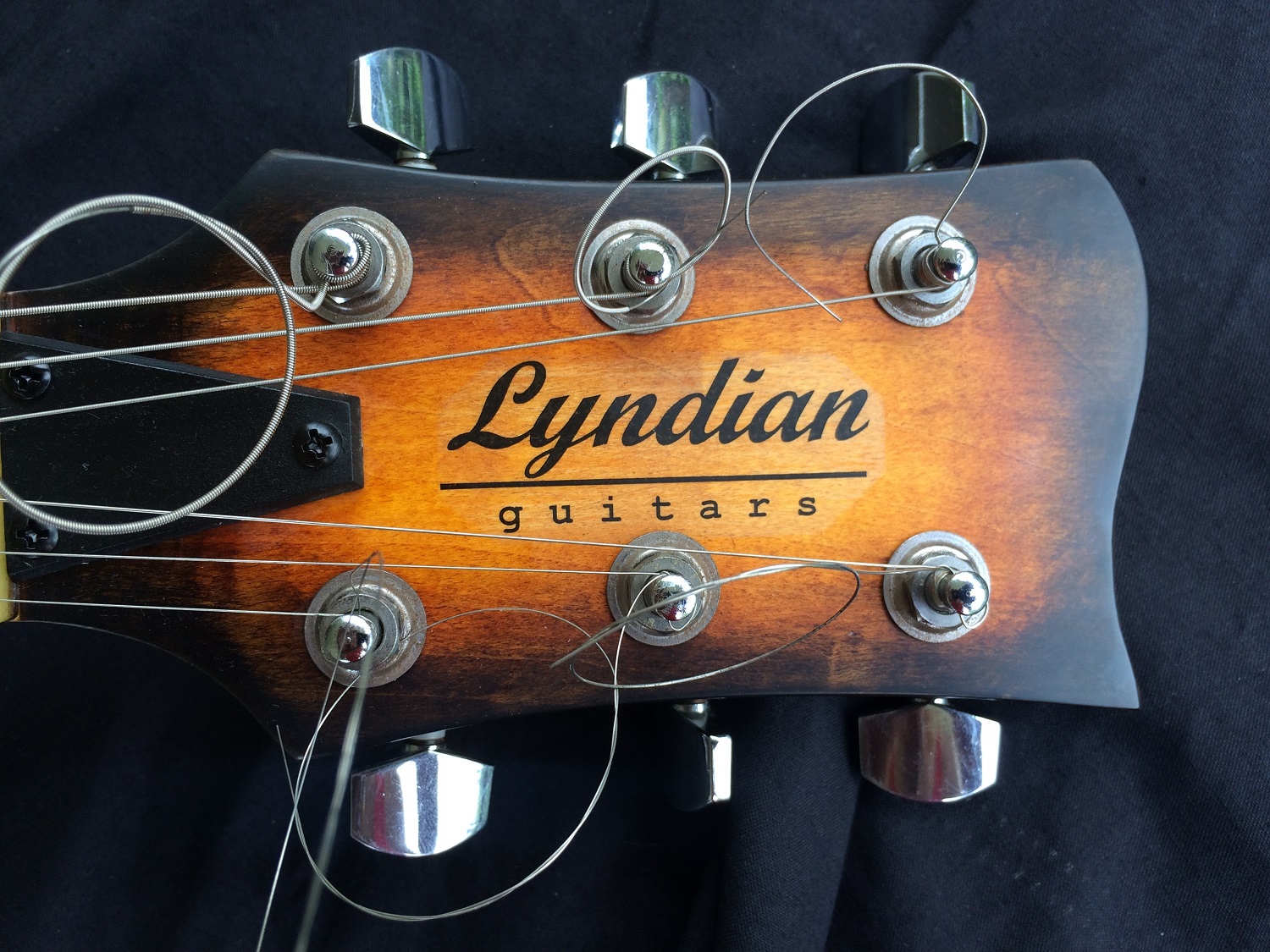

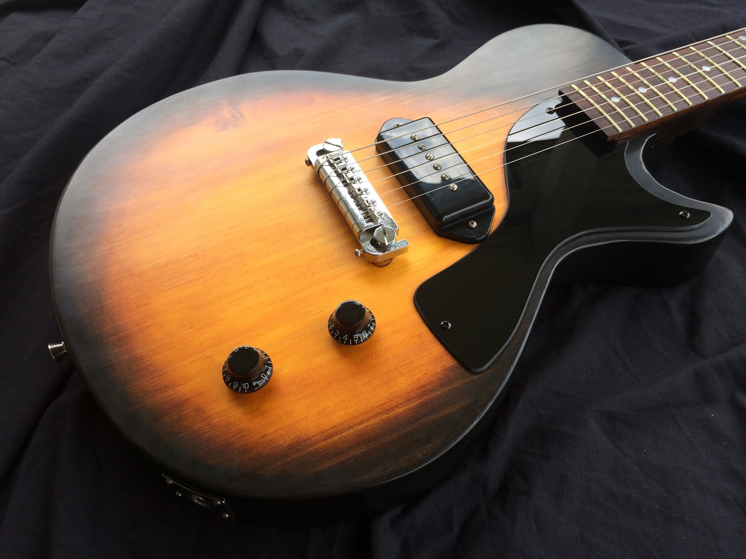

  2. #42
    Mentor robin's Avatar
    Brisbane
    1,513
    ...... a few more

    Thanks guys
    rob

    I made the mistake of gluing the shim in the neck pocket. But I was concerned that it was getting so thin that continuing to work on it could damage it. And I had put a fair few hours into it at that stage.
    Brisbane
    1,513
    @Colin
    Thanks mate. It sounds amazing. Its ended up being quite heavy so I don't know if that makes a difference but it has sustain for days. Because of it being only a single pickup I bought a good quality Lolar pickup, CTS pots and an Orange Drop cap, and used vintage 50's wiring.
    As per Lolar recommendations the Pickup is set quite close to the strings and with volume and tone on full it has a good bight, roll off the tone and it can be smokey smooth. But roll it off too much and it just turns into mud.
