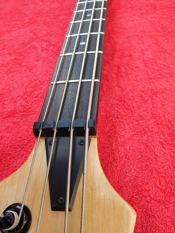

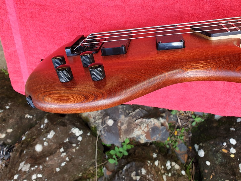

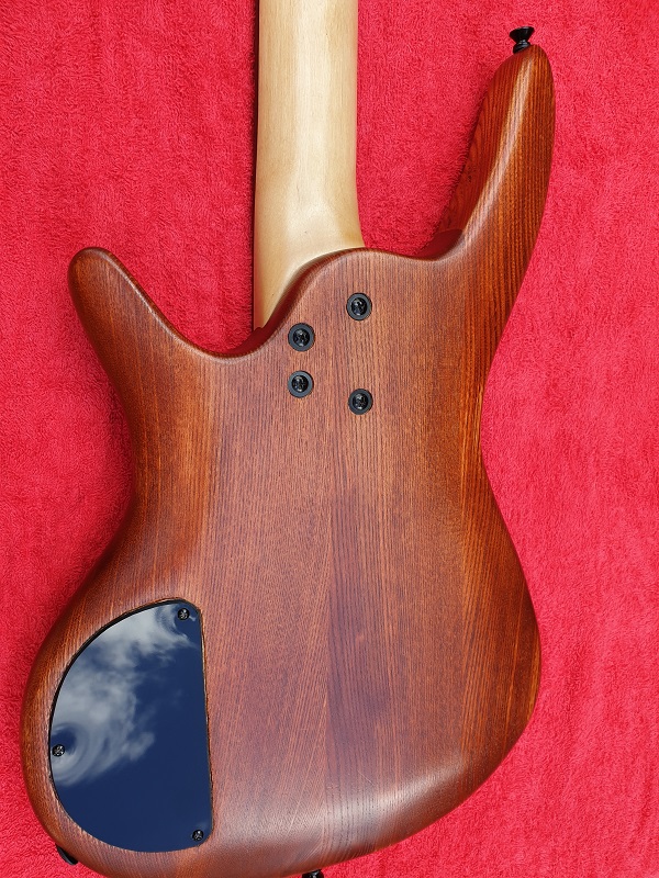

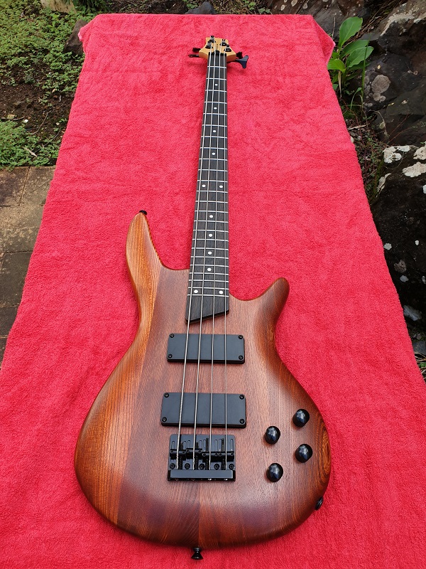

    Completely Finished.....for now....minimal upgrades.
    Today I gave this one a wipe down and the neck a coat of wax and a hand rub.
    Things I did change from the kit....
    1. The capacitors from kit to Orange Drop.
    2. The wiring diagram....I used weirdys great idea....thanks mate.
    3. The wire in the control cavity from the plastic coated stuff to cloth covered push back vintage wire.
    4. Attempted recessing of the rear control cavity cover.
    5. One business card segment under the heel of the neck to give some travel on the bridge saddles. Worked great.
    6. Sanding/grinding paint off under the bridge and in the string holes to create connectivity. This I will check on all of my guitars now. I also secured the under bridge ground wire with a piece of two side conductive copper tape, and ran a small strip opposite this wire of the same tape under the underside of the bridge. Multi meter gives a big thumbs up.
    7. Soldering a wire to one of the pots and then to the copper tape inside the control cavity.
    8. The back of the neck and body joint was rasped filed and sanded down to meet closer to the neck pocket.
    Things I may change:-
    1. The jack socket. The kit one makes a lot of noise....still. I swapped it out this morning for a normal switchcraft jack socket and quiet as a mouse. This is the worst thing about this whole build.
    2. The plastic nut. It was over 60 thousandths of an inch too tall....lots of filing to get the nut slots down.
    3. The pots....or the nature of the control cavity. The pot holes are recessed and the radius used for this is too small. I have tape under and on the lugs of the pots to stop them contacting the control cavity copper tape I fitted. So it is either a grinding with my dremel or trying a different style....perhaps longer shaft...pots.
    4. The tuning machines. The kit ones are the normal mix of good and bag...none are great...but they work. The strings appear to have settled and it does hold tune over night now.
    5. The pickups. They are fine...but really low output. I have to crank my amp a little to get the same level of sound as my other pickups. (Strangely enough they work fine in their routes without having to resort to dremel work. The bridge height and the nut height are enough to allow the pickups to have the connecting wires pass through underneath without issue. They are 2.5mm from the G string and 3 mm from the E string.)
    6. The depth of the neck. I find the neck a little too chunky for me. My perfect neck is the neck on my Yamaha TRBX 304. I have the candy red one of these.
    https://au.yamaha.com/en/products/mu...l#product-tabs
    It is thin across the nut...like a Jazz Bass...and is not deep...in fact it is nearly flat at the back and you can feel a distinct end to both curves on the side of the neck. A very flat D shape. My little fingers can find their way across the fretboard without issue. (I do wonder if I could copy this neck profile with one of those needle style gauges and try and rasp/file/sand that into this one...mmm)
    Conclusion:-
    What a great kit. I love how light the body is.....if you made some of the changes above I believe you could gig for hours with this little girl.
    The neck is 24 fret and I am having to learn where the 12th fret etc is....not a huge issues...just retraining my left arm from the fender style neck lengths.
    The body is yet another beautiful grain filled Ash wonder. The neck is actually a rosewood fingerboard with nice feel and grain in itself. The neck is a strong construction and I don't think any twisting etc is on the radar here. The headstock is pre cut into a very "I" styled shape...which I don't mind. The neck pocket was an amazing fit and it does not detract from the overall finish of the kit at all.
    The soldering can be a challenge due to the suspect jack socket and the nature of the recessed pot mounting holes. But once complete the pots are smooth in their cycle and the tones from the kit pickups are really clean. Just a little low in output.
    I like this kit and would highly recommend it to anybody. Honestly, this is a working guitar and could be used day to day to make a living.
