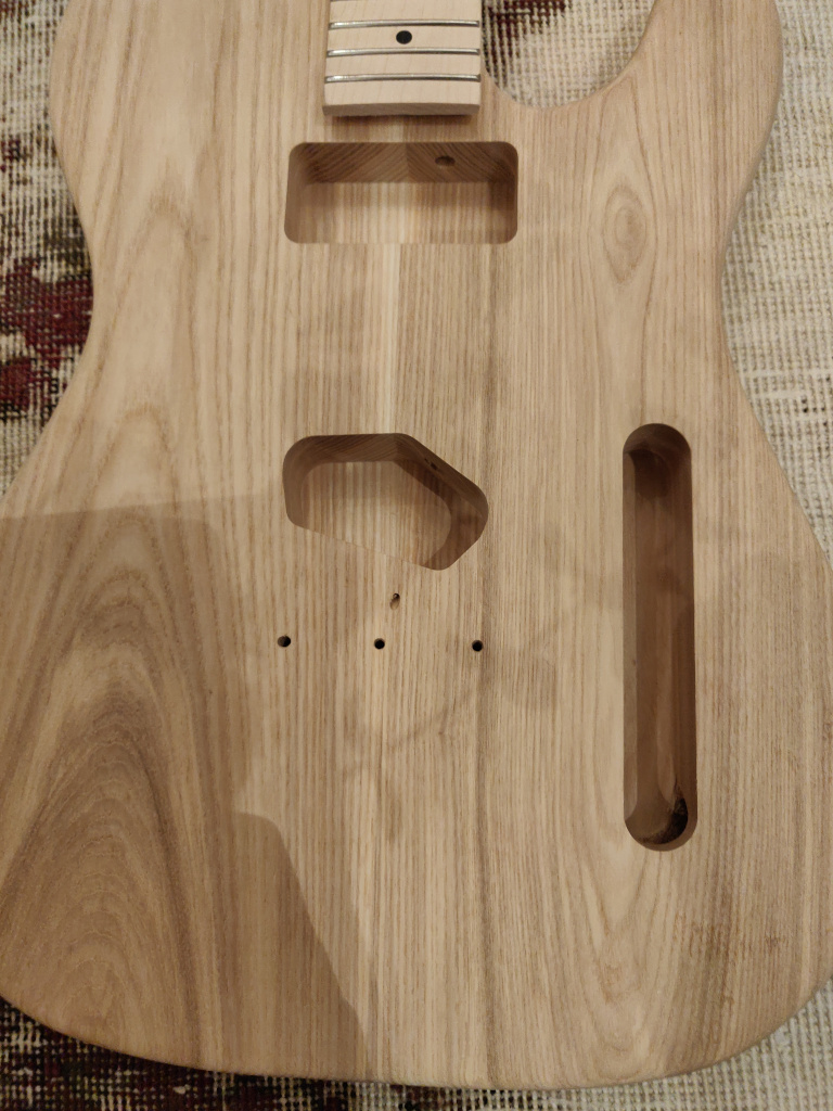

    I had less time than planned this weekend, but was able to take the measurements after a dry fit of the neck and the body. These kits have the holes for the bridge screws pre-drilled:
    Basically, the same as christodav's Purple Monster -- even down to what looks like a ding from tooling above and to the right of the centre bridge screw hole.

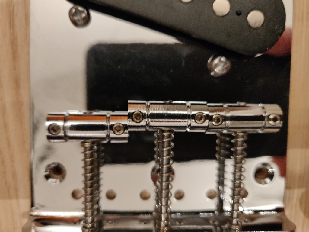

    However, in order to get 12th to the bride saddles OK, they need to be all of the way forward:

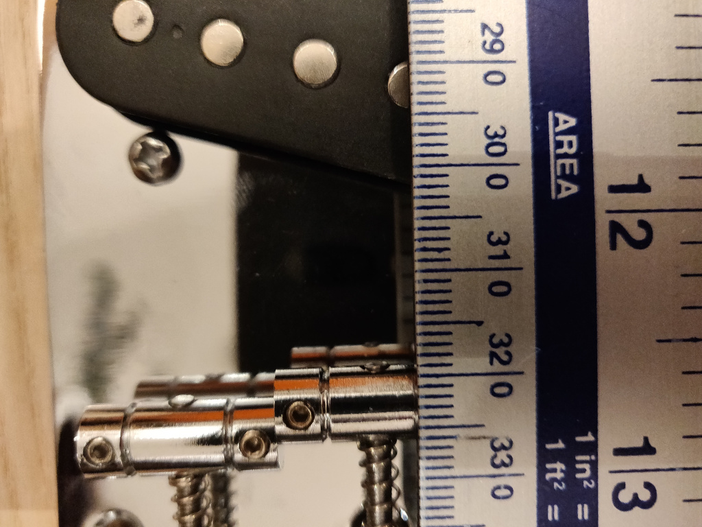

    ...that is the tips of the adjustment screws are basically flush with the saddles. Set like that, the middle and top saddles are within half a mil or so, measuring to the top of the saddle where the string will "leave" it:

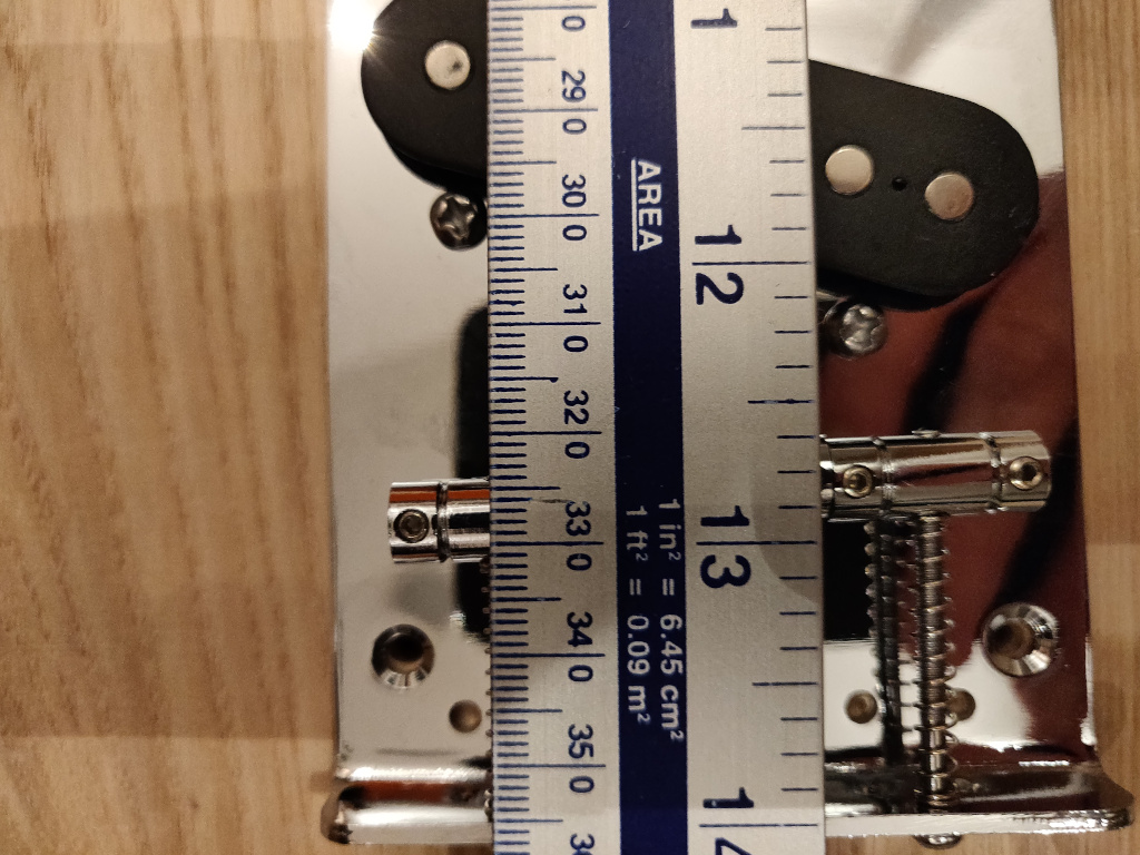

    The bass saddle has a shorter adjustment screw, though, so it's about 5mm off:
    From what Simon has said elsewhere on the forum, it sounds like that *may* be OK. All intonation adjustments, if I understand correctly, are pretty much certainly going to be moving the bridge saddles away from the nut. My only concern is whether having a starting point of 5mm back is going to be too far for the two bass strings.
  6. #46
    That's not a ding, that's the penetration (hole) for the bridge ground wire.
  7. #47
    Quote Originally Posted by gpjt View Post
    Basically, the same as even down to what looks like a ding from tooling above and to the right of the centre bridge screw hole.
    Doh! McCreed beats me to it hehe.
    cheers, Mark

  8. #48
    I'll suggest a simple, non-invasive solution might be trying a longer screw on the E/A saddle.
    I'm seeing your break point on the E/A at about 652mm, so it may be ok. The rest of the saddles look to be about the 643mm mark, which should be good. 646-649mm is where I usually find the sweet spot on those strings.
    FWIW, I find the low E generally intonates between 648 and 651, but I've seen cases where it was way more, and the saddle is backed up as far as it will go. (I've even seen (on a strat) where the back end of the saddle had to be filed shorter and the spring removed just to get the E6 to intonate!)
    The next, and probably most definitive solution, is to shift the bridge and route p/up cavity accordingly. IMO, I'd try a longer screw first.
    I'm not sure the shorter screw wasn't a mistake. I've not seen a tele bridge (especially an import) that didn't have 3 equal length screws. May be it's just what was at hand during assembly.
    EDIT: I just looked the pics in the PBG listing, and the E/A saddle screw is indeed shorter, I still think a longer one will get you where you need to be though if you're worried about it.
    D'oh indeed! I should have realised that the chances of two identical dings like that are pretty much zero
    That does make me wonder, though -- why do Tele-style bridges need a separate hole for grounding? Couldn't the ground wire to the bridge just be connected inside the pickup route? After all, it's all the same bit of metal.
    (Makes perfect sense for a Tune-o-matic bridge or similar, of course.)
