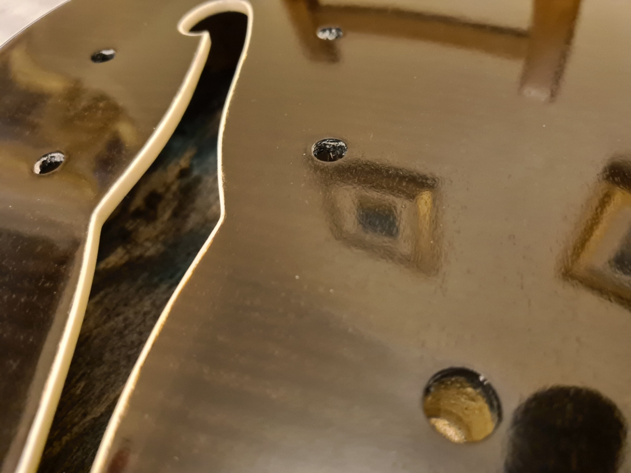

I've let the guitar for 2 months to cure. There were a few cr imperfections. So I just did a rework and final polish as there were a few uneven pits I had missed. Having experienced some expansion of the wood cap when I used water as a lubricant previously, this time I repolished it first with 1500 grit lubricated with Meguiars ultimate as a lubricant, then the same with 2000 grit and then switched to Meguars Carnauba before finally buffing. It seems to have worked a treat. Will fix neck this week hopefully.

Looks great DJP! You’ll be looking forward to get the neck on it and get strung up yeah?
Thanks. It is behaving much better than the flying V I refinished. The finish on that one cracked, and has now re-cracked months after refinishing. It looks like in the same places as far as I can tell. It is bizzare. But this time a nicer gentle "relict look" rather than major caverns. I guess sometimes you do something mixing finishes and then something happens down the line. I had hoped I had completely fixed it though.

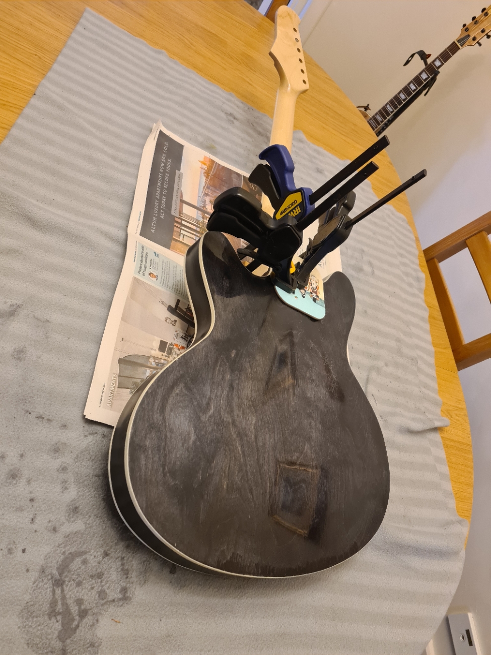

Anyone know exactly what the woodglue that came with the Pibull kit is and how longbI should leave guitar clamped ?

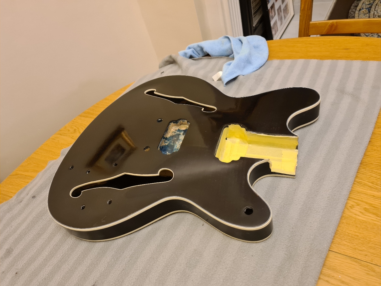

Here is the back after the refinishing. A few minor cosmetic fixes at neck joint to do before harware goes on and wiring. On the previous photo you can see where the binding was broken near the neck pocket (in kit when received). It is now firmly reattached and embedded in nitro. But the crack is visible so I will probably scrape back a little see if I can hide somehow.
