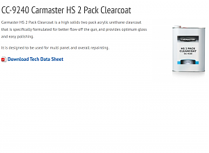

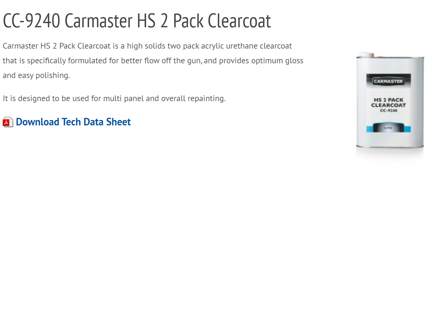

    I used the Protec High Solids Top Coat clear. After I finished the final coat, I put it under heat lamps in an enclosed space to "bake" it for an hour or so. When I woke up this morning and put a fingernail to it, it was good to go. I wet sanded with 1000, 1500 and 2000 and then used the Juice Cut compound to buff it up. I started on the back because I also thought it might be a bit soft and go cloudy, but it was all good. Made my weekend, because patience isn't always my strong point.
    This is the one
  10. #39
    So a 2K product. I understand now. You're obviously set up with the full breathing apparatus at home.
  11. #40
    Member andybanks's Avatar
    Aug 2021
    Just Outside Sydney
    66
    Yep, I wouldn't recommend doing this without a decent respirator.
