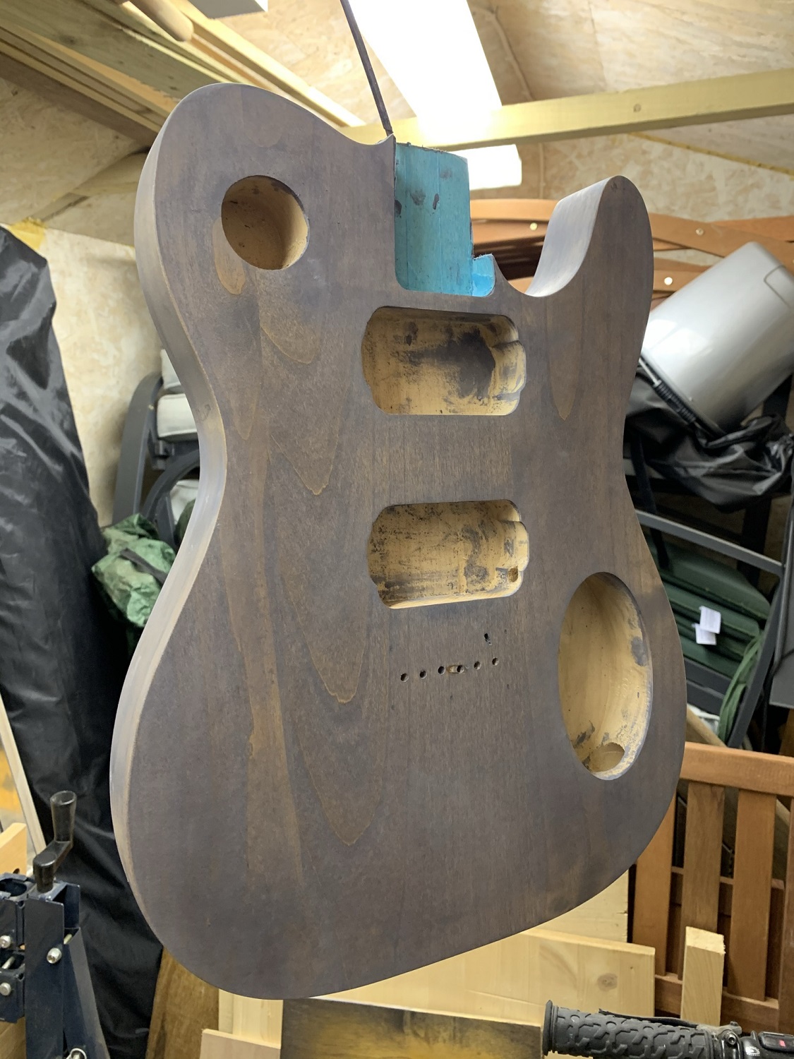

    Yeah - it's all so complicated! I've decided to start experimenting on scrap to see what happens - I dont have any ash so I'm just using a piece of ply that has some interesting grain to work with. I know that different wood species will have different results - but as I've not done any finishing before I just wanted to try something.
    But yesterday was all about sanding. I used a rand-o sander on the top and back, started with P180 and went to P240. That took all of about 20mins (should it have taken longer?). I then spent the best part of day working the sides by hand. Either I had crappy sandpaper or my technique is rubbish - but I just seemed to go in circles, from something approaching clean looking to a bit of a scratchy mess. But I think I eventually learned to generally move in the direction of the grain, and that end grain is a pain in the arse. But I think I have it something approaching P240 all over and I'm okay with it. It feels smooth "enough" (is it?) so I'm going to use this as a starting point for finish.
    Today I sanded up my ply scrap to 240 and messed about with some grain filler - just to get some experiance mixing and filling. Tomorrow I'll sanding it back and see how what happens. My idea was to see what would happen with neat grain filler (bottom right), a mix of filler and stain (top right) and neat stain (top left) which I could then fill... let's see what happens....

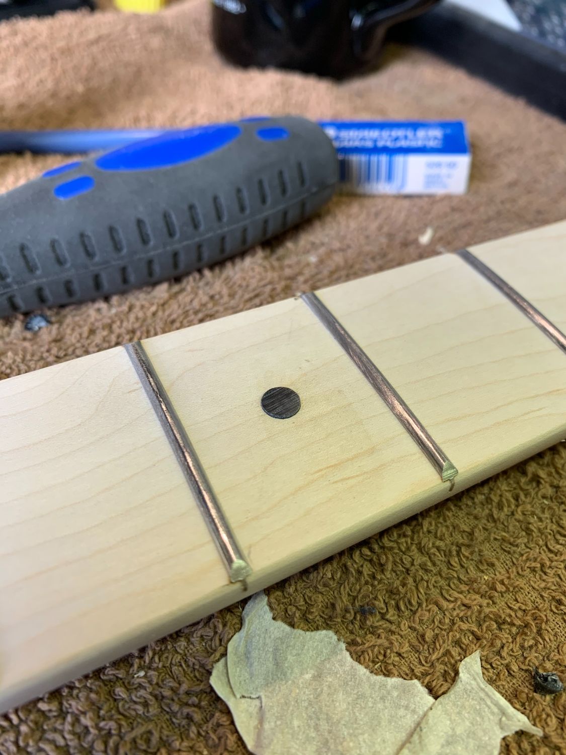

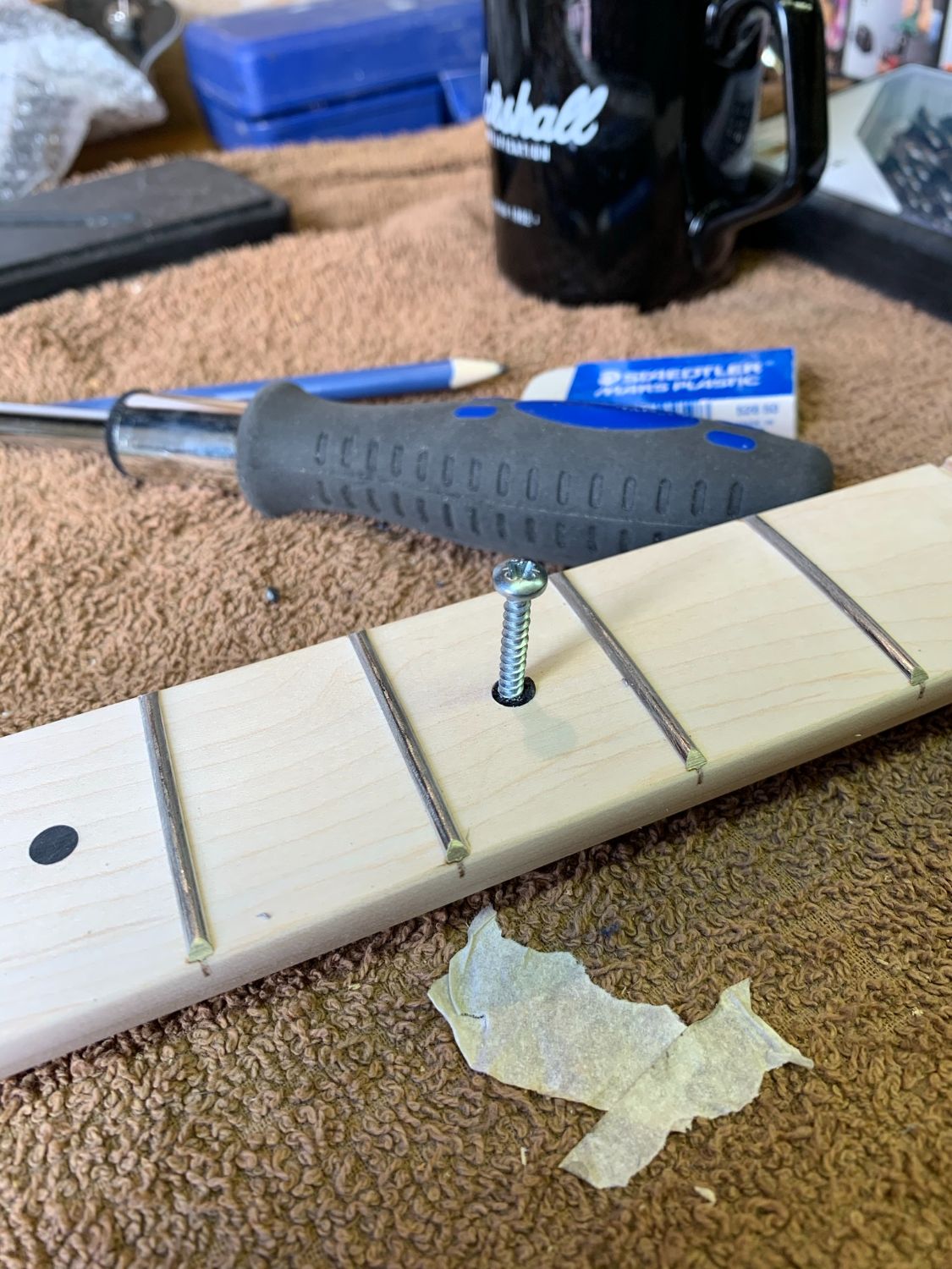

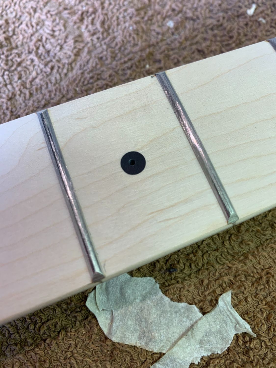

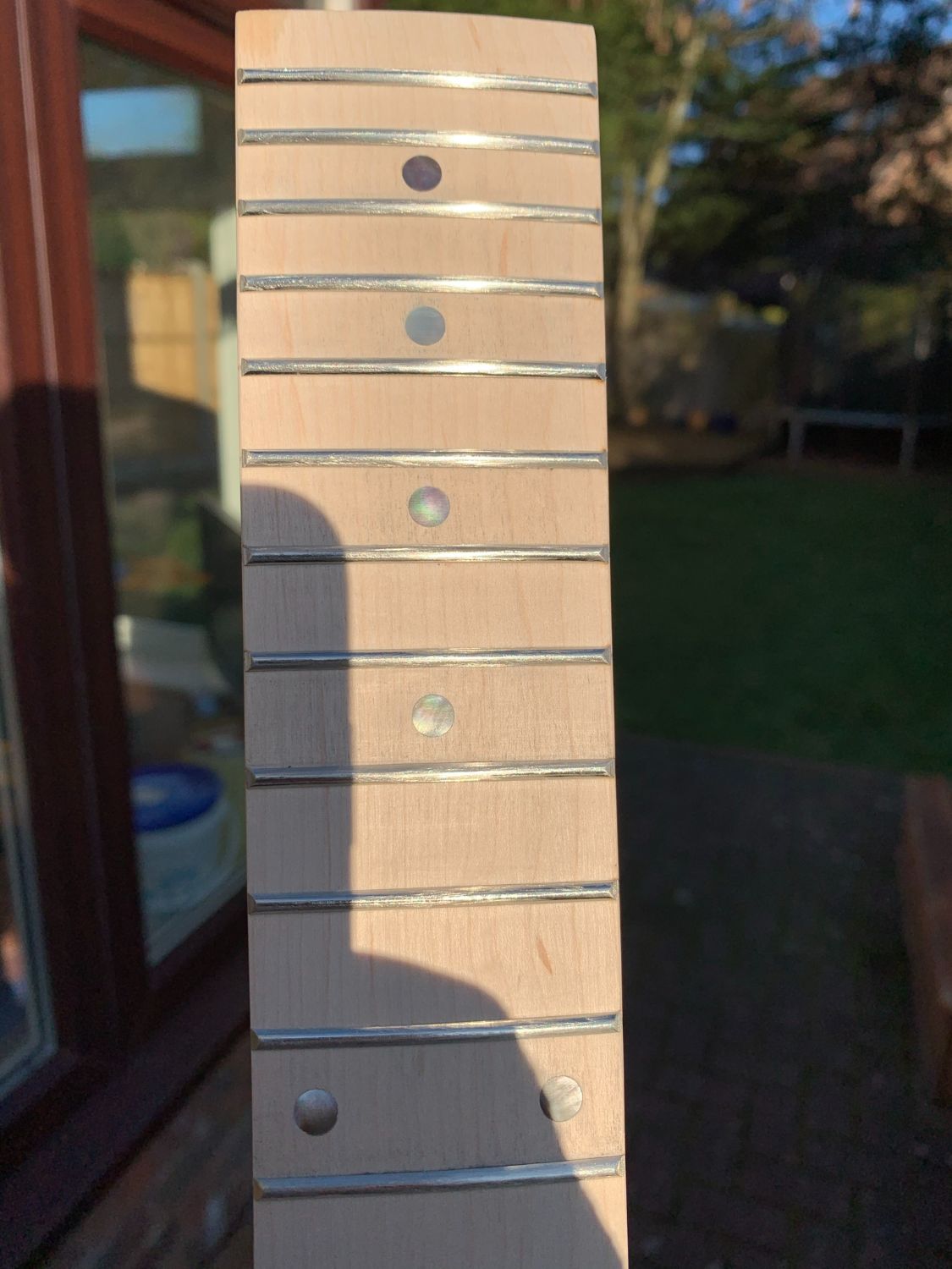

    While the grain filler experiment dried I thought I'd have a go at replacing the plastic dot inlays with some black mother of pearl. Originally, I thought the plastic dots were drawn on but I was quickly educated (by you guys in the mod forum) that they are indeed plastic. The graining I could see was sanding marks. Anyway, it was too late, the MOP dots were ordered and when they arrived they looked so nice against the maple, I could not resist trying to put them in.
    This was a scary thought. The only place I had plastic dots to practice on was in the neck - so in otherwords - there was no practice - I just had to get on with it. After a lot of YouTubing and listening to the advice in the mods thread I took the plunge.
    My process:
    First drill a 2mm hole in the plastic dot.
    Then drive a largish screw into the hole.
    Using a cloth to gently but firmly wiggle the screw until the plastic started to crack. Sometimes after a twist the dot would come out cleanly. But most of the time it would come out in chunks. Often I had to re-drive the screw and wiggle some more. Eventually around half of the plastic came out and that was enough to use the end of the screw to pick at the remaining pieces.
    The trick is not to use the edge of the hole to lever out the pieces - perhaps that's obvious - anyway I managed to forget that on the last hole and slightly marred the board with screw thread. I used some maple saw dust and super glue to fix that.
    Now I had a nice clean hole.
    Then it was just a case of flooding the bottom of hole with super glue. I used the nozzle of the glue bottle to ensure the glue coated the sides of the hole. But the MOP dots were a nice tight fit. I used a small length of dowel and a hammer to tap them in so they were just proud of the surface.
    To make the dots flush I followed the steps in the Pitbull vid. Starting with a flat needle file to remove most of the meat and then P320, P400 and P600 sandpaper until they were flush and shiny.
    I'm really pleased with how this turned out - it could have been a disaster, but I think all the advice I received in the other thread and the YT vids really made it quite straight forward. Like most things - not rushing and taking plenty of time is the key.
    One thing you can see in the vid - either my crappo sandpaper or the MOP dust has made the grain in the maple quite dirty. I've tried cleaning the board with a first a damp cloth, then some tack cloth followed by white spirit - but nothing seems to shift it very well. I also tried some P600 sandpaper and that helped a little but not perfect. If anyone has some ideas on how to get this out, I'd be grateful!

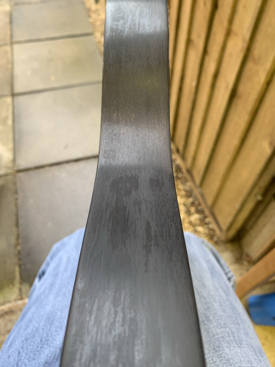

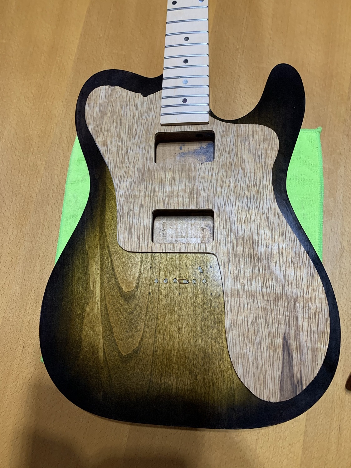

    Grain filled this evening... but not sure I've done it right. My idea was to mix in black stain with the grain filler to emphasise the gain lines and depth. However, I couldn't get a good consistency - it was way too loose and not black enough.
    My idea was to do a black to yellow fade so I'm worried that the grain filler against the black is going to look grey.
    I think the problem is the black is water based stain whilst the grain filler is oil based, so I don't think it's mixed very well - I should have got acrylic.
    I guess I'll see how it sands back - they grey might look cool against the black? #happyaccident #wishfulthinking
