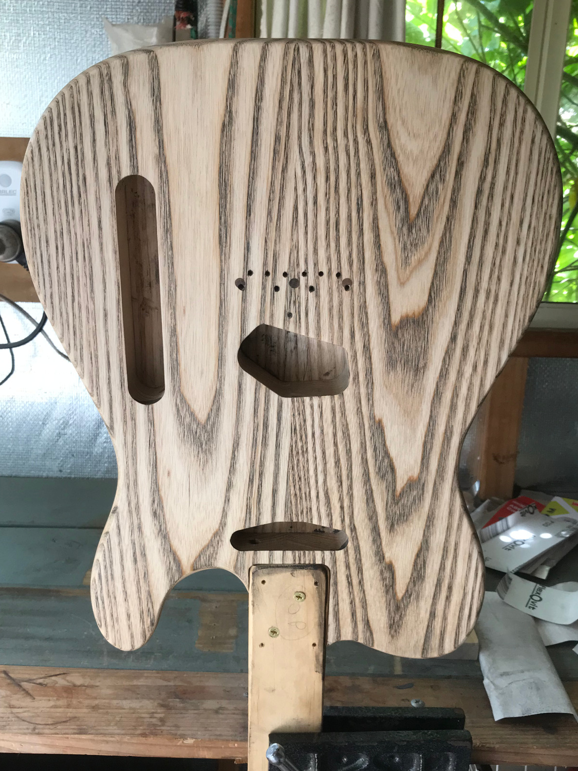

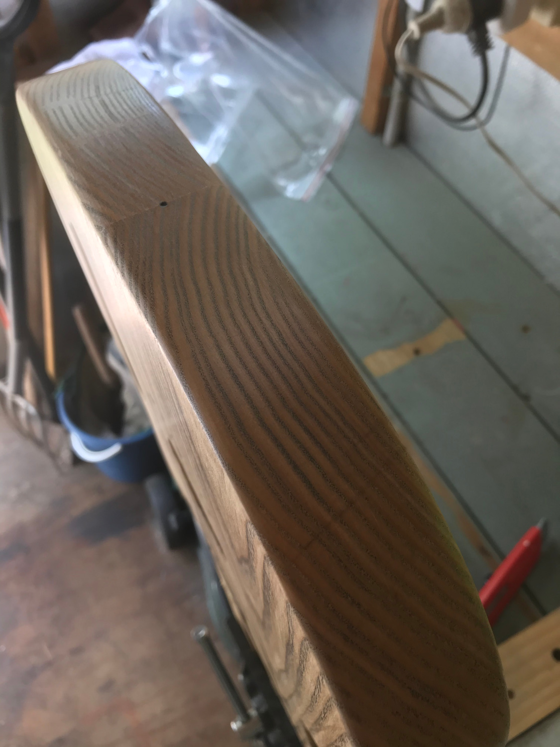

    I've had a bit of a revelation over the last couple of days.
    I had been really struggling to get a clean look with grain filler used to fill the pores on the end grain (and all around the edges.) I'd fill it, and then be sanding for hours to try to get rid of muddiness, by which time there would be no filler left at all.
    I did a bit of reading, and found that people recommend spraying a coat of clear before the filler, to seal the smaller pores, so I gave that a go. I used the clear rather than sanding sealer as I wanted the film to be as thin as possible. I left that to dry over night, and then filled with a timbermate slurry as normal, and then left that to dry overnight before sanding. The result was really good - it was much easier to sand back, especially around the edges. I've now sprayed a coat of sanding sealer, and here's how it looks.

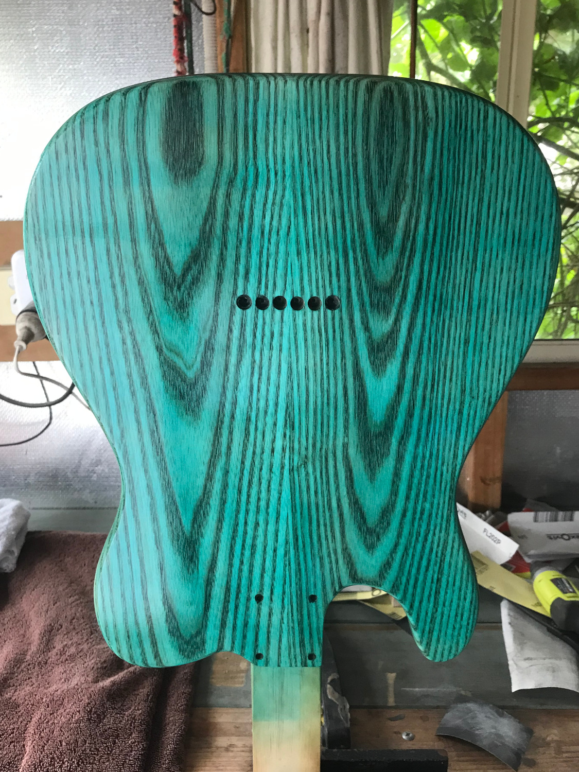

    Thanks DM. I've since sprayed a can of transparent blue, which has reminded my how bad at spray painting I am. Unfortunately I had the nozzle oriented incorrectly on the first coat, so I've got some banding going on. I also had quite a few runs, but they have mostly sanded out. This wasn't the colour I had in mind - it's rather more green than I had expected. I shall get another can of colour, and hopefully it will darken up and even out.

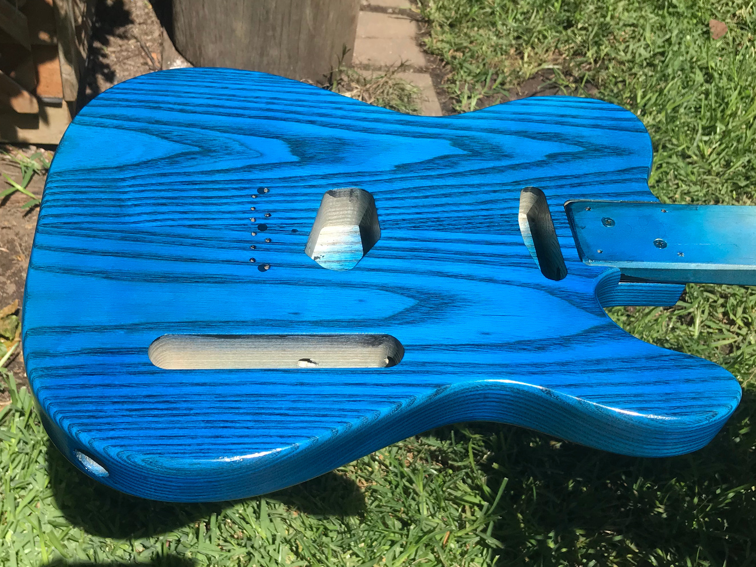

    Here it as after the second can of blue nitro. I think my technique must have improved, as this seemed to go on much better, i.e. quickly made a big difference to the depth of the colour.

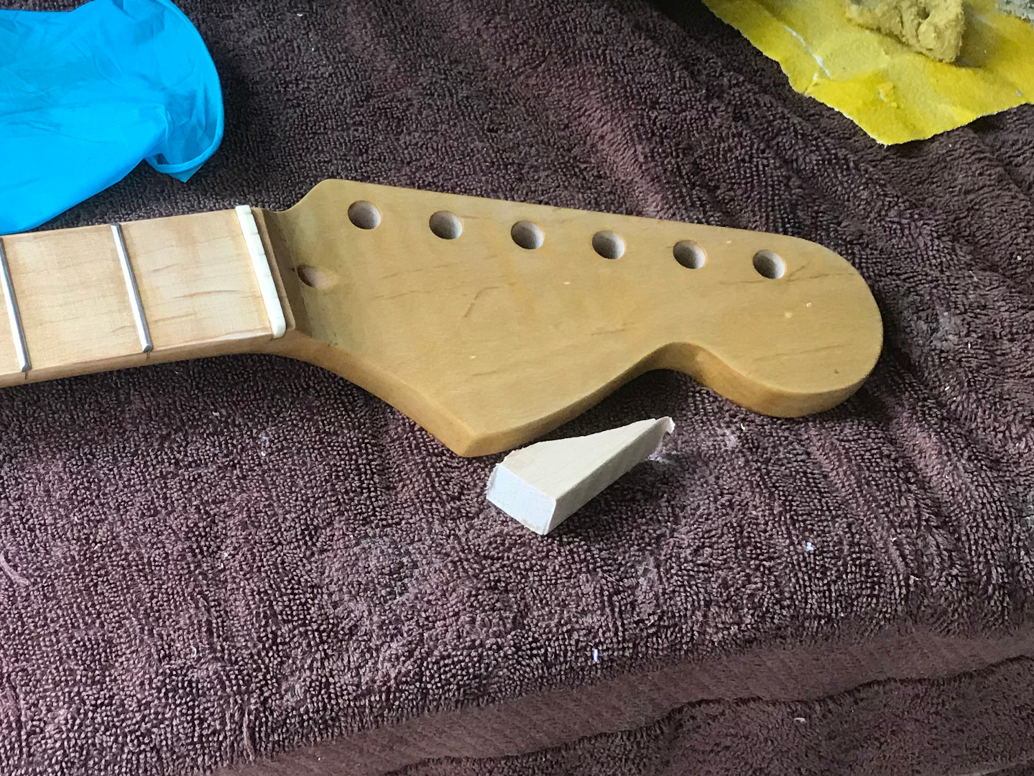

    In the meantime, I've also shaped the headstock, stained the neck with dilute FW Golden Teak, and applied a couple of coats of Tru Oil. There's a natural maple offcuts there for comparison of the colour.
