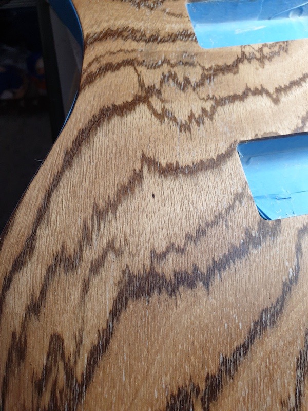

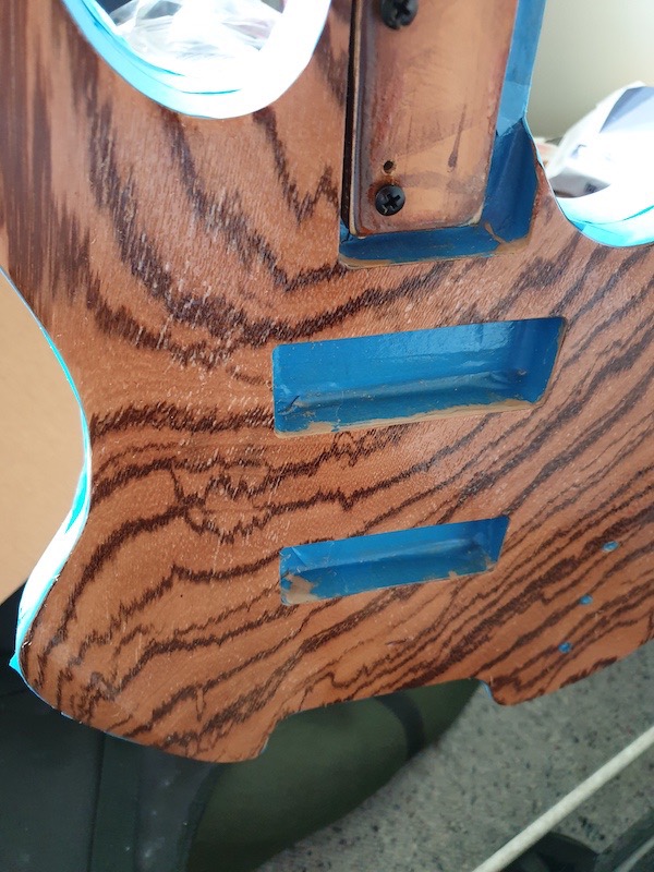

    This morning.
    This is what I found this morning....

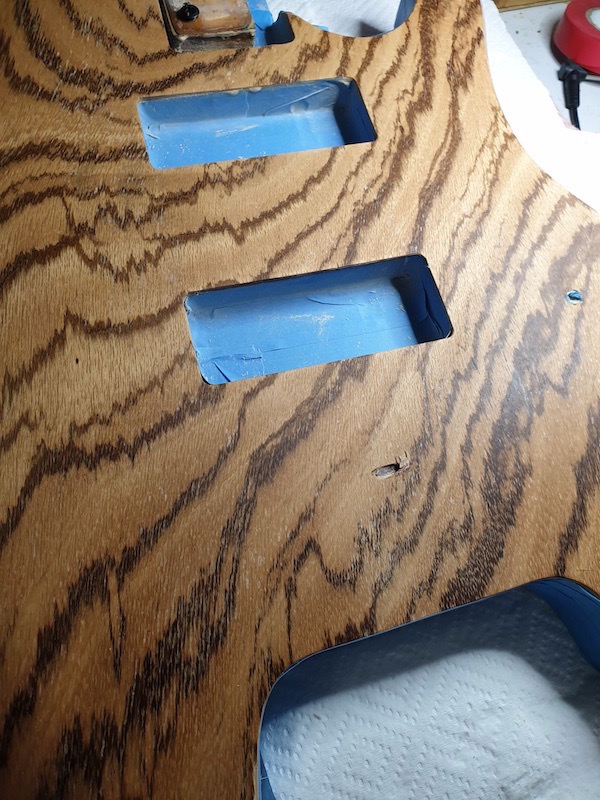

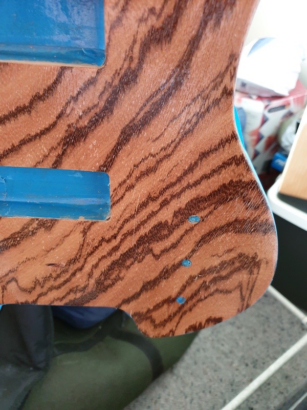

    Then a wipe down with acetone in preparation for the spray poly.
    Not so sure about this....I can still see the glue/sealer/junk in the pores.

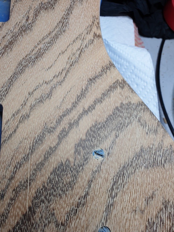

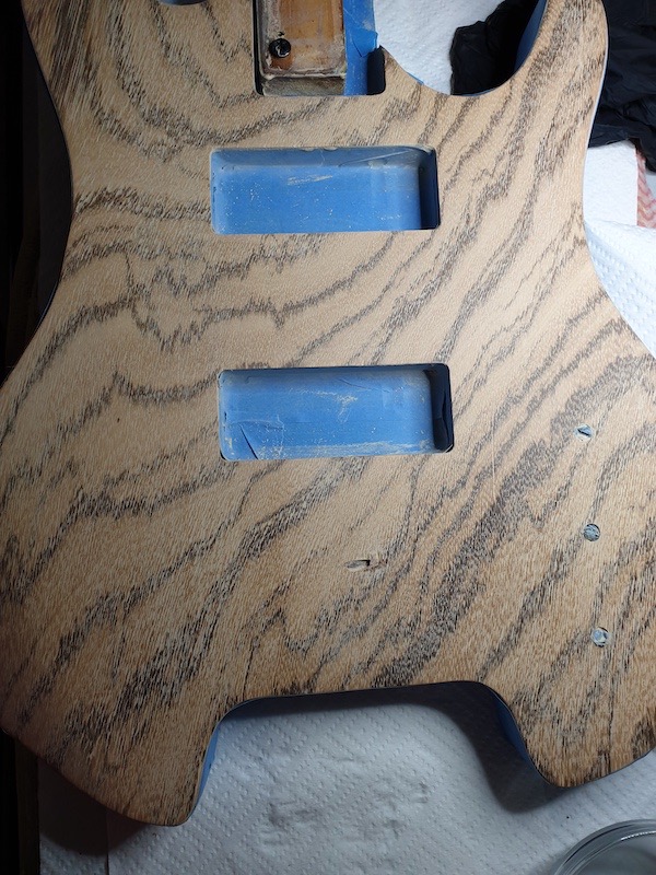

    The poly has now been sprayed in three coats with ten minutes between each.
    The finish is starting to shine already....but many many holes remain....lots of clear coat and lots of sanding flat to fill this I think.
    But I can still see that white muck.....it is nearly lost in the pores....but still there.
