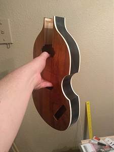

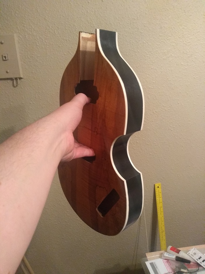

    I still need to finish the body, but I scraped the binding this weekend and it really pop now! I scraped a little into some of the stain, so I touched that up, which now requires more scraping. I said a few choice four letter words, but overall it won't be much more work, and scraping is oddly soothing for me.

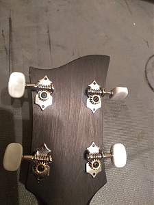

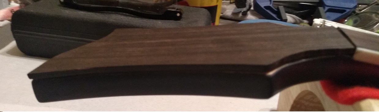

    Another first for me on this build is adding a veneer to the headstock. I didn't have any luck finding any spalted maple veneers, but I got my hands on some beautiful ebony. My plan is to darken it to match the rest of the neck/headstock. I have a questions about the veneer though. It's just short of 3.5mm thick, which seems thick to me. What would be a good thickness to aim for? The posts on the tuners are not very tall, so I don't want to add much more density to the headstock. Below are a couple pictures for reference, thanks in advance for any advice!

  7. #37
    You really want the thin veneer, that’s between 0.6 and 0.8mm thick. 3.5mm is far too thick without sanding most of it away to that sort of thickness or you will have trouble with tuner post height. Adding a 0.8mm fibreboard veneer with paint and clear coat on top on my two SG and my ES-1 builds only left the bare minimum of post below the hole showing with the vintage Kluson tuners I fitted on them, barely enough to get 2 wraps on my bottom E strings.
    If you can’t find anything thinner that’s suitable, then I’d stick the ebony on and after clamping and leaving overnight, trim it back to the headstock shape and then sand it down until it is the right thickness. I think it will be much easier to sand in place than on its own as a sheet.

    Thanks for the advice Simon! That was my thought as well, that it was way too thick. I recently bought a small hand plane, that may work better than sanding. My thought, if I get the courage to do so, is to add a bevel to the edge of the veneer. Would that be best done while it is still thick, and then sand/plane down once the bevel is created?
    I also appreciate the advice on gluing it first, the only other approach I could think was from Crimson Guitars to attach masking tape to my table and back of the veneer, then super glue to tape together. I somehow managed to get a weekend off work, so I hope to make some real headway and hopefully be able to attach the neck and body next week!

    Thanks DarkMark for the advice! Luckily, due to some dowel gluing errors on my part, there was enough of a divot already created to use as a guide for the marks like you showed in your previous build diary. Got it all set and glued in.
    I have added some pictures of my current status on the neck. After a fit test on the neck to see how the black looks, I learned I wasn't as crazy about the front headstock being black as I thought I would be. I think it would look better if it matched the color of the front of the body, but I can live with it. To help add some color, I bought a brass nut and cut a new truss rod cover out of pearloid material to contrast the black headstock and match the pickguard/control panel. There is a black spot on the front that looks different than the rest, but I think that should go away with another coat or two.
    On the backside you can still see the dowels that I used to plug the original tuner holes, but I took a picture with the new tuners in place to show it's not quite as obvious once they're in place. Sorry for the bad picture taking, my phone is terrible and I was really tired haha.
