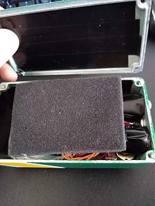

    I don't have an ideal solution yet. I first tried using hook and loop tape from my pedal board. Loop tape inside the lid, hook tape on the solder pads of the board, but the tape adhesive wouldn't stick to the board.
    So right now I am lining the inside of the enclosure with electrical tape, lining the exposed pots and any other potential shorts, then just resting the board inside the case with some foam padding between the board and the lid. The tension of the wires seems to hold it in place, nested into the foam.

    It's early days, but so far this is working. My pedals just stay on my board and don't moved around. If you planned on gigging with them, something more robust might be called for. I have seen others use hot glue to fix the board to the insulated case. Or you could use these. I got some in the Julius kit, but they should work with vero builds as well.

    I've used those stand offs before but not much success on getting them to stick on the inside of the enclosure for any period of time. the foam looks like a better option than electrical tape.
