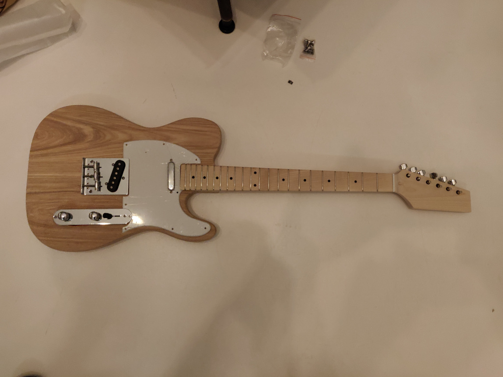

    Not much time this evening, but I was able to unbox it and try a very rough dry fit:
    Lovely grain pattern on the body, and while the neck is less heavily figured, I suspect it'll come up nicely with a bit of oil.

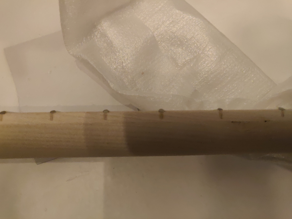

    The way the flat part of the fret wire is visible here looks a little ugly, I think because it's so similar to the colour of the wood -- the same effect on the black fretboard of my LPJ looks fine. Probably won't be a problem when I've oiled the fretboard.

    The way the flat part of the fret wire is visible here looks a little ugly...
    Yes, the colour matching is not the greatest I've seen, however, I think (not real clear in the pic) that a lot of it is excess filler on either side of the fret slot on top of the neck wood.
    Once you hit it with some light sanding, only the fret slot should have the filler left in it and will be way less noticeable.
    Regarding fret dressing:
    With a maple/maple neck, I would recommend not doing any fret levelling until you have got your finish on there.
    When you apply your finish, it will be going right over the frets and will need to be removed. Best to do the finish removal and levelling/dressing at the same time. Otherwise, you may risk scratching a newly levelled & polished fret when cleaning off the finish.

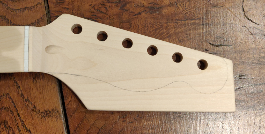

    Thinking about the headstock. Here's the shape I'm planning -- a fairly classic T-style, I think:
    I do keep my guitars hanging on the wall, so I'm a little uncertain about the "flat" treble side, but the Hercules hangers I've got do swivel, and the Internet tells me that should make it all fine. And who am I to doubt the wisdom of the Internet

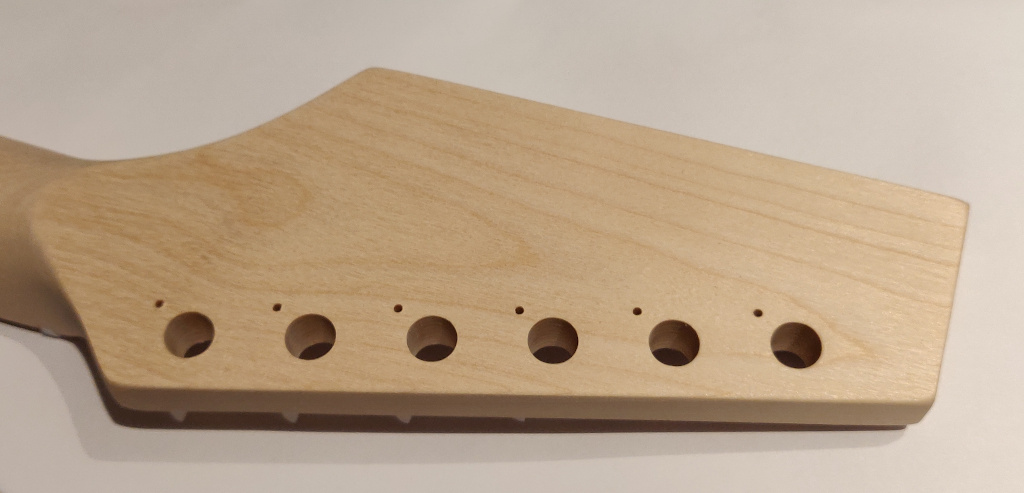

    Unfortunately the headstock already has guide holes drilled for the screws for the stock tuners, and they're offset to the treble side of the holes for the tuners:
    So I'll have to work out some way to fill them that won't be too obvious. Once I've cut the excess from the headstock, there will be a good amount of matching maple to use, so perhaps I can use some of that as plugs, then fill any gaps around the edge with sanding dust and glue. Not sure what glue to use if I don't want to stop the finish from adhering, but if the worst comes to the worst, the tuners come with a mounting plate that could be used to hide a multitude of sins...
