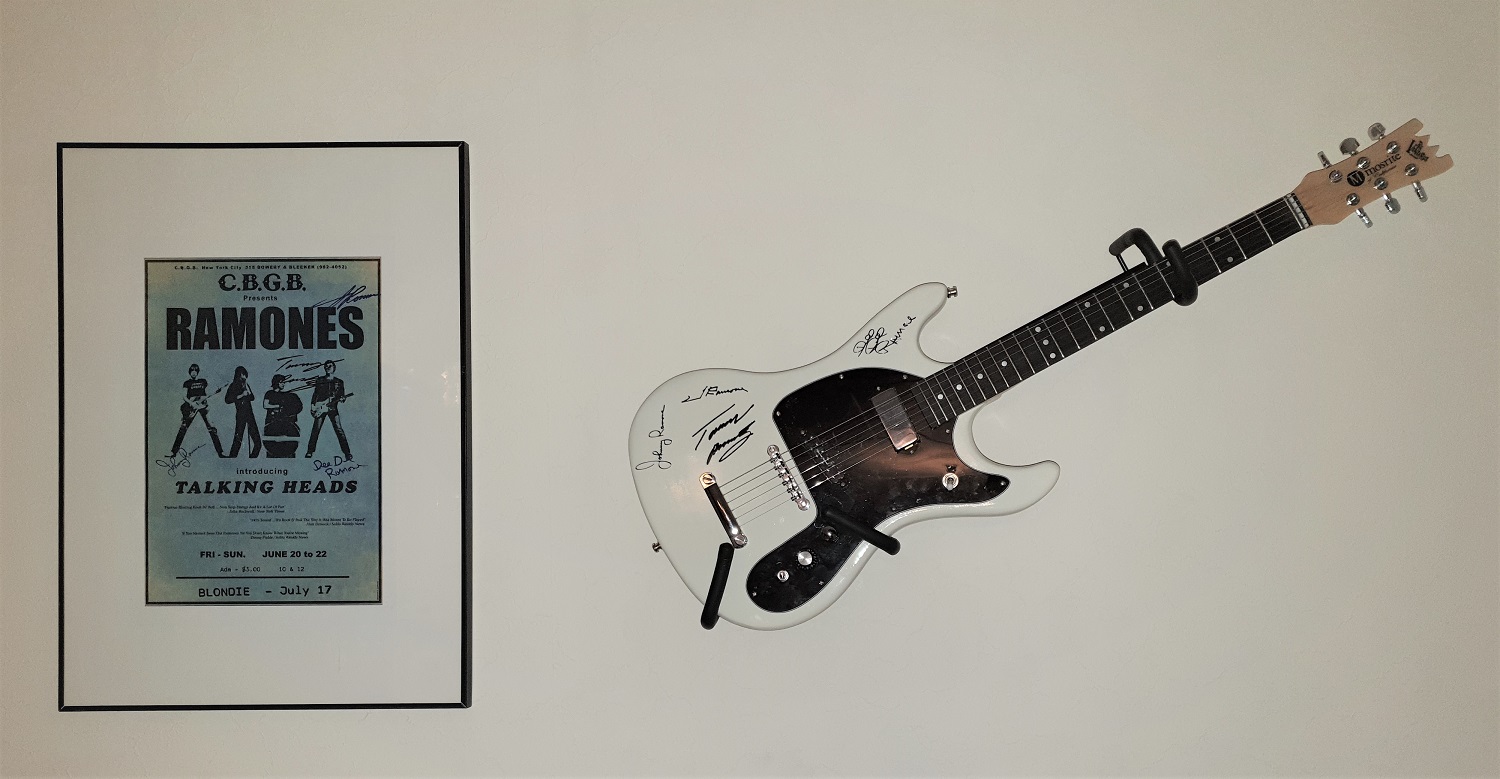

    I started this project about 6 months ago and my intention was to build THE Ramones tribute guitar.
    Ramones has been my all time favourites and the white Mosrite that Johnny played is my dream guitar.
    I ordered the Pitbull MKA-2 (Ash) with a paddle head as my intention is top copy the iconic, narrow, Mosrite Ventures II slab body head.
    As a sidenote, MKA-2 is made of Ash and MK-2 is made of Basswod. The real guitar that Johnny used was made of Basswood so there is no need to buy the more expensive Ash-kit IF your goal is a as similar guitar as possible (the basswod kit was not in stock when I ordered).
    My mods:
    Change the bridge pickup to Dimarzio FS-1 (will start with a Seymour Duncan little 59 as I do have that at home already).
    Move the stop bar to match how Johnny had it on his guitar.
    Reshape the "paddle head" to something as close as possible to the real Mosrite Ventures II head.
    Shim the neck a tiny bit to tilt it "backwards".
    Change the plastic "pre-nut"/string guide (these kits has zero fret that do not work as intended with the provided nut) to a brass nut that I will file to get deeper grooves.
    Change the Tone control hat to a tone knob from a Gibson SG (as Johnny had on his).
    Another side note, I started this project 6 months ago and when doing research on the Johnny guitar I came in contact with a guitar builder in Virgina US and that ended up with me ordering a "Mosrite" from him as well. I have not received that guitar yet but judging from the pictures of the build it is really, really something super special! IF you dream of a guitar with the real Mosrite specs, contact Aron at Alderite guitars. He is very dedicated to guitars in general and a true fanatic about Mosrites...
