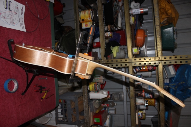

    Hi Paolo . The wiring problem is now sorted. I ordered new pots online then got heavier gauge wire. Everything went like a dream including fitting the whole lot into the body of the guitar. All tested & no apparent buzz. I realise now after 3 builds that the wire supplied with these kits is really Sh...t! Much too thin & I cannot perceive any appreciable difference when using speaker wire from my local audio electronics store. Anyway the proof will be when I finally get it all together & play it. Meanwhile I have just glued the neck into the body & will give it a few days before proceeding. Good luck with your build too!
  4. #24
    May 2016
    Albany WA
    61
    Hey BuffaloGhost, hope you got the wiring sorted out to your satisfaction. I just got all of my wiring installed this morning after waiting for a set of new pots to arrive. I used speaker wire from my local electronics store instead of that thin stuff which is supplied with the kit. I bound the cables in shrink tube where necessary & used poly tubing to feed the pots through the holes. I tested it prior to installation & everything seemed fine & dandy to me. I have just glued the neck to the body so now I will wait a few days before proceeding.

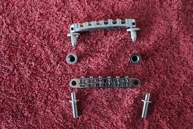

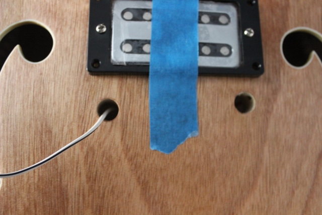

    Pictures of problem fitting roller bridge to existing holes drilled for saddle bridge.
    Holes in guitar body are 11.77mm diameter. Pic #1 The inserts for these holes are ok.
    I must insert the knurled peg from roller bridge into the threaded part of supplied bridge insert but the hole is slightly larger than the knurled part of the roller bridge peg. I theorise that I will have to put thread seal tape around the diameter of the roller bridge pegs to allow me a tight fit without the whole bridge rocking backwards & forwards thus creating tuning problems.

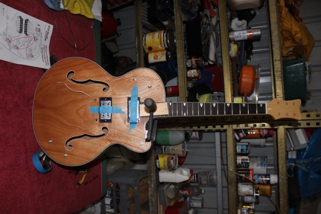

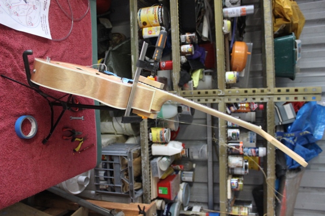

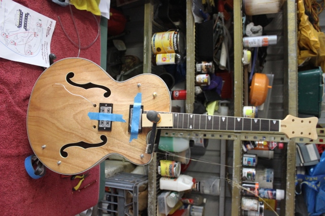

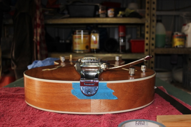

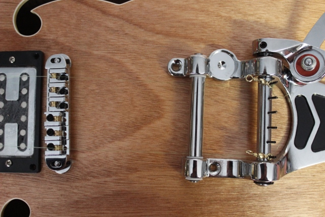

    I finally got the 'Bigsby' lookalike installed together with the roller bridge. I used fishing line to get everything aligned to check clearances etc. The roller bridge will need some further attention during the intonation stage but so far so good. The only thing I cannot work out is how the front of the 'Bigsby' is attached? Screws?? There doesn't seem to be much 'meat' (thickness) on the body to just have screws through less than 3mm of wood. Any suggestions from the wise ones out there?

    Pictures of problem ... I theorise that I will have to put thread seal tape around the diameter of the roller bridge pegs to allow me a tight fit without the whole bridge rocking backwards & forwards thus creating tuning problems.
    Have you researched whether there is another roller bridge with the correct diameter parts? I'm sure it's out there.
