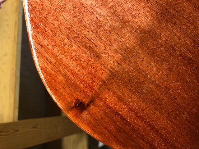

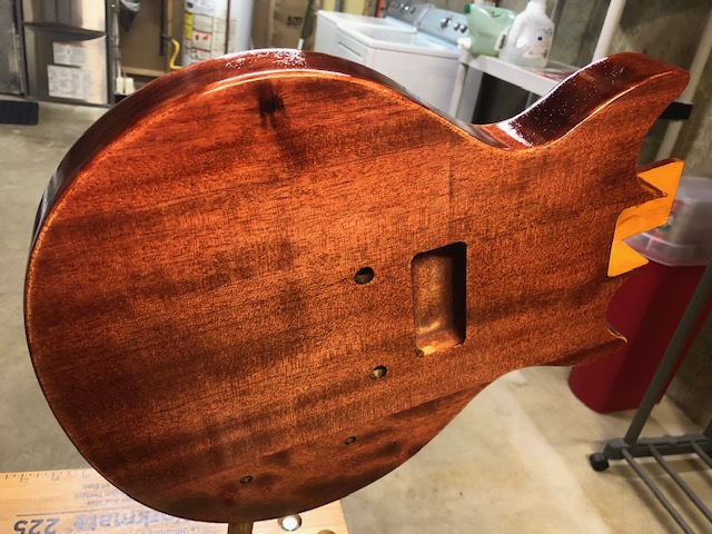

    Today Photos after 8th coat of oil and 2nd wool session
    It is begining to look deep enough1
    Mahogany requires a lot of oil to fill the grain

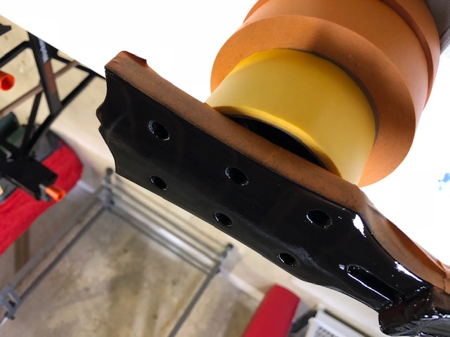

    Headstock Pre Decal
    I am going to take a shot at putting the decal on the headstock. Is covered with four coats of Krylon Acrylic wet sanded tween coats with 1200 grit. I wish I had a dust free room . I made a dry booth for doing my bamboo fishing gear, but this would require a lot more space?

    Five coats of Lowes home store Satin Spray Can Krylon (Color-Max) Black under decal. 1200g wet dry paper, wiped down last coat of paint with warm water prior to setting decal. I have clear Krylon Color-Max to cover the decal. I will need to let this cure for about 24 hours before I attempt the first mist coat over the decal.
