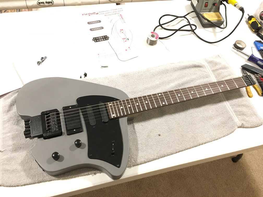

    The aforementioned shielding arrived last Tuesday, courtesy of Amazon. I got that applied to the various cavities Friday evening. I was planning on getting to the soldering on Saturday, but life got in the way. Finally got to it Sunday evening. With everything soldered in place, a couple screws holding the pick guard in place, and the supplied EB Slinkys strung onto it, I plugged it into the Carvin V3M combo ... and it played!

    However, something was seriously wonky with the tone pot. A quick check revealed pilot error on my part, soldering one of the leads to the wrong connector. Having run short on time, and needing to get some sleep, I decided to save that for this evening when I get home from work.
    I mentioned before that I wanted to give the stock bridge a chance, and so I did. As I was tuning it up for the first time, I noticed that the knobs were getting increasingly difficult to turn. A quick look revealed that the nylon (or whatever that material is) spacers between the knobs and the bridge body had torn and were in the process of destroying themselves. Looks like I'll be ordering the J-Custom bridge after all.

    One thing I noted when mounting the bridge is that the hole in the body for the ground wire was drilled right where one of the bridge base mounting screws go. Since it was all but impossible to get the wire soldered onto the bridge base, I left it where it would pinch between the body and the base, and reassured myself that the screw would likely bite into the wire as well. There is ground continuity, so it seems to work for now.
    The action is horrible, and this doesn't look like an easy design to get set up (need to take the whole bridge assembly apart just to raise or lower the posts). I'm sure I'll be tweaking it for a little while until I can get it to play like buttuh.
    It's almost done. Finally.

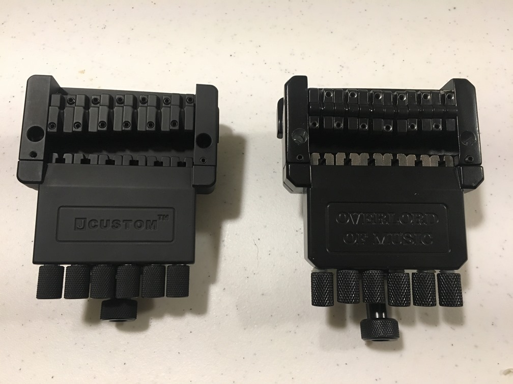

    The J-Custom bridge arrived from HeadlessUSA in yesterday's mail. Got it too late in the evening to do anything, so I'll take off the kit bridge tonight and compare the two. There are some noticeable differences.

    Got the OofM bridge removed last night, and snapped some pics for comparison.
    The finish is the most obvious difference, with the J-Custom being a bit flatter and smoother. This may be a result of a better powder coat process, or maybe a smoother finish to the metal, or maybe both. The corners of the Overlord bridge are angle cut, while the J-C's are radiused. Corners on the J-C tuner mechanism housing were left square. The saddles are different between the two. Not sure which is closer to the original Steinberger. The string hooks on the OofM are unfinished, while the hooks on the J-C are powder coated. Another obvious difference is the fit. The J-C is much tighter. The tuning knobs barely wiggle at all, while the OofM are all loosey-goosey. The J-C has metal washers under the knobs, where the OofM had those aforementioned nylon thingies, and a much wider gap.
    Name:  Headless bridges 1.JPG
    Some differences on the backside include the J-C being sanded to expose a large area for grounding, whereas I had to scrape away finish on the OofM for the ground. The hardware seems more substantial as well. The lock mechanism on the J-C is about twice as thick as the OofM, which seemed to work just fine. The mounting holes lined up perfectly with the existing screw holes from the OofM base. The HeadlessUSA website said that the bridge does not come with mounting hardware, but it did. In fact, it looks to be of better quality than the existing Chinese stuff.

    I dug out the stock head piece as well, and took some pics of it compared to the J-Custom part from HeadlessUSA. The stock part is a clamping style like the Floyd Rose locking nuts, and will only accommodate regular strings. The J-C part is slightly larger (maybe 50%), has a better finish, and is designed to accept either regular or double ball strings. The stock part kind of put me off in that if I have to deal with changing one string, I would have to detune the adjacent string using the same clamp. The J-C part has individual internal clamps for each string.
