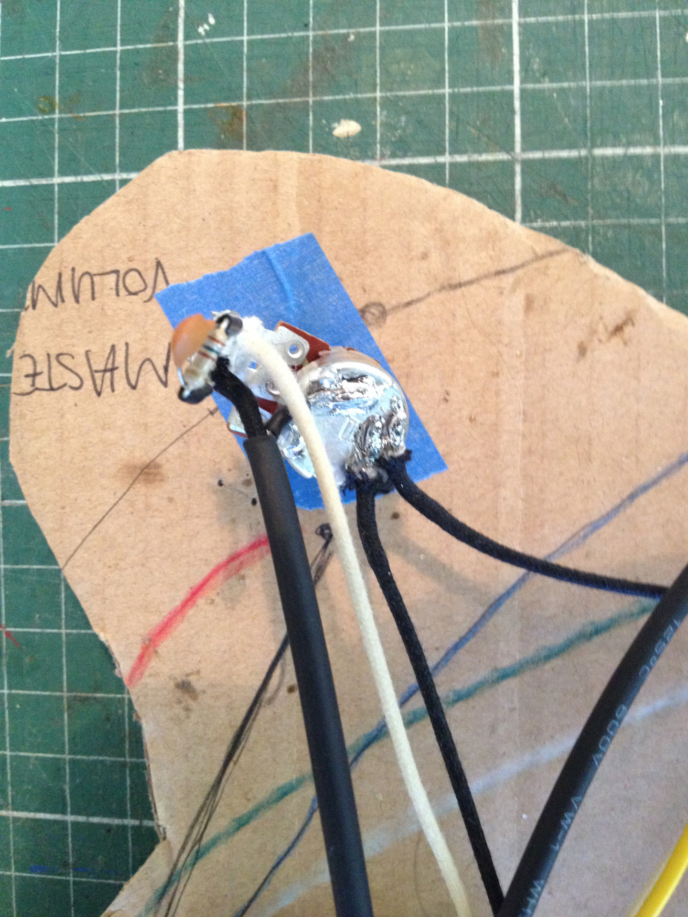

    Wiring GR 1sf

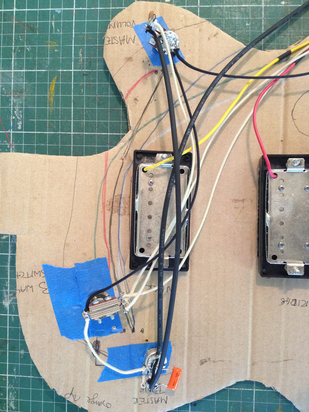

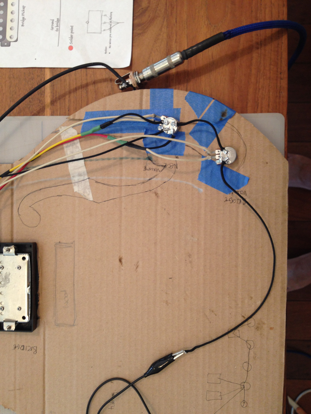

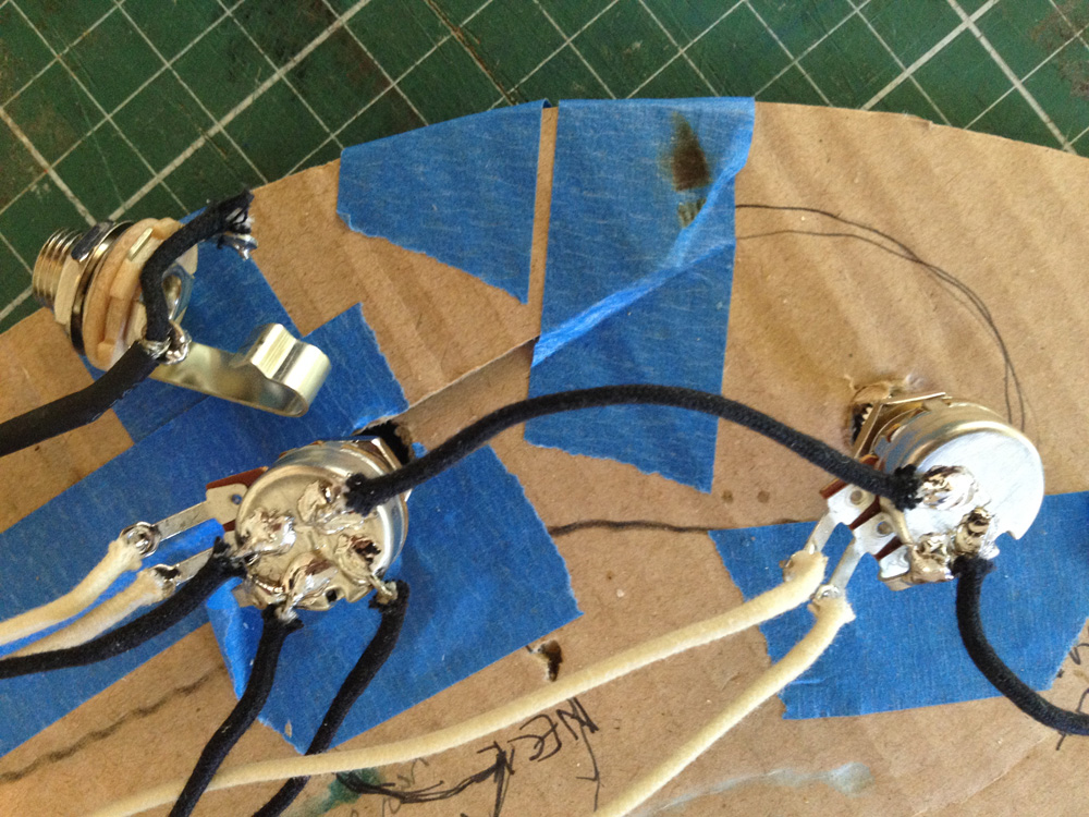

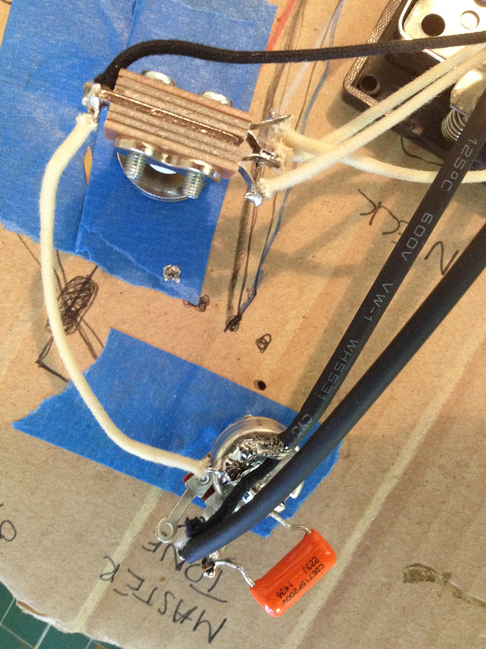

    Here are close ups
ID:	29661Click image for larger version.
ID:	29662Click image for larger version.
ID:	29663Click image for larger version.

    Have you checked the pots have continuity with the meter, and the resistance changes from the centre to outer lug when you turn the pots?

    Whilst it shouldn't really make much difference in such a small circuit, it's worth checking that you haven't created a loop in your ground wiring as this can make hums worse. Breaking any loop might improve matters slightly. For instance, the white link between the toggle switch ground tab and the back of the master tone pot seems to form a ground loop. It looks like you were trying to achieve this from the diagram you sketched on your template, but you may have then added to it trying to kill the hum.
    But I'd be tempted to ditch the cloth covered wire and use screened cable instead. The runs between pots are quite long, so the wires can pick up a reasonable amount of noise.
    You can use the screen of single core screened cable to act as a ground between pots, but if you have several screened cables running to one device (such as the pickup selector switch), then only connect one of them to the ground connection (I normally use the output wire) and only have the screen connected to ground at one end for the others. The braid acts as a better screen if it han't got current running along it.
    The fact that you still have hum when both volume knobs are set to zero tells me that something's not right with the wiring or maybe the pots are damaged. When both pots are at 0, all the signal wires should be connected directly to ground, which should kill any noise. So with both of the pickup volume pots set to 0 and the master volume set to 10, I'd try measuring the resistance between the input and output lugs, the resistance between the output lug and ground and the resistance between the input lug and ground. All three readings should be as close to zero ohms as the meter will read. Do this with the selector switch set for the pickup volume pot you are testing to avoid the other pickup/pot affecting the reading.
    Also, have you got any major sources of electrical noise nearby? Fluorescent lights and dimmer switches are always bad for generating noise and the wiring can only pick up radiated noise that is around, it won't generate any. Try turning off anything that isn't essential in the room and see if the noise reduces.

    I doubt its the pick ups at all. just check the resistance of them with your multimeter. I assume that you haven't got the ground and hot wires mixed around in one or both pickups? That wouldn't cause a grounding issue but it would cause some hum.
    It looks like there only one wire going to the jack? or is there two encased in heatshrink? If so, that would mean you have the earth wire running from the master tone to the jack instead of the earth coming bridge volume pot. I suppose it shouldn't matter (if everything is grounded well) but do you have complete earth continuity between the ground lug on the jack and the back of each pot and the earth lug on the switch?
    The solder joint on the earth lug on the bridge volume pot could be a little bit better. It may be fine now but could cause problems down the track in a hollowbody.

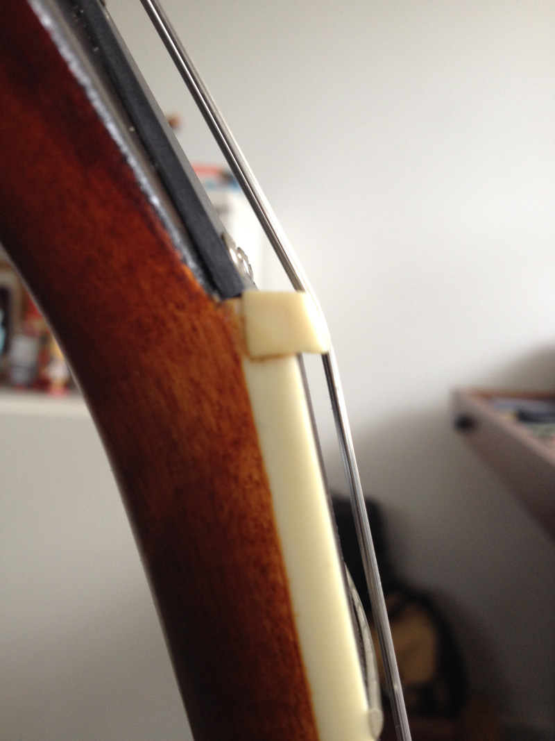

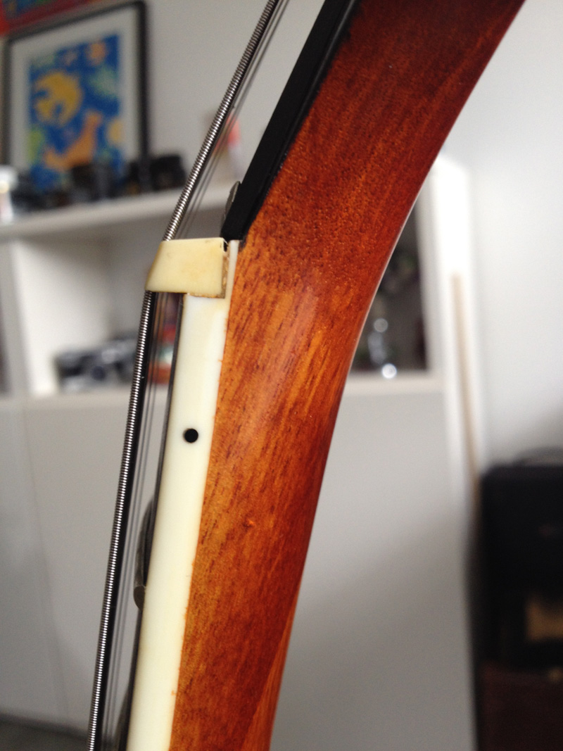

    I have a new problem. Everything is together, I made a custom made pickguard, neck glued in and strings on.
    It sounds horrible! I think problem is the nut is way too high. Open chords are out of tune. It is much higher than both my other guitars.
    So the action at the 1st fret is over 1.5mm on high e and 2mm on bass E. See pics.
    Looks like it's glued in wrong. What do you think?

    Hi Paolo,
    Looking at it, there’s a couple of things I’d verify.
    You might be right about ithe nut being mounted wrong. It may just be photo angle, but it seems to me the nut isn’t sitting at 90 degrees to the fretboard. It looks to me like it may be canted forward a tad. Or it could just be the photos.
    the rule of thumb I’ve worked to is that you should be about 1/32” (.8ish mm) above the first on your low E and 1/64” on your high e. This is based on what I’ve read in relation to strats and Strat style guitars. I’d imagine that should translate to g style nuts as well? I stand to be corrected on that score by someone that actually knows something 😜
    the other thing is how is your intonation?
