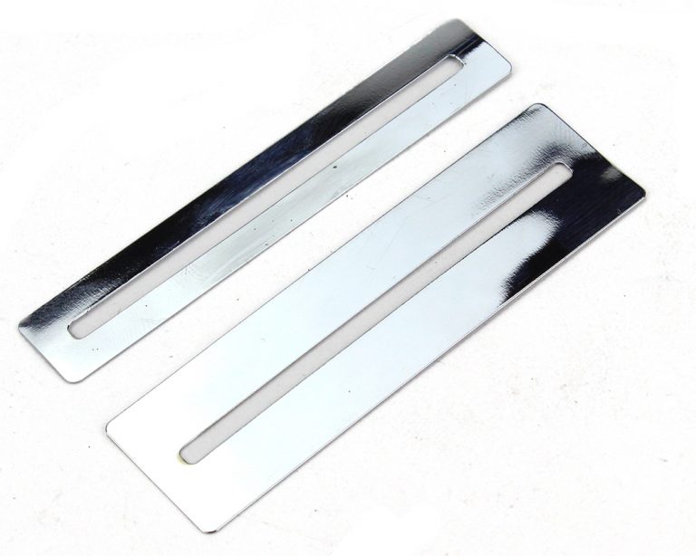

  3. #23
    You will need something like this which can be found in PBG store or on eBay too....https://www.pitbullguitars.com/shop/...ctors-2-piece/
    Or if feeling cheap and resourceful you could make your own from some scrap plastic - ice cream container lids or maybe take away food (chinese or indian) container lids. They only need to be wide enough to protect fret board when using 0000 steel wool to polish the frets, or in this case, removing TO from the frets whilst polishing. This is the only job that I will do using steel wool as it is nasty stuff that breaks down into very fine particles....has a habit of finding it's way into places where it is unwanted, think finish, pickups, electrical parts. Best to do neck whilst unattached to body and have a strong mah=gnet on hand to sweep over everything, including workspace to pick up the stray steel wool fibres.
  4. #24
    Got it. I've actually already have a pair of those laying around the house (came with some other tools I got from ebay long ago).
