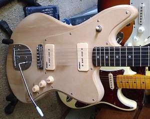

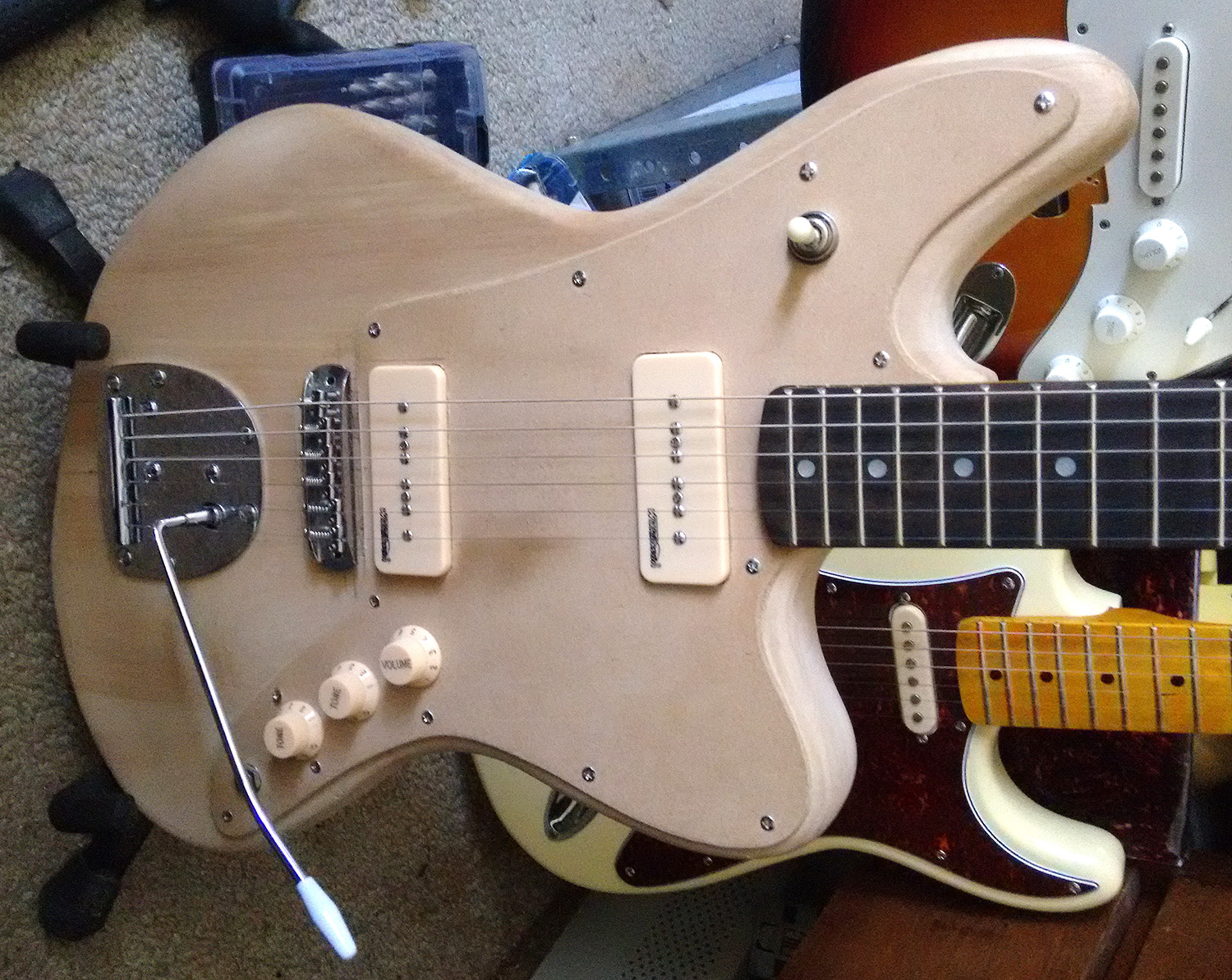

    I get it all assembled and playing. Making all the adjustments to the neck/frets etc...
    Only then will I disassemble the whole thing and set about the sanding/filling/painting/staining.
    Knowing that it will all go together with no problems.
    I'm sure you will read some build threads (mine for starters) where a few backward steps came into play.
    edit:
    Here's my current build. It' been a couple of weeks in limbo whilst I get some playing adjustments done.
    The MDF pickguard has picked up plenty of finger fudge whilst putting some mileage on the frets.
    Once I'm happy with that, it will be disassembled and the sanding/priming/painting stage will commence.
    cheers, Mark.
