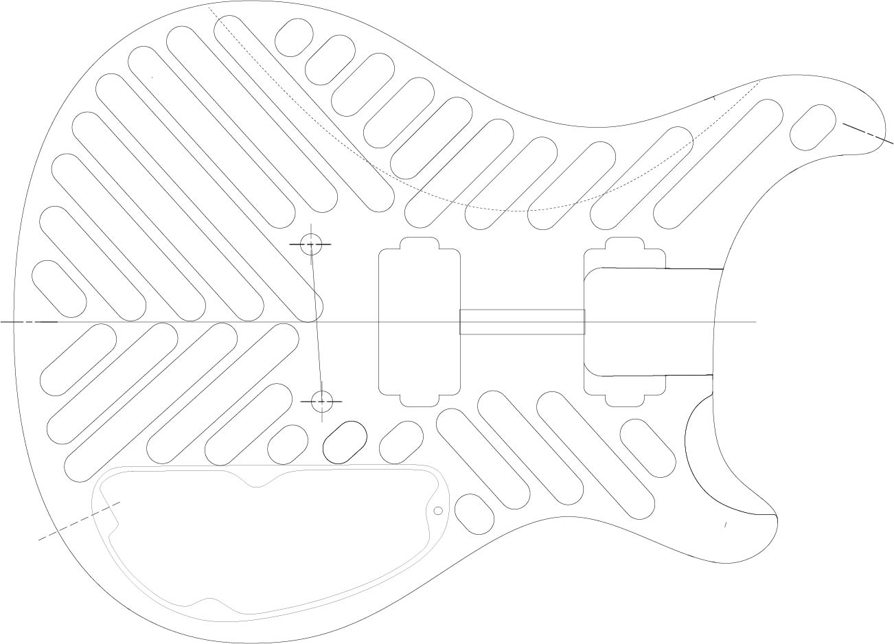

    Well life gets in the way of guitar building. I haven't touched anything in a meaningful way lately so there are a few projects hanging. (I hear the collective gasps of shock from you all, sadly it's true.)
    The most work i've done is getting the chambering plan sorted out for this thing
    As with all the FrankenLab builds the final execution may in no way reflect the plan, but we'll live in hope !
    There is still some levelling of the body blank to do, as well as actually getting these templates cut, but slowly slowly we shall get things moving.

    It's going to be light as a feather. Do you think neck dive will be an issue?

    Quote Originally Posted by TZK321 View Post
    It might be TK, I was thinking of ways to lighten the headstock as well, potentially some lighter tuners and through holes. Perhaps a slightly off set rear strap button etc. The body blank is some fairly weighty African Mahogany, it will be getting a 12mm Blackwood top (or zebrano) which might offset tings a bit

    Plan looks good. Just wondering if there's any benefits in chambering versus going hollow / semi-hollow. I know there's a semi-hollow Les Paul without f-holes. Not sure what sort of chambering or hollow pattern they use.

    Well that wasn't hard to find....
    https://espanol.gibson.com/News-Life...ht-Relief.aspx

    Quote Originally Posted by kuanjb View Post
    Sent from my LG-H930 using Tapatalk
    Thanks for that KuanJB, I'd not seen that, nor heard the G rationale behind their systems.
    It raises some questions about what I've designed above, and i think i might go back to the drawing board and rework it somewhat.
    I'm thinking:
    - Pull back from the Post mounting locations for safety's sake
    - Reduce chamber number, but increase size, currently drawn as 5/8" might go up to 3/4" or 7/8" (15.8mm, 19mm and 22.2mm for the non imperial speakers)
    - Rework the control cavity to reduce in size/match the lower bout curve.
