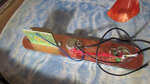

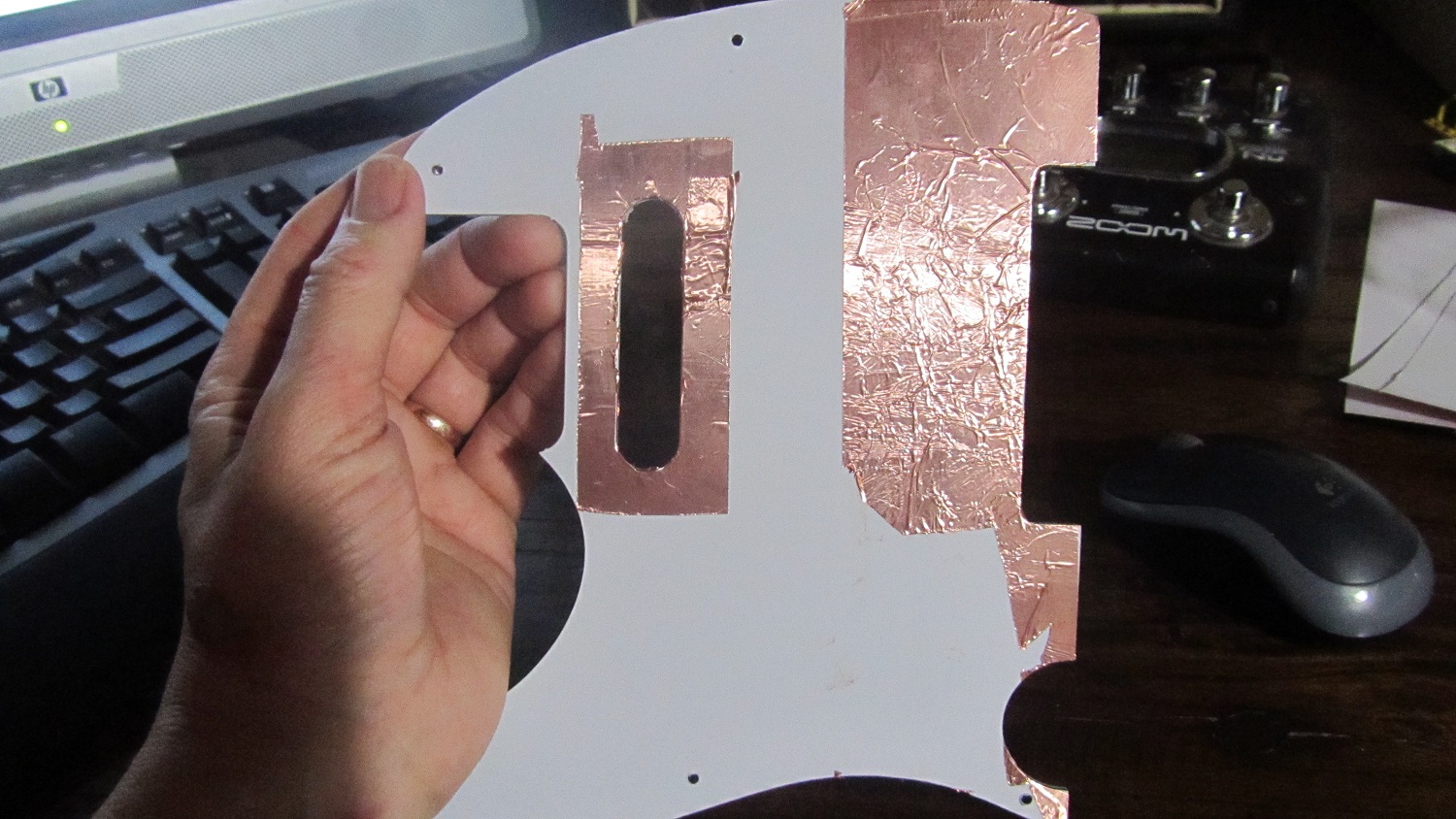

    Copper Shielding.
    I have started to copper shield the Pick Guard laid the first strip on right then realised its a Tele Plate so only sheild the pick up area....The Strat plate needs full shielding...Why sheild, it cuts down on RF interference, Radio Interference. Which can make pickups feedback in wantedly. The control plate route areas all will be shielded. I got the shield vis Dingo....Want a cheap option use superglue and Alluminium foil,,, But for $6 bucks a great investment versus say $3 for Al foil.Click image for larger version.

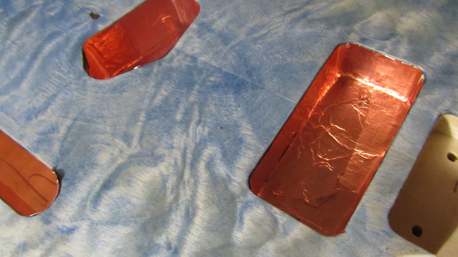

    Moved on to the shielding the pick up routes and also started the Bondi Blue stain.

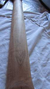

    While waiting for the body to cure, using Dingo Blue, got to work on the neck stain...What stain did I use??
    You have ideas before you start then they go out the window, decided on natural looking neck, accoustic stlye, Neck had nice grain and is mahogany was inspired by what Gibson do, plus have seen others use shoe polish , its cheap contains Canaubra Wax and its Different.

  6. #26
    5,666
    It's certainly come up well, did you apply with the shoe brush or by sponging/ragging it on? (not actually trying to be funny, just curious)
    FrankenLab
  7. #27
    shoe polish never heard of that trick HB, it has come up nicely on the mahogany !
  8. #28
    the blue looks nice, and will and shoe polish to my trips and tricks folder...

    Just used a rag and rubbed it in,
