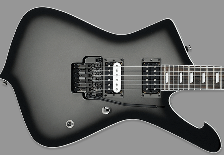

    Sorry to hijack the thread a little, but in addition to the clear coat questions around finishing my Tele headstock, i have just ordered a PBG IC-1 and looking for some advice on how to achieve the following colour...open to staining or painting :-)
    I'm planning on putting decal graphics over the body and hence wanting to contrast the black lines of the prints with the grey background.
    Any thoughts?
    I'm assuming a grey spray paint would be the best option (black for the burst obviously hehe) but looking for a grey that has flecks of dark grey to give the effect seen in the pic if thats even possible.

    Yeh paint. is the grain of the timber is interesting, rather tha a a solid grey, you could shoot some black candy which would give you a see through grey, then you could do a solid black burst with spray gun or air brush. Looking at the pic you will also have to scrape the binding after ... that I'm guessing will be a pain.
  9. #29
    Not sure on the grain yet, just ordered last night :-)
    So you would spray the black candy over a solid grey? or over a grey primer?
    The IC-1 doesn't have a binding so phew! It was time consuming (but worth it) when i did that on my PBG Tele.
    I don't have a spray gun or air brush so looking at how to do a thin burst with spray cans (not the wisest choice but....)

    Quote Originally Posted by a_novice View Post
    Um... no.... if the body has nice grain then a coat of clear sealer over the timber, then sand smooth, thblack candy over the sealer. primer or grey paint will just hide th grain. Black candy *instead* of grey primer/paint will still give you a grey unless you put too many coats on, but show off the grain if it has a nice flame to the top , it would be a shame to completely hide it. Think of it as a tint . or you could use a grey stain if you can find it. If the grain turns out to be boring then go with primer /paint. As for the burst, you can do it with a rattle can.... the big manufacturers use a full sized gun to do bursts, I'm more inclined to use an air brush, but if you don't have that as an option, the can will do.
