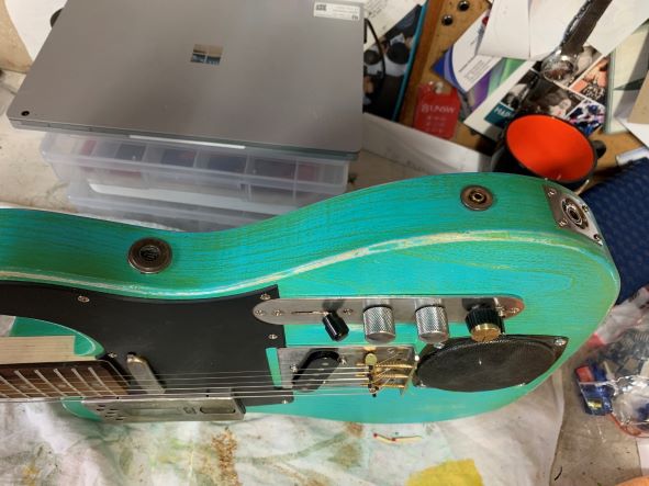

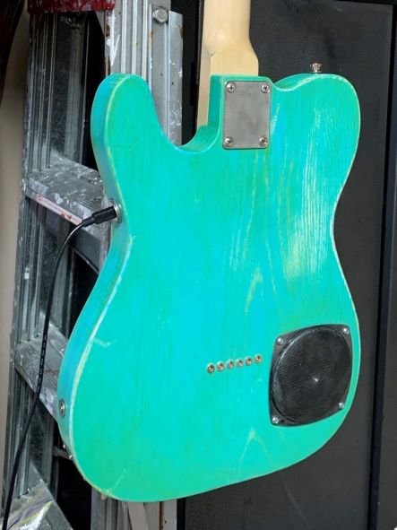

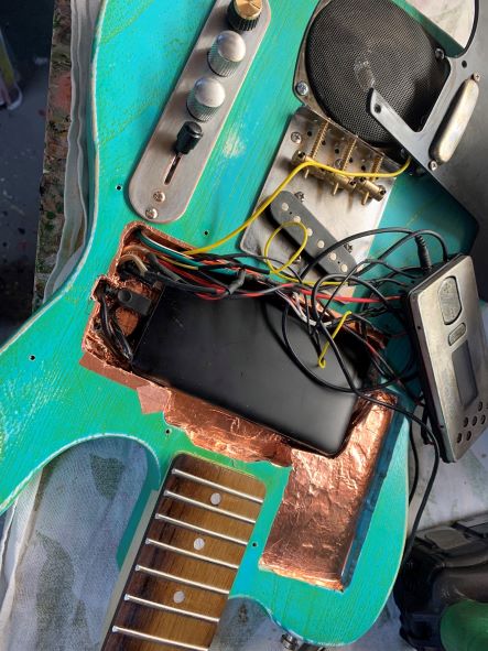

    The building is done! fitted the bone nut and the through body ferrules, as well as the charge port for the 5V mini-usb cable. I had to shim the neck a little as the bridge was at the lowest point to get a reasonable action with the neck straight, I used a thin slice of plastic from a blister pack. I also needed to tweak the bridge over to one side a little to centre the strings, only 0.5mm or so but enough to notice. operator error here!
Name:	finishing wiring.jpg
    It all managed to be squirreled away without any extra holes in the front or back which I wanted.
    I tidied up the ports for the USB charge and 3.5mm input jacks by JB weld stainless washers around the holes I had cut, I think it looks tidy enough:

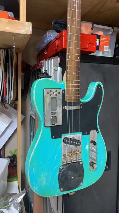

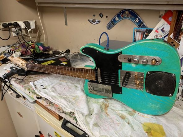

    So it's all together. Deliberately it's a mash of bits, there's some gold hardware and some reliced chrome. For some reason I have kept the neck and headstock all new looking. It has been nice to not be so serious in keeping everything perfect or trying to get a super realistic relic job on it all:

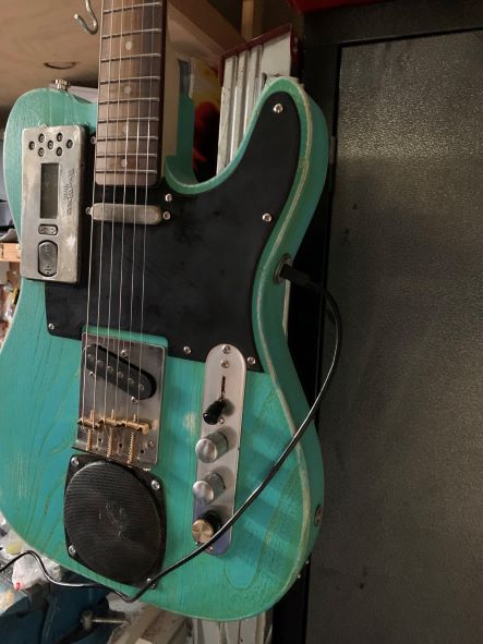

    First full charge of the battery:
    As the battery is hidden in the body I can't see the LED display showing the charge level, but it had been on for a couple of hours during testing and it was still showing full charge when I was finalising the wiring, so that's good news.
