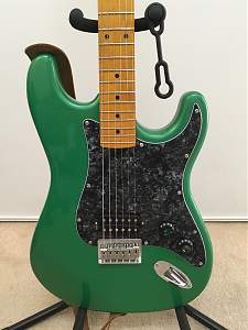

    Well, not much to see, but I finally got around to doing the 1 humbucker strat project the other day.
    I put in a Tonerider AC II (F-spaced) and it sounds fantastic. I also opted to put in a tone control and glad I did.
    This is my first single pickup guitar and I'm having a blast getting a range of tonal variety just by using the tone control and my fingers. I know that's not unusual with any guitar, but having only the one pickup really makes me think more about how I'm playing and creating the sound.
    This is definitely a Rock Machine:

    Cool.
    Have you wired the tone control in the modern or vintage style?
    60's style.
  7. #27
    So wired to the volume pot input rather than the output. I'd have thought you'd have gone for the more interactive LP Jr style.
  8. #28
    TBH, it's still a work in progress and I'm thinking about trying the 50's style. It's easy enough to swap, and I can get the pickguard off without completely removing the strings.
    I've not tried it before and not sure how I feel about the tone pot also affecting volume. So I went 60's to start with.
    I used 2 log pots and a .033uf tone cap and like the way it feels atm, but open to experimenting.
    I've got myself into a bit of a pickle by having 4 guitars undergoing various mods all at once, so I'll play this one as it is then revisit.
