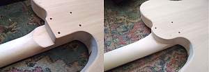

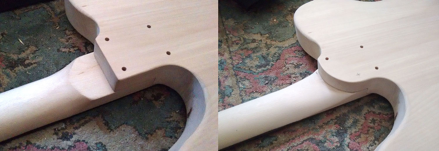

  7. #27
    Some extensive modding done so far.
    May as well do the neck mod whilst you're at it.
    cheers, Mark.
  8. #28
    Mentor dozymuppet's Avatar
    Jun 2020
    842
    Definitely for a future project. But for this one, I'm pretty happy with the neck as is.

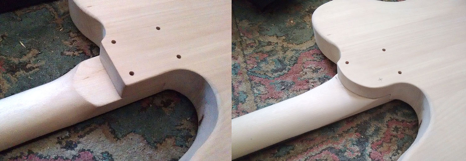

  9. #29
    cheers, Mark.
    Probably not a bad call anyway. I'd be fairly confident that Artist used a tinted 2-pack poly (-urethane or -ester) and it would be a difficult job to match and repair any finish you took off the heel.
