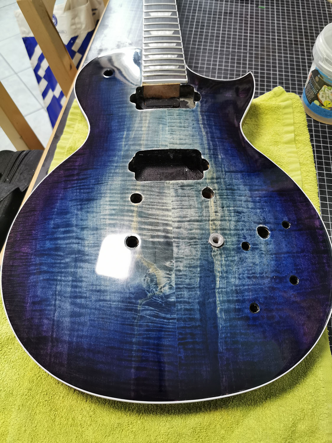

    I know I actually wanted to wait, but it kept looking at me.
    It's pretty glossy. Not a perfect factory finish, but I'm good with it for now.
    Man, this thing was a real b*tch. Thanks everybody for your help here (and on all the other threads ). Excited to finish it, but my headstock decal stuff is not here yet.
    Looks really nice. But you can still give it another polish in a couple of weeks if you want, and get it looking even better.
