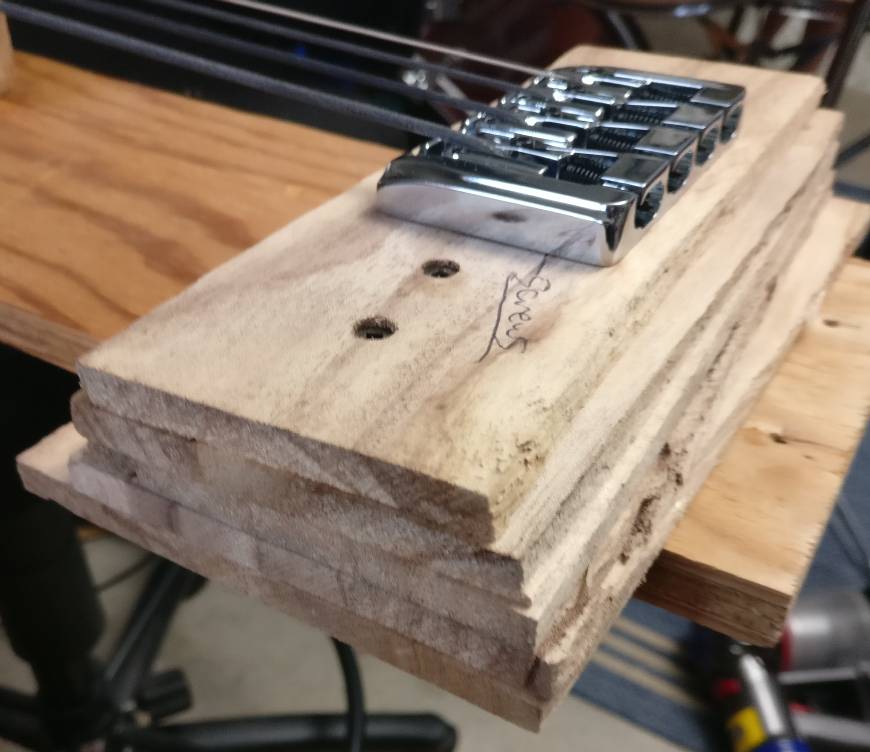

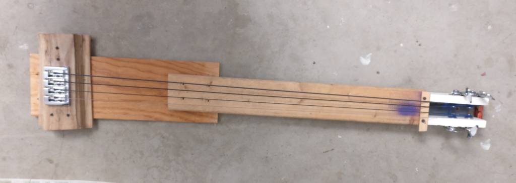

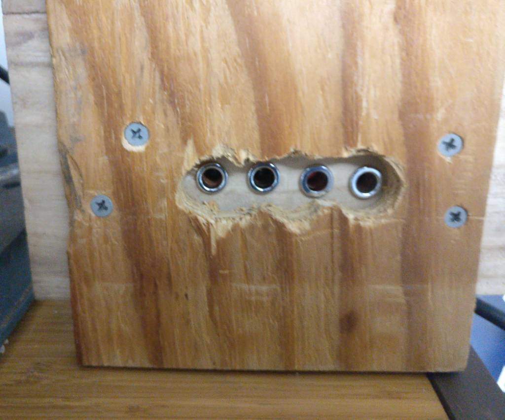

    2,948
    Made another ugly jig, this time to test the melding of bridge to body. I stacked 5 paulownia TKD boards to replicate the thickness of a bass body. I just screwed them together so there is no glue or finish in the wood to harden it and skew the results.
    Screws went in just like any other wood. Used my normal non-stripping protocol. Tighten until the screw stops using index finger and thumb on a standard sized screwdriver.
    Made an unattractive hole for the string through ferrules, and attached the paulownia and bridge to the jig.
    Strung it with a mismatched set of old bass strings. Sting length is 34". Turned it three half steps high to increase string tension. Tugged on it a bit. Will pick away at it over the next few days, and leave it strung.
    No issues so far. Bridge seems solid. Ferrules nicely seated without trying to pull in too deeply.
    So far, so good.
