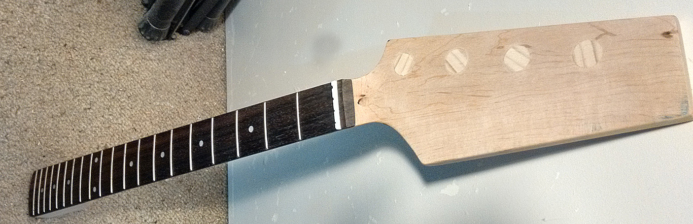

    The rosewood fretboard would probably look better but I would rather not tackle another engineered rosewood board.
    Could just stipulate as such at the order stage?
    FWIW I got a Pitbull 30" rosewood bass neck some time ago.
    I plugged up the tuner holes as I was contemplating making it either a baritone guitar or smaller bass tuners.
    cheers, Mark.
