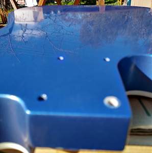

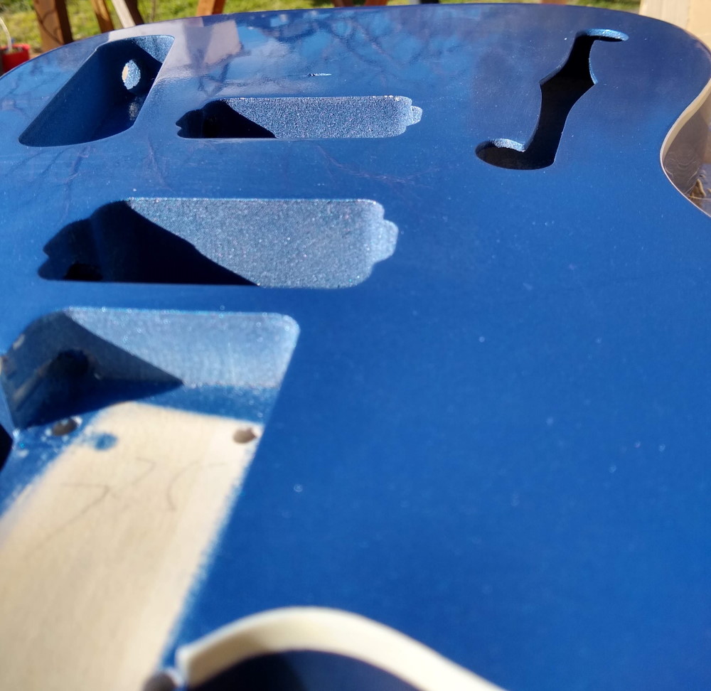

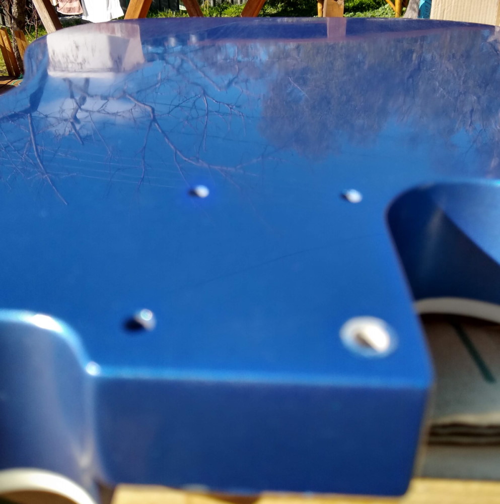

    Polishing the well-cured finish in progress. Still quite a way to go, but so far so good.
    In sunlight there is still some orange peel remnants visible, mainly on the front. But it seems confined to areas that will be under the pickguard so I might leave it alone rather than risk sand-through.
    Also, metallic paint seems hard to capture well in photos. IRL there is quite a lot more sparkle going on here.

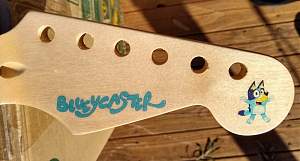

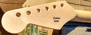

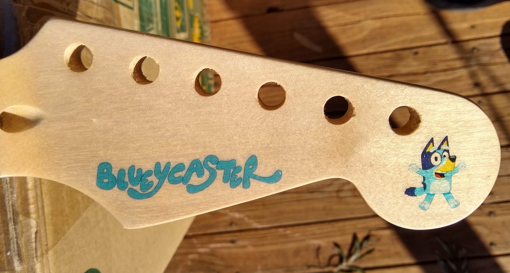

    Neck is pretty much done except for fret polish. I will leave that until almost last as I am sure to scratch them. There is some bubbling of the decal on Bluey which is dissappointing but there is nothing I can do about it. The decals have bedded in nicely though.

    It's getting there. With a bright light at a low glancing angle I can still see plenty of marks and fine scratches that need work. I am less than halfway through the micromesh grades though, and will follow that with cutting compound. I am experimenting with micromesh as an alternative to wet sanding. So far so good.
